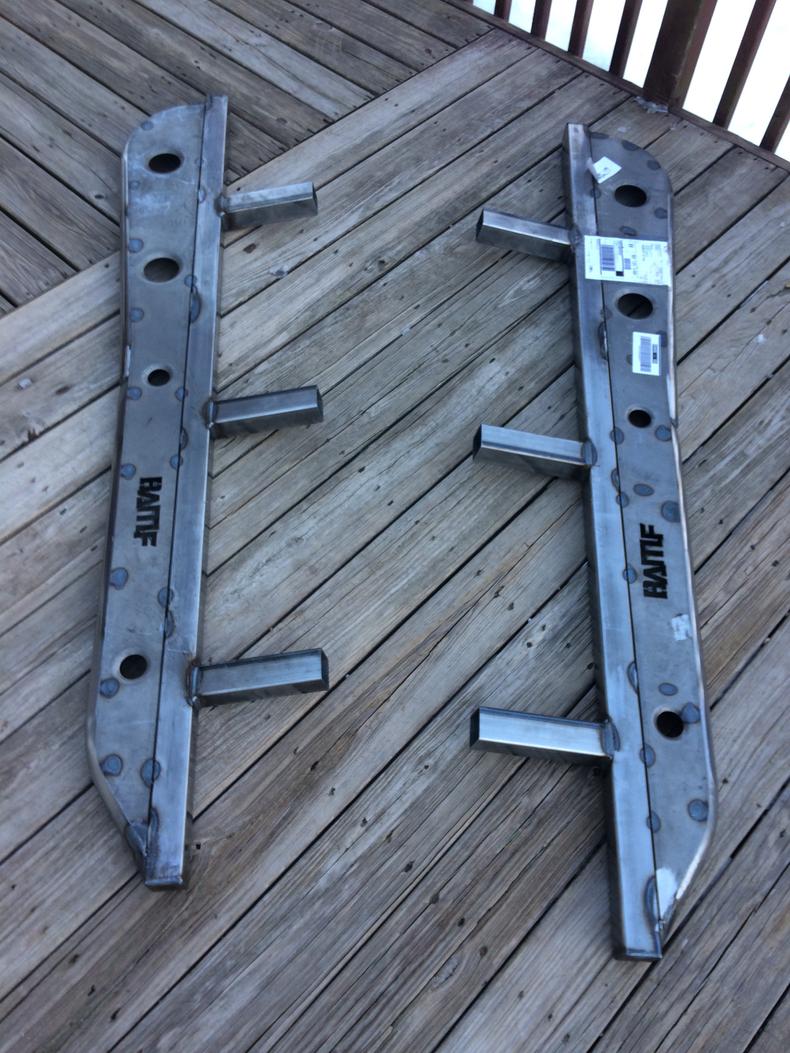

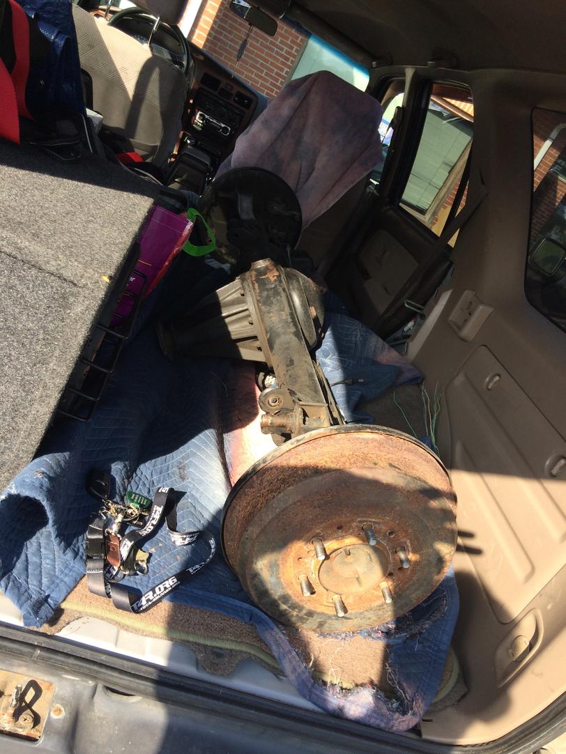

Yea, I cant wait. I saw them sitting in the basement this weekend! I have to do my axle swap first because my current diff is leaking from the gasket & I haven't been driving her. I'm thinking about putting her up on jack stands & ripping her apart until my "to do list" is done. That would probably take me all summer because I'm lazy! LOL
