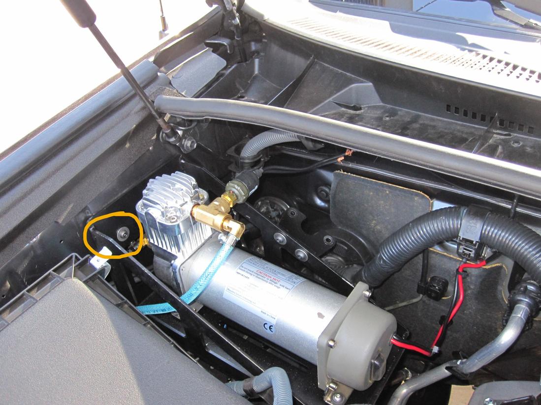

There are some screw holes inside the engine compartment on the fenders. Quick look shows three on each side, maybe more. Does anybody know their size? Metric I assume.
Are you referring to the threaded holes on the driver's side or passenger side. The drivers side are indeed M8, the passenger side is definitely M6 - these are what I used to secure my air compressor mount as outlined in orange in the pic. Either way, sounds like you found the right one!

Upon Further Review......Driver side = M8 and Passenger side = M6. Thanks!
