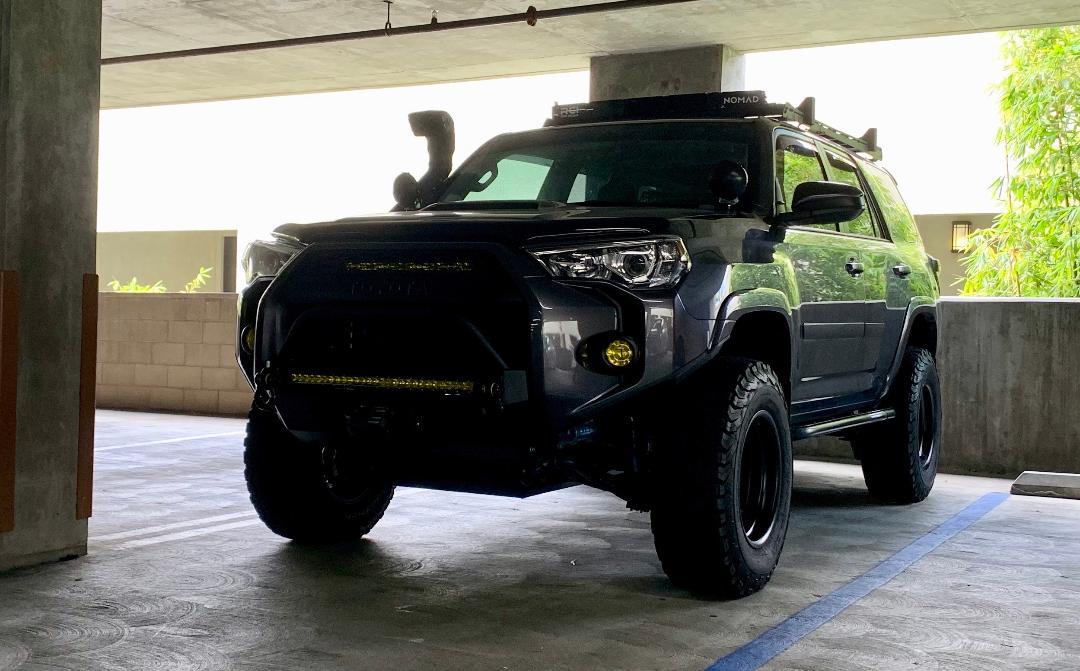

17x9 -38 is the best offset IMO. Looks meaty and widens the rig up nicely. I'm running 295/70 KM3

Thank you for the info your rig looks BADASS love that offset/tire size [emoji1305]
