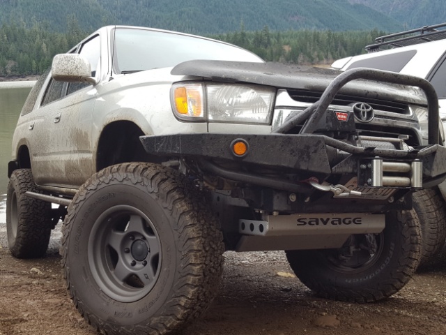

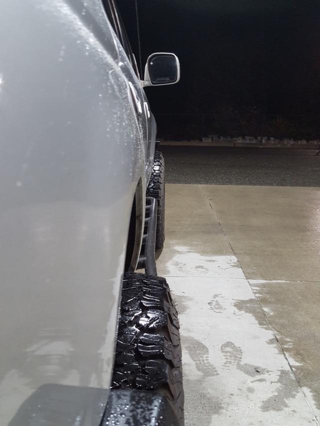

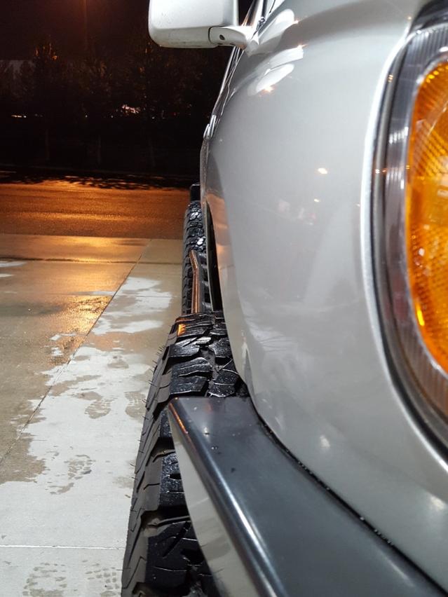

I have 3.5" BS and 285/75/16 KO2's. I have SPC Light racing UCA's set to G with no rubbing and no BL. YMMV. I have no fender flares. With a little work, they fit fine and are one of the few offsets that are desired to clear larger 315/75/16.
Here are a few pics of my 3.5 F5's

Beautiful rig man!!
And thanks for the pics!
I have the stock front bumper tho, will the be a problem?

Thank you. Hard to say about the stock front bumper, as I already had the AOR bumper before the F5's. You might need to trim the lower plastic valance, but I am not sure. You gave yourself a little more clearance with the BL.
I had my wheels pulled pretty far forward with my alignment and my front bumper has a lot of clearance.

I already had my SPC UCA's when I got my F5's installed. But I would think that you'd be fine, given that you are moving the wheels out, towards the edge of the vehicle, and away from the UCA's. The SPC's might not be needed, but they are nice for fitment. I have really only folded over my pinchwelds and did the rest with setting the the UCA's to reposition the wheels in the wheel well.
