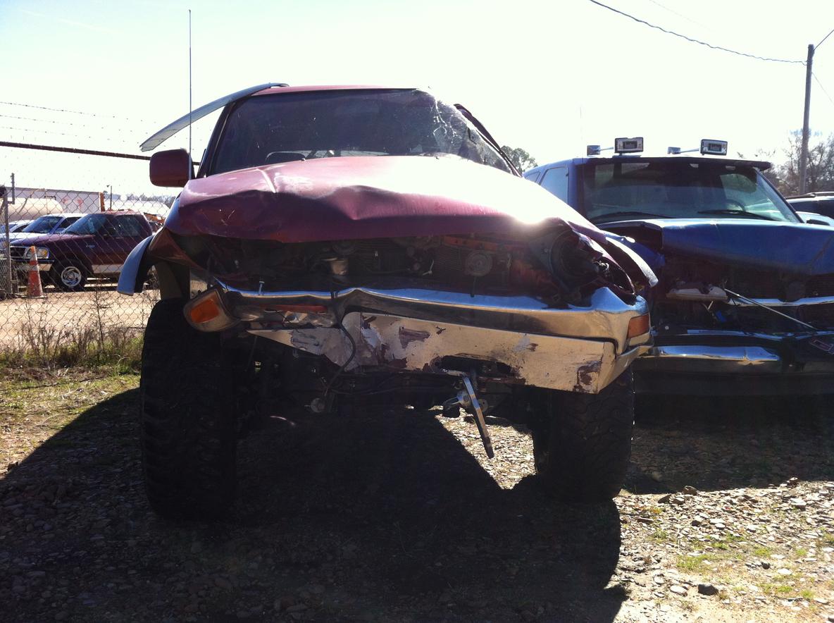

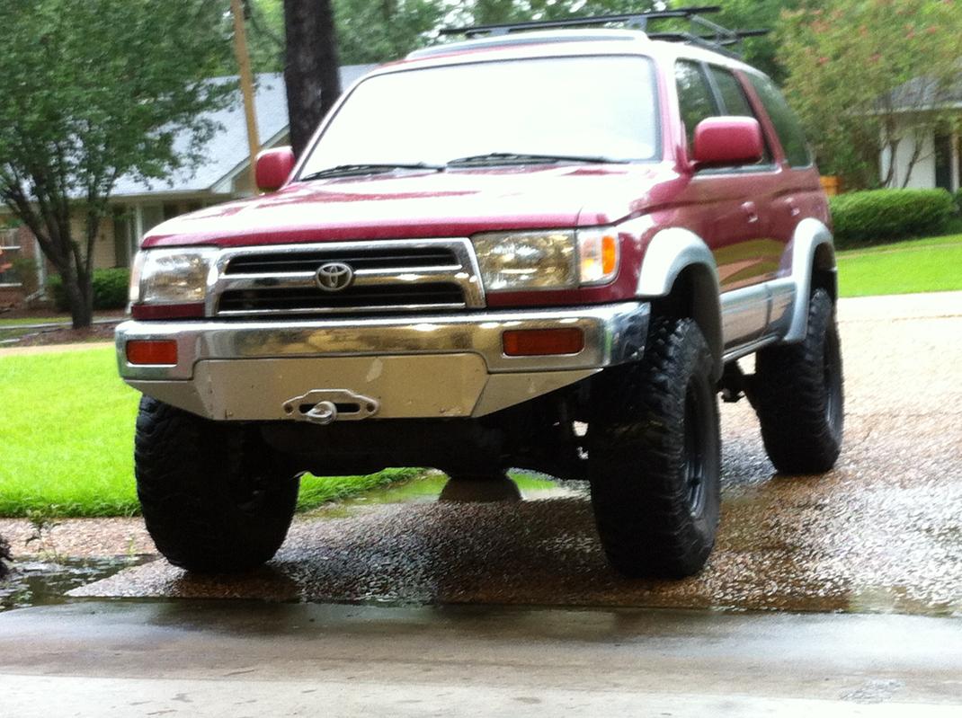

A good one and not so good Lol. [MENTION=157204]Pro408[/MENTION]
Ouch !
Was that before and after? Or .. lol
Good 8-7-17
Not so 2-8-18
6 months after I gave it to my son, wasn't his fault though.
Someone cut into RF wheel, 75 mph head on into concrete divider then onto roof
Slid for ways. Seatbelt airbag both worked, six stitches for inch long cut top of head. I was thoroughly impressed with how runner passenger area kept it's shape. VC's were touching firewall.

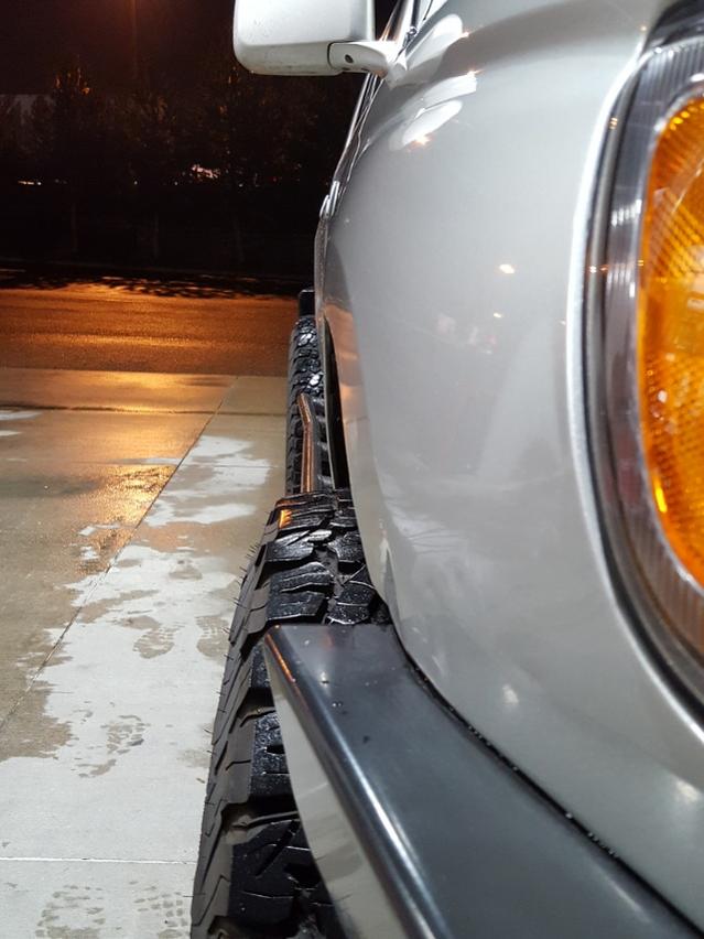

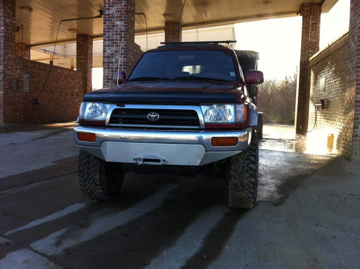

Here are a few pics of my 3.5 F5's

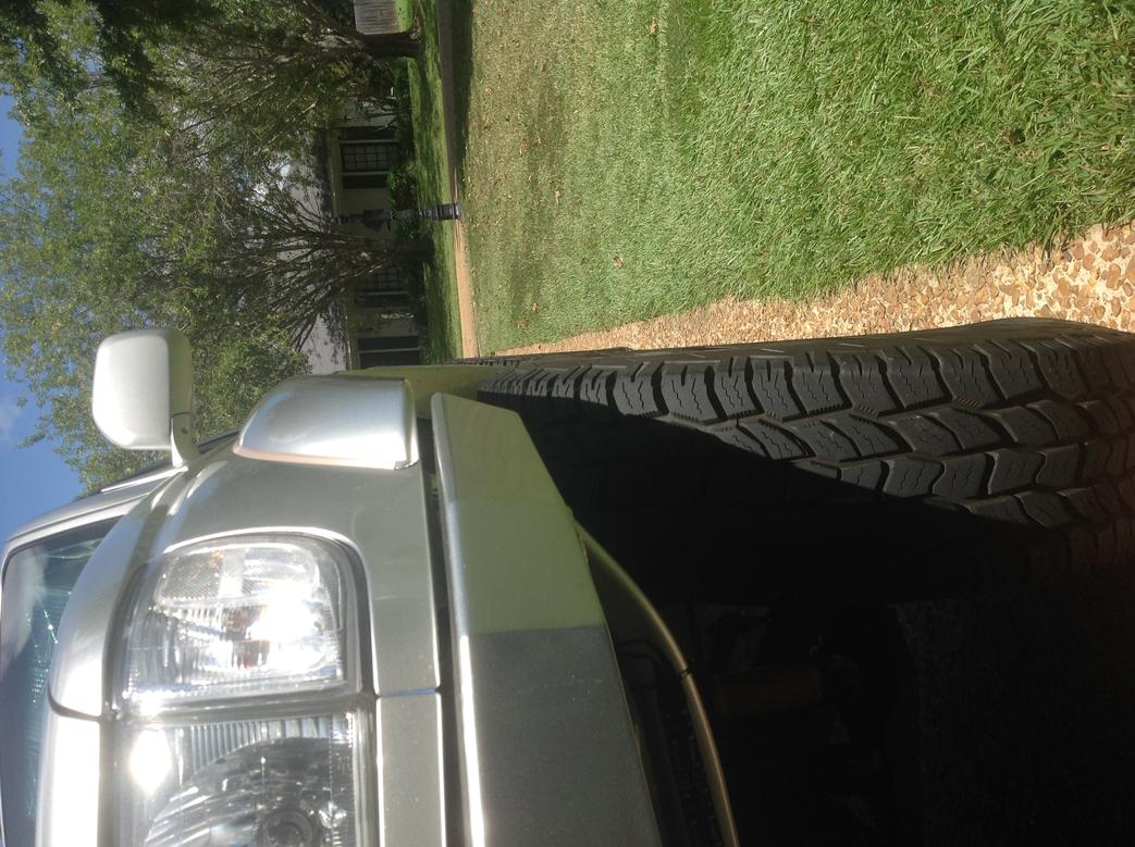

Ay Road Bull, you and I have same bumper I'm interested in getting 5 Stars same BS as yours. If not too much trouble could you measure from tip of bumper with face of tire, say put straight edge across tire measure to tip.
Trying to get idea of where 285 will be with flares.
Still getting hang of posting pics.
265/75-16's OE coke bottle rims 1.25" spacers what your looking at.
Currently, my vehicle is in the shop getting some gears and locker. I should have it back by the end of the week. I'd be happy to do it when I get it back in my hot little hands. lol. But just eyeballing it, I would say that it is probably just beyond your flares. But not too much.
[MENTION=119532]Road Bull[/MENTION], that pic tells me what I needed, Thanks. Good lookin ride.
Thanks man. Best I could manage under the circumstances.

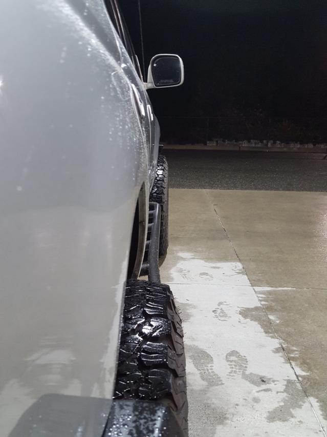

Oh.. and here are a couple more for anyone else to use as reference for F5's in 16x8" with 3.5" BS.

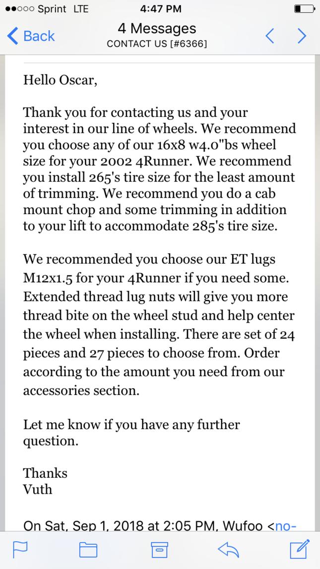

I emailed them and this is what they replied ..
Interesting. I wonder if they are getting our 3rd gens mixed up with 4th gens concerning the Body Mount Chop. I have not heard of anyone having to do this for 3rd gens. The 16x8" 3.5" BS will rub more than 4.5" BS for sure, but it just means that you will need to address the rub a bit more aggressively. I am sure that SCS suggests rather conservative specs, the 265/75/16's and the 4" BS to avoid a lot of angry phone calls and emails saying that their new set up rubs.
The fact of the matter is, when you make changes, especially bigger changes to the geometry and size of the objects that roll under our vehicles, you will have to accommodate those changes one way or another. Some people run body lifts, some add aftermarket UCA's, and others just grab a hammer and start pounding the be·je·sus out of whatever's in the way. If you know that going into your decision, you will be going forward with eyes wide open. Mine rubbed like crazy till I adjusted the SPC UCA's all the way forward. Since then, no rubbing. Also, BFG's run a bit small, but I figure most 285's would clear just fine.
Exactly what I was thinking because I actually googled it and tried to research what he said and nothing came up with the 3rd gen. I'm willing to do a bit of trimming if I have to. I did it with my stock bumper lol. Plus having the body lift and camburg UCA, I'm sure that will help.
