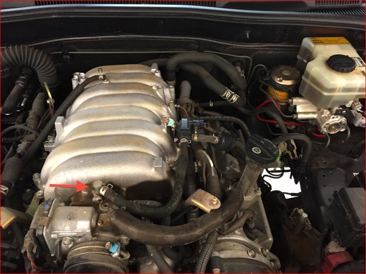

I am planning on seafoaming my vacuum lines today as well as cleaning the MAF sensor.
I just want to make sure I have the right line before I run sea foam through it.
Thank you for your time!

In your attached picture, front most hose in the center of the block.

Is this the right one?
Looks/ feels like air is being sucked into the block
that is the one. was on my phone earlier and couldn't make an arrow on the pic.
That's the right one... Pull black cap off, vacuum line with hose clamp if necessary, stick hose into seafoam, rev engine and go... Don't let it stall, just dip the hose in then remove...
