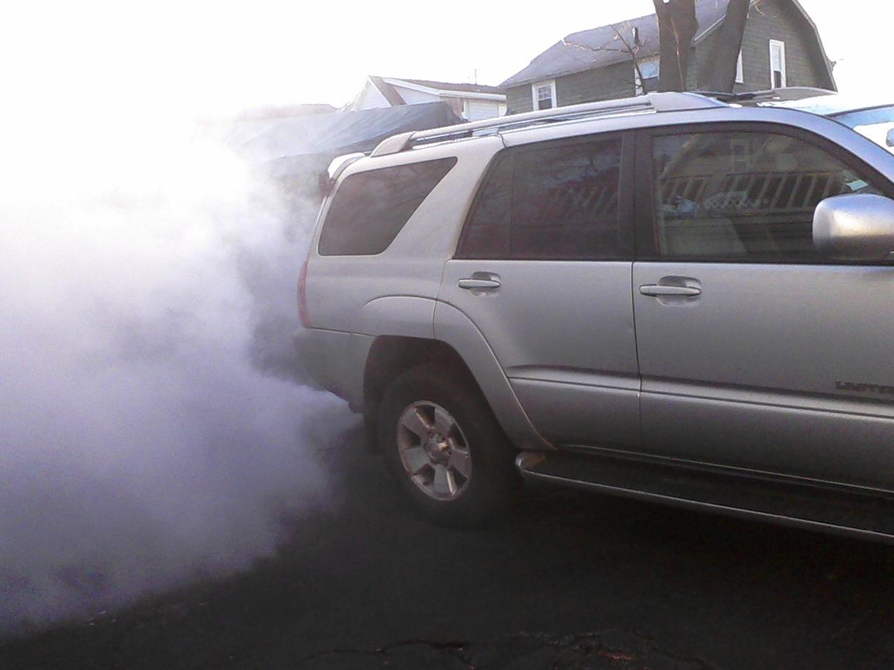

Seafoam'd the 4Runner
Just did this on my '06 V6 with 140K miles. I doubt the previous owner had any type of fuel service done before because the plumes of smoke kept coming for over 5 minutes straight. I also added 1/2 the bottle to my 1/2 full gas tank. She definitely seemed to be running better...well, until the MAF sensor coincidentally happened to bite the dust later that day (engine codes p0171 and p0174 - fuel system too lean on bank 1 and bank 2 respectively). I Googled the codes and found out that both these codes together point to a dirty/faulty MAF. The symptoms were just as the thread described, very rough idle and would try to stall at stops. Perhaps this was directly related to Sea Foam-ing the top end though the vacuum line and possibly getting some crud on the heated wires.

Just used Seafoam in my 2007 V6 4Runner and think the results were consistent with the car's history. It has just shy of 74,000 miles on it and the previous owner drove it like a grandma and had it serviced very regularly. After adding about 1/2 can to the gas tank, 1/2 can to the oil/crankcase and another 1/2 can to the vacuum line I got a good about of white smoke that filled up my driveway. The smoke in my case went away after about 3-4 min. Half that time was spent revving it to 3000, then 4000, then 5000 and then holding it steady at around 3000-3500. I followed that up with a "spirited" 10 minute drive and by the time I got home there was no smoke left. We'll see what the results are like this weekend when I make a drive across the country in it. No CEL or other issues.
