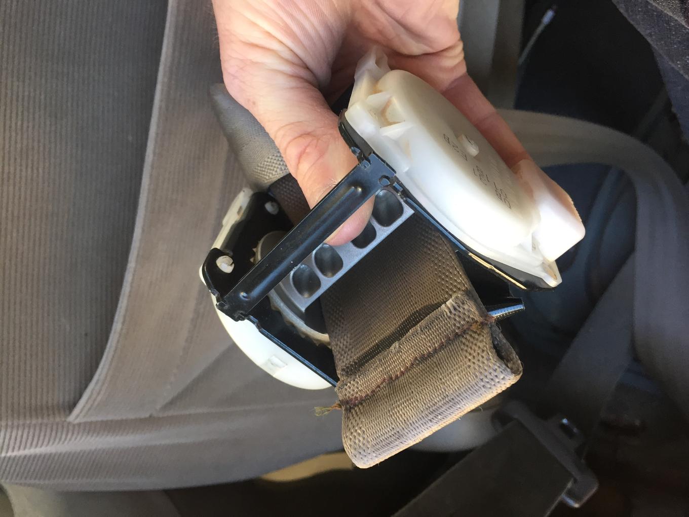

After some disassembly...
Hey guys,
I took the belt tensioner apart in an effort to restore any lost performance, and honestly I don't think it does any good. I greased the spring, tensioned it more, and even cut the belt shorter to increase spring force. Sewing it up was interesting.
At the end of the day, washing the belts worked best.
