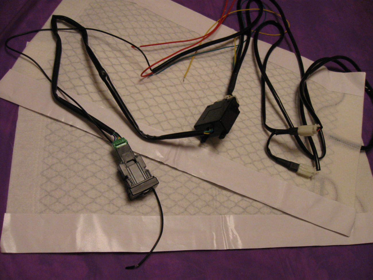

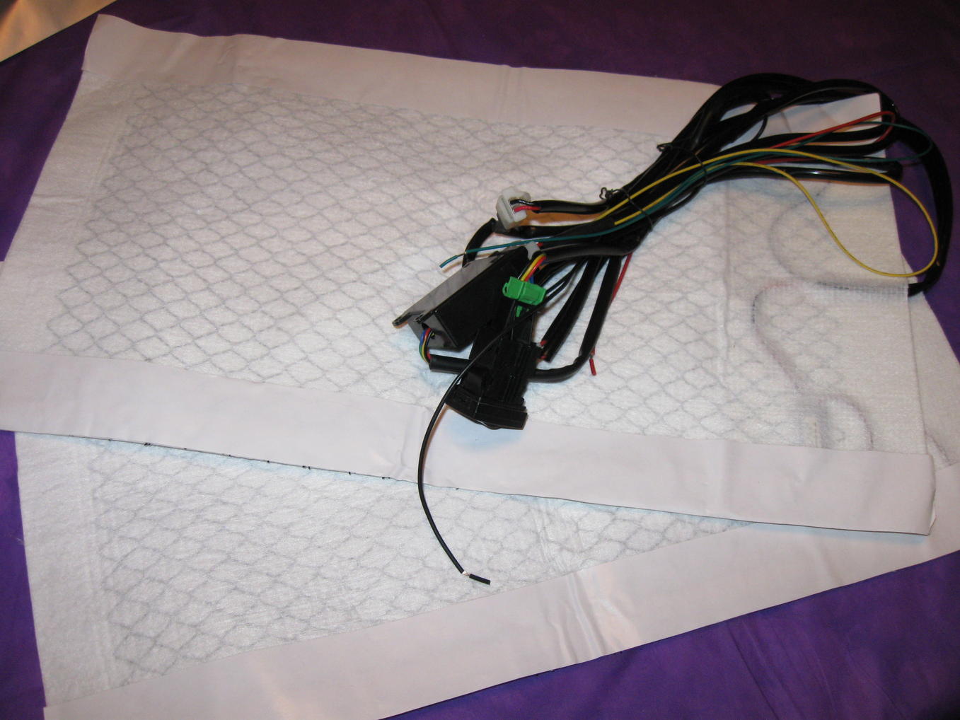

I picked up the Amazon kit and shot a couple of pictures of the contents. Didn't get any instructions at all. Was wondering if anyone had instructions to share? There was also a sheet of mettalic material with a sticky backing... Not sure what it is for, any idea's? Here are some pictures
Picture of one of the kits...

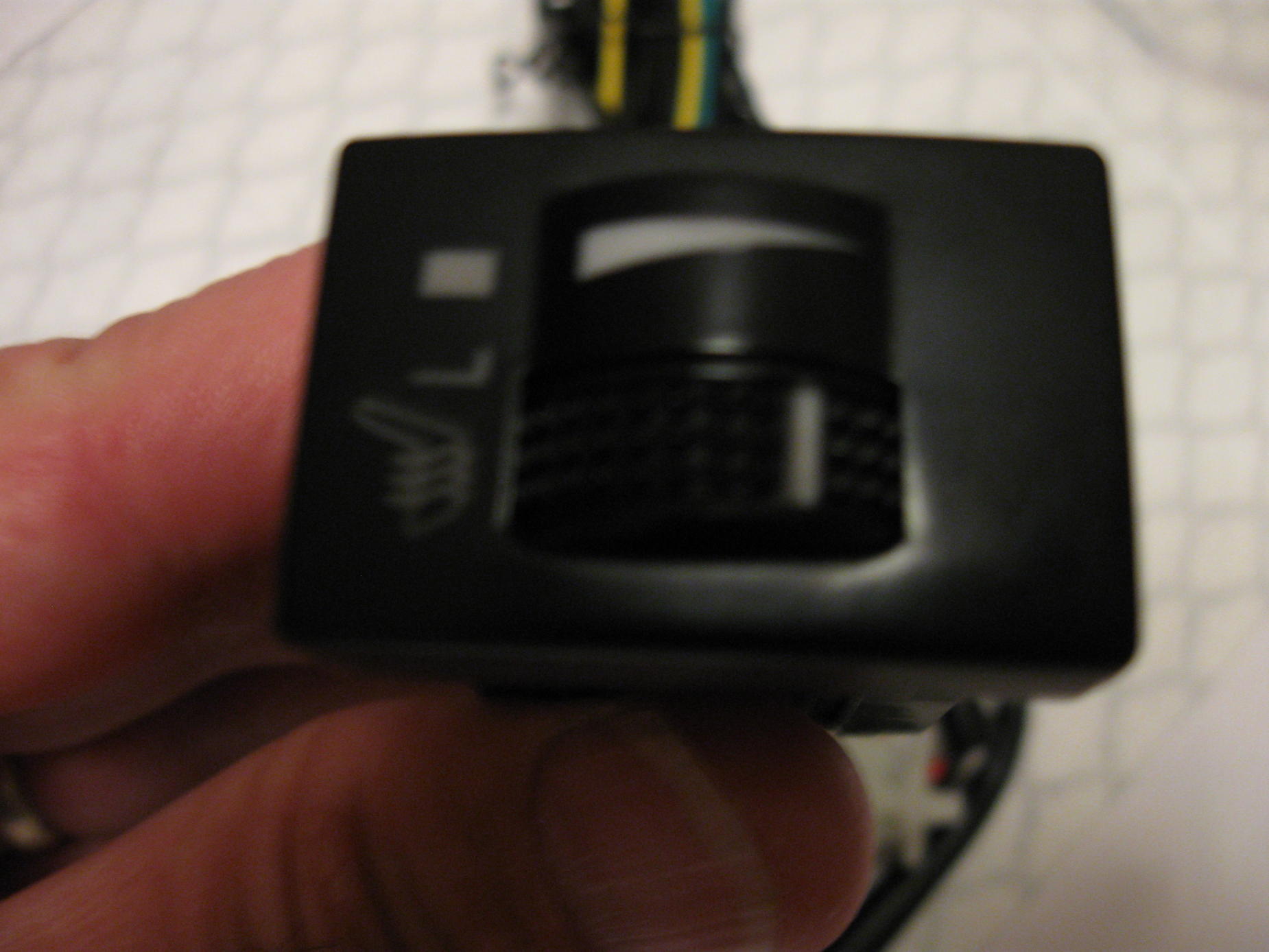

Picture of the Switch (sorry for picture quality). It haves 5 indexed settings. Switch looks good and the dial is nice and tight.

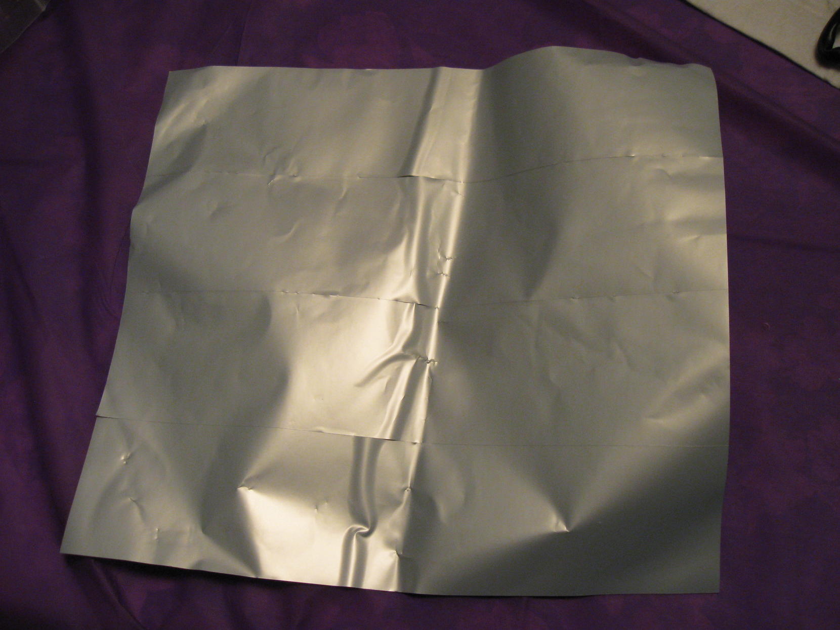

Here is the Mettalic sheet that has an adhesive backing, Any idea's what this is for?
Picture of the one of kits...

as to the earlier question, the horizontal line on the adjustment dial does seem to light up somewhat, it is more of a reflection from the green light on the side, but the line is clearly visible at night.
seats get hot, real hot. I doubt I will ever use them past the midway point.
There was a question earlier about the lines on the dials lighting up at night, I taped over the side lights, they are too bright and distracting for my taste.

the Kit just arrived in the mail, it looks good, I will post pics shortly, the buttons appear to be oem toyota. No instructions included, there are red, black, green and yellow wires, I guess I will have to figure out what goes where.

I basically read through this thread 10 times and searched a little on the internet.

curious if the OEM seat heater switch would work as a replacement for the switch provided with the kit?
kinda sorta answering my own question here, but just FYI i wrote to Rostra, which makes a similar seat heater kit a few folks have installed here. Rostra has upgraded their switching options too, and now have a more OEM-like radial dial switch available (though it appears to use a blueish LED which might be a little annoying in the cabin at night). their "non-answer" to using a Toyota OEM switch with their kit is that "it's not recommended and would void their warranty" which may or not mean that it would work. :shrug:

I'm not sure. I'm thinking the lighting/power/ground hookups would be easy enough to figure out. The output from the switch needs to jive with the input for the control box. If they match it should work...Somebody is gonna need to bite the bullet and test it out.

I'm too lazy to go looking for it, but I read on other forums that the OEM switches have resistors or something that make them incompatible with aftermarket heaters. And Antman wouldn't trade with me anyway. He said hells no.

well that's a bummer. i'm willing to contribute an OEM switch for experimentation, but seeing that we're halfway through winter i'm not inclined to pick up a seat-heater kit until autumn; other mods in the meantime. :)
Antman: another thought/way to come at this: think it's possible to reverse-engineer an amber LED (to replace the blue one for the seat icon) into the rotary-dial switch that comes with the Rostra kit?
The connector is different, 5 pins vs. six pins. Flat vs. a square connector.
[MENTION=65614]Antman[/MENTION]: since you have the OEM seat heaters and have also worked with these aftermarket kits—and because you're our resident electrical/wiring/lighting/LED/OCD/detail-oriented craft project guru—i wonder if you think the OEM switch would be plug and play with one of these kits?
The OEM switch is definitely not plug and play. It has been used before. Check this link http://www.toyota-4runner.org/5th-g...-work-toyota-factory-switches.html#post839391

[MENTION=65614]Antman[/MENTION]....So when you wired up the switch you were able to have the green "Gauge" on the side come on with the lights correct?
Yes. Kraeken said it's too bright at night though and may put a switch on it to turn the green LED off.
I tapped into a dimmer circuit too, but it doesn't dim.
There appears to be at least 2 different kits out there with different , yet similar, switches so as they say "Your results may vary...".
