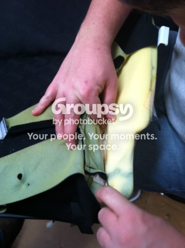

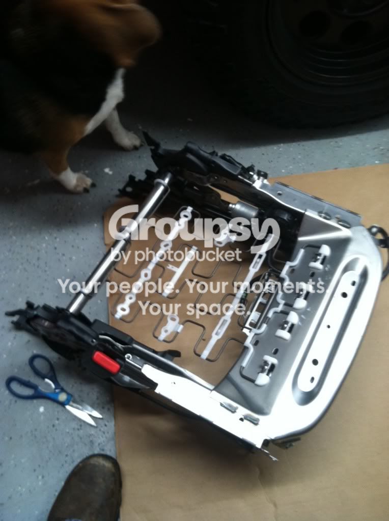

OK- so this took us 8 hrs today. I could probably do this in half the time now though.
While not terribly hard, THIS IS NOT FOR THE FAINT OF HEART. Taking the seat apart and putting it back together can be confusing. We had a left-over plug that we couldn't find a home for. Turned out to be for the seat recliner motor so we had to do a little disassembly. There are lots of pitfalls- wire routing has to be correct, clips that are difficult to remove, hog-rings to cut, wires that hold the seat cover in place to pull out/reinstall. Having never worked on upholstery before we had some figuring out to do!
To make things worse, Jnance50 sent me a PM offering his assistance that I read when we were already 90% done. :dizzy: Thank you for the offer!!!
The wiring part was easy- but how much have I wired? Like I said though, I'm pretty sure I could do this with little drama in 4 hrs or less now. If you want to tackle this set aside at least a full day!
Couple of observations about the kit- The switches are OK- definitely not the same quality as the OEM ones on my truck. They don't light on the dial and the dial has some play in it. The wiring loom, while a little bulky, is well protected and decent quality. The heaters work at least as well as my factory units. Overall definitely worth $70.

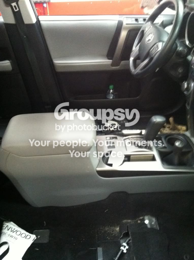

No writeup from this one- just a few pics from todays "fun".
No seats.
photo-180.jpg~original
Unless you're prepared to do this to your seats, stay away...
