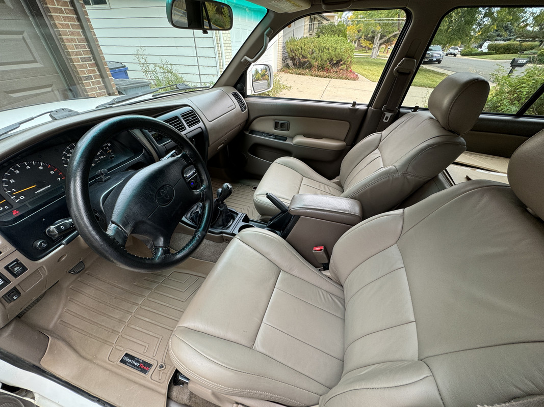

Here's the finished product. Can't really tell with the sunlight but the headrests are 2 toned to match the seats.
Edit: the medium quality of the upload makes the stitching look weird... It doesn't.

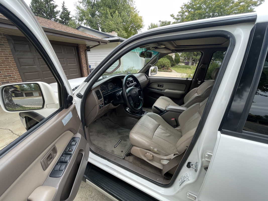

Put in the some Corbeau Moab seats, and the brackets that match. Was about $750 or so, install time was about 1.5 hours. Snapped off one of the nuts on the front left of the body brackets, and had to drill through the bottom of the floor. Got some longer bolts and fender washers from Ace, and a good helping of RTV to keep the water out and it works great. Had to get creative with the seat belt buckle mount, need to get the right size bolts and washers so they don't wiggle around in the new bracket.
