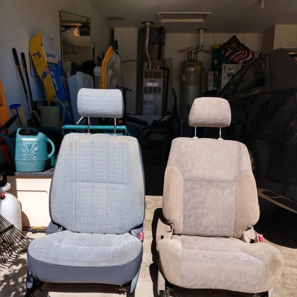

i lucked out and found a better than decent set at a local junk yard, paid $80 seats came out of a 01' T4R SR5
old one on left, new on right.for comparison, my driver seat was beyond destroyed
