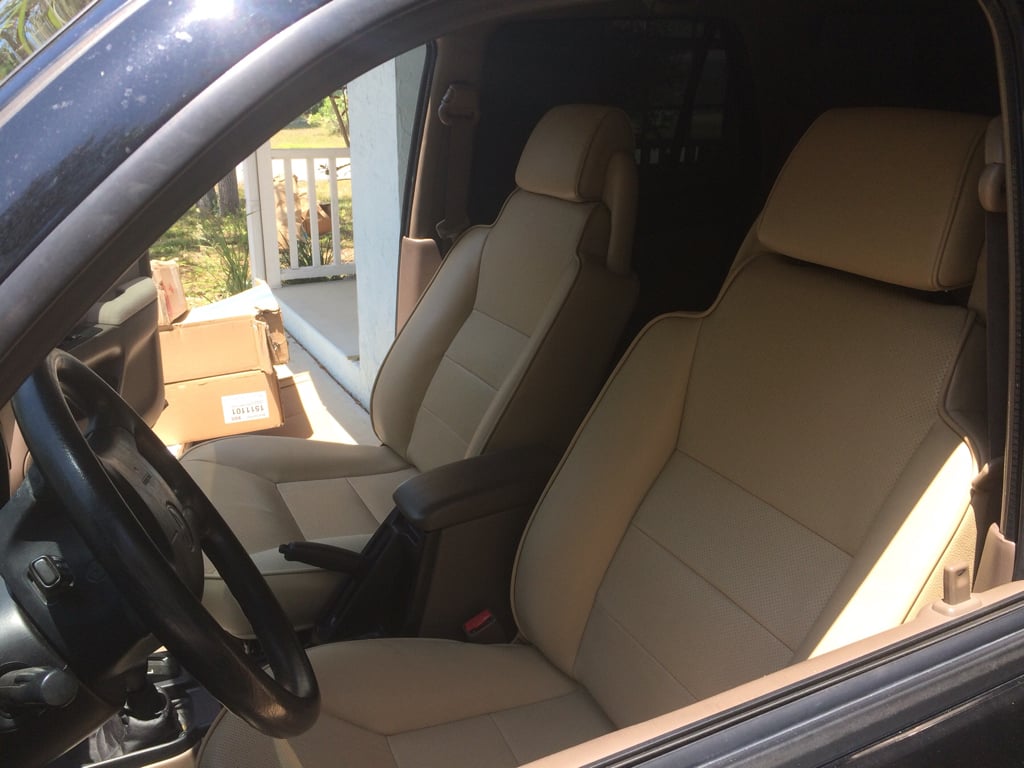

There’s a lot of different seats you can use. Really depends how much work you wanna put into it. Junkyards are full of newer cars with decent seats. Just measure the seat track and find some that are real close or exact. Grind off your mounting feet and weld onto new seat tracks. I put some new Xterra seats in my 90 pickup, with modified bracket to match seat track and in my 02 runner there are now LandRover seats, that was pretty easy. The LandRover seats can be found at most salvage yards as well in pretty good shape.

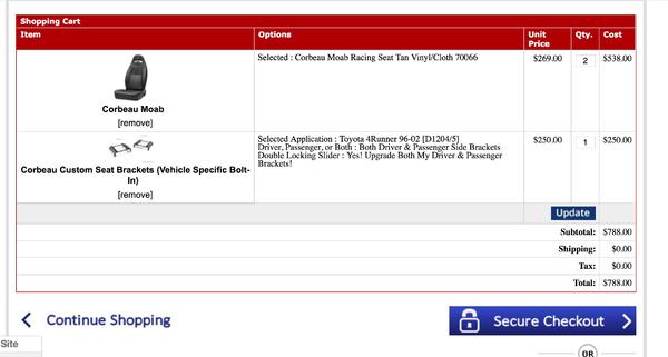

Found free shipping for tan vinyl/cloth MOABs, total $788.

Yup, with 3rd gen 4Runner brackets, double locks on the sliders:

Yes, the brackets are $105, but for a double lock slider add 20 bucks each. So, $250 for a pair...

I really like the look of the tan land rover seats the guy above did. Looks great and saw sets for around 500$ but that involves custom brackets and welding.

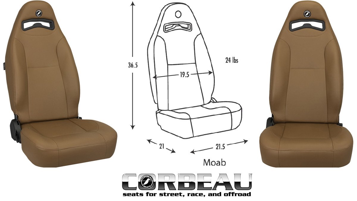

Another factor, at least for me, is weight-savings. With the brackets being about 5 pounds, these Corbeau MOABs should be just shy of 30 lbs each.
