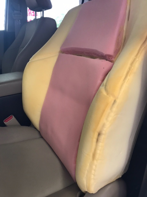

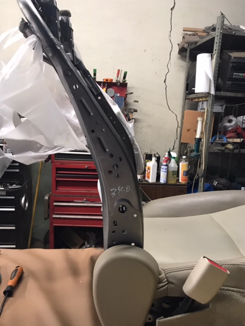

Your hubby and you are right...he's a baby and they suck... I had the covers taken off mine and had them "straightened up" like a normal seat... $150.00 at an upholstery shop. Check out the curvature on this OEM seat prior to filling it in....

I should also mention too....that the pillow folks sit on (in my case) helped because it raises your thighs higher than your knees...which is an issue with the T4R and Tacoma...they both force you to sit in holes. This combined with the curved seat is/was a bad combo for tall lanky folks like me. Raising the seat as high as possible combined with the curvature fill-in fixed the issue for me.

Seems like that's a pretty cost effective way to make some changes. Actually, I'm surprised that's not more common. You have to take the upholstery off to upgrade to leather seats, maybe Katzkin (I always read it as "cat skin") could offer a package that changes the shape and density of the foam along with the cover upholstery.

Care to explain this more? What kind of change is a "straighten up"?

Was that pic with the mod done?
Yeah...sorry guys was up in RMNP for a week...it was killer
That pink foam is the finished mod...basically he removed the "curvature" and built it up from the lumbar to the headrest... in effect giving the seat a more 90 degree angle up from the base. He too was confused by the design and kinda did that (the build-up) from his own experience with seats.
