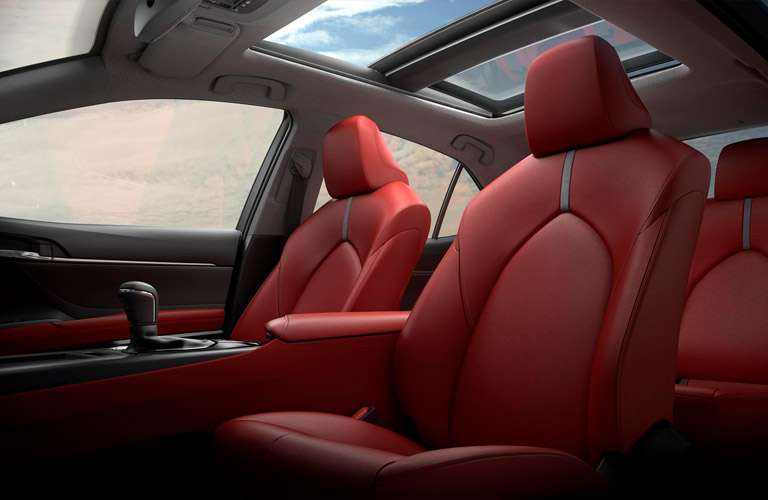

I've often wondered if other Toyota models fit our 4Runner. Maybe not the bolt into the floor but mounts from the seat to seat frame. Have you all seen the new Camry/Avalon?
There’s some current issues regarding airbags, the seat position sensor, and electrical harness that have to be overcome. The airbags and sensor are absolutely critical otherwise you give up safety for comfort.
