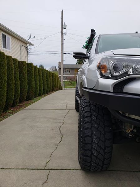

New rubbers, 295/70r17 Cooper ST Maxx 10PLY.
2 year old 285/70r17 Nitto Ridge Grapplers vs the ST Maxx.

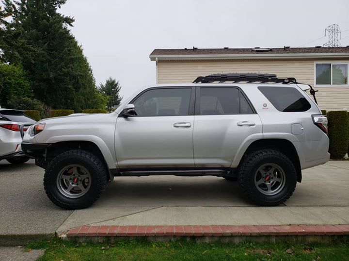

New wheels arrived. FN Five Star in Anthracite Light Gunmetal 17x8.5" -6mm offset. It was a toss between these and the SCS F5's that everybody and their mama's got.

So after having my 295s on for a week I've decided to do a body mount chop. The tires rub at full lock under flex. No rubbing at all from daily driving or during parking situations though. My caster is maxed at 4* while keeping toe/camber within spec. I managed to avoid a BMC after running two different sets of 285s which had zero rub on the obstacles. Ordered the Metal Tech BMC plates so I'll be tackling this job soon.
Looks good. How does the truck feel with the increased weight? I have same size rg and am interest in st max in the 295 as well
Gas efficiency has been the same, no change from the switch over from the RG's. Rides a little more stiff. I feel no difference in power with the 295s.
After owning the 4Runner for over 4 years I finally succumbed to a doing a body mount chop. Previously ran two sets of 285's without any rubbing but after switching to ST Maxx's in 295's the rub at full lock just wasn't cutting it no matter how much you adjust the alignment.
Did it all in 1.5 hours with a buddy and it turned out pretty good for first timers. Very do-able at home if you have any proper sense of handling power tools. Looks like we will end up doing all the BMC's for our buddies Toyotas lol. I used the MetalTech BMC plates.
