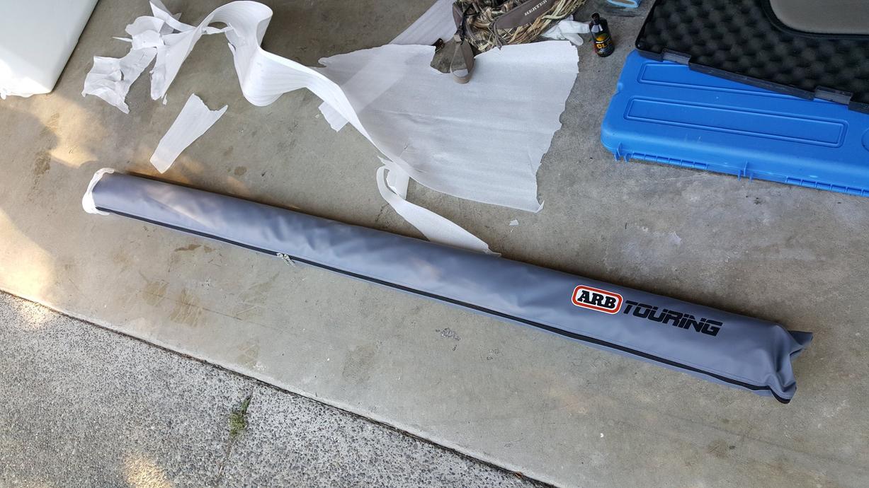

07/2016:

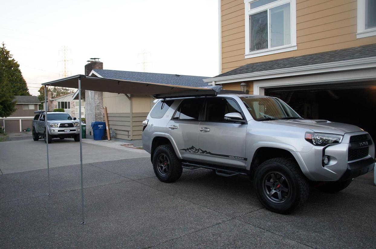

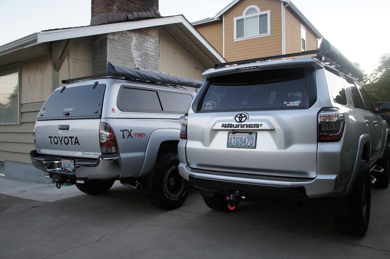

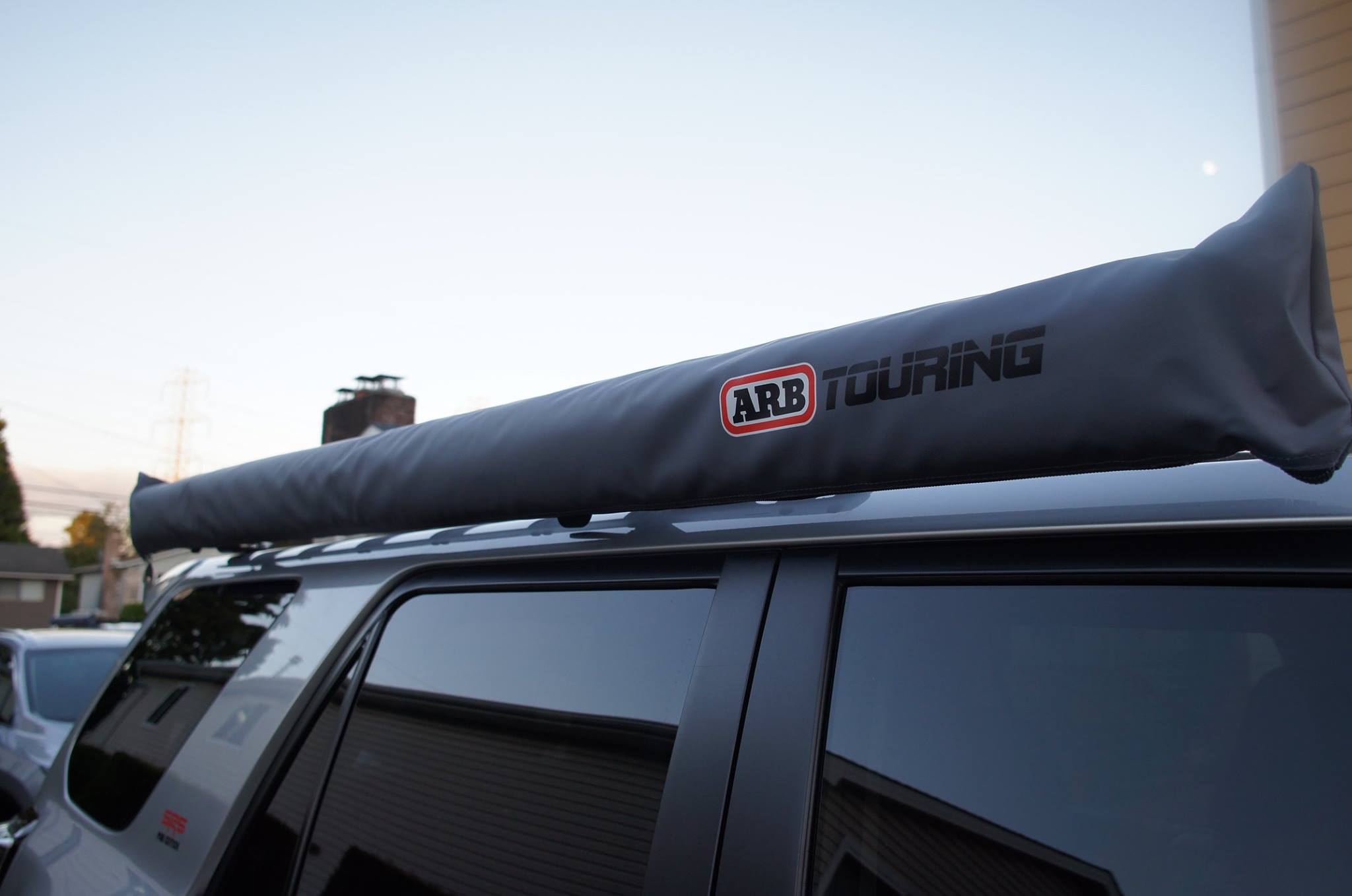

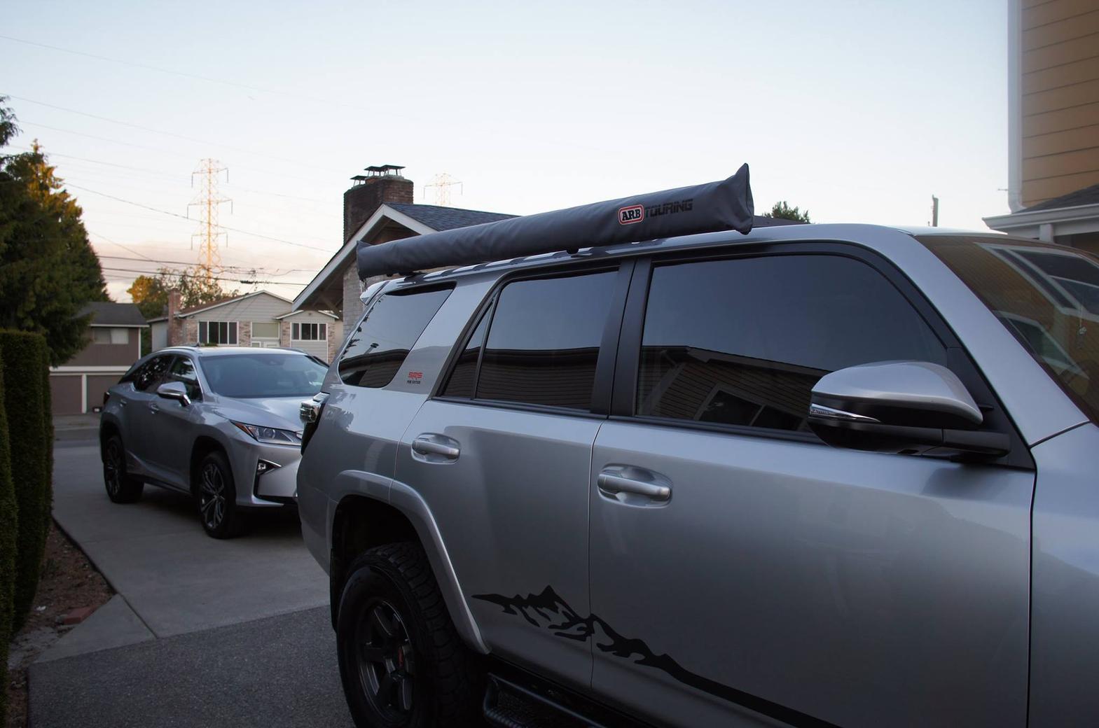

Mounted my ARB 2000 Awning. Used Rhino Rack brackets to mount onto my Prinsu rack.

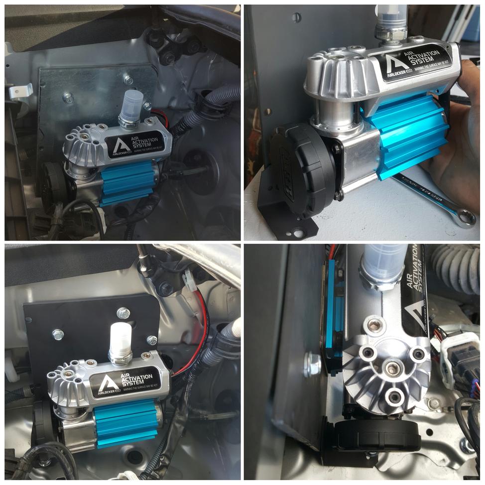

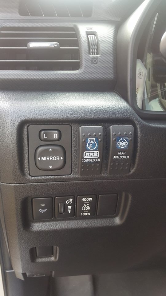

08/2016:

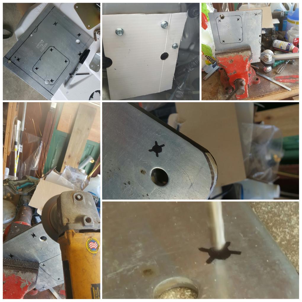

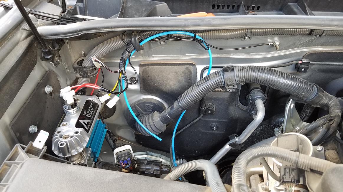

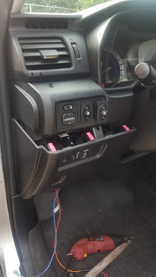

Mocked up and made a bracket to mount my ARB CKSA12 air compressor. Plumbed the switch wirings through the firewall(PITA). Works perfect! Going to use this dedicated unit to supply air to my rear ARB locker I'll have done in 09/2016. I have a separate portable VAIR system for airing up tires.

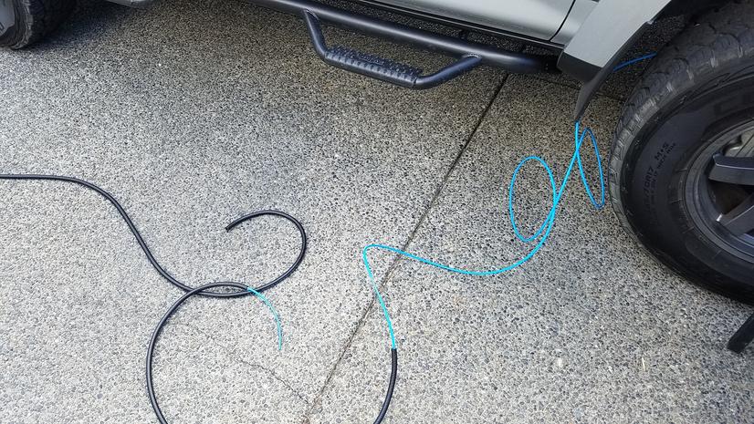

09/2016:
Routed my air line. Ended up going down the drivers side following the hard brake lines/frame to the rear diff.

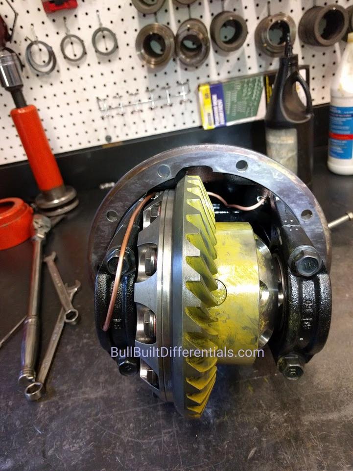

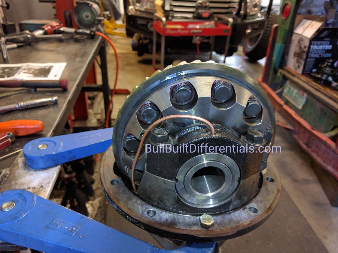

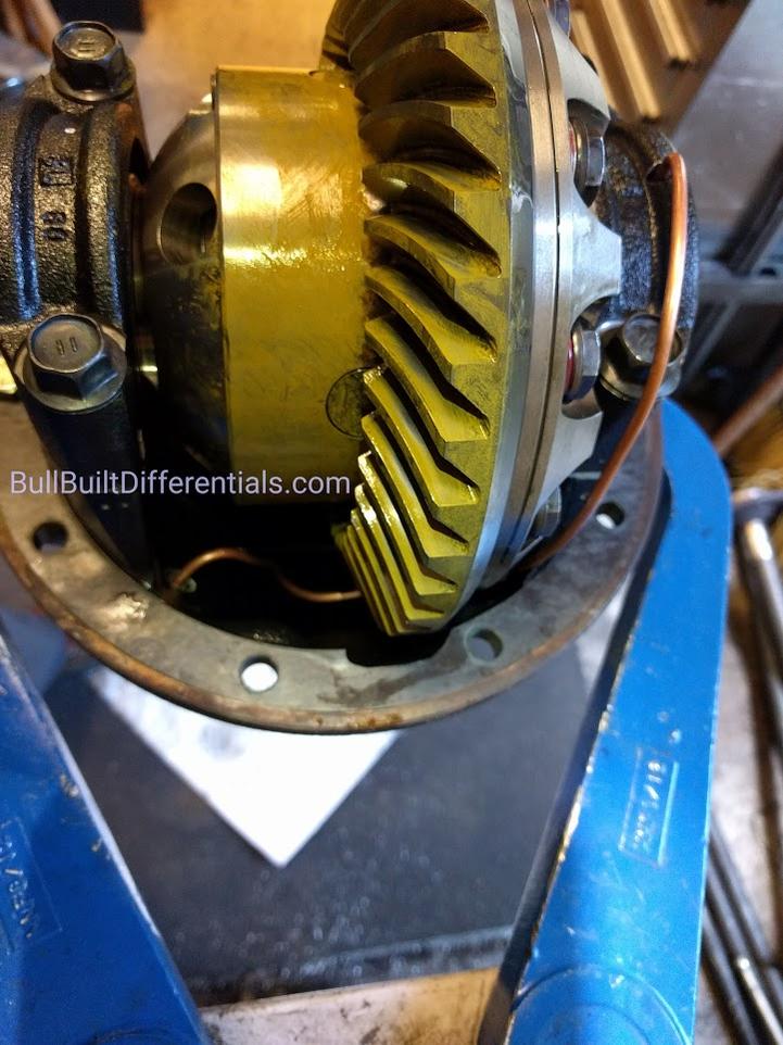

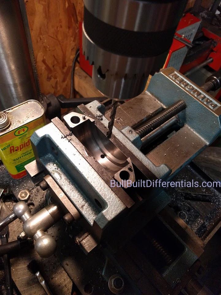

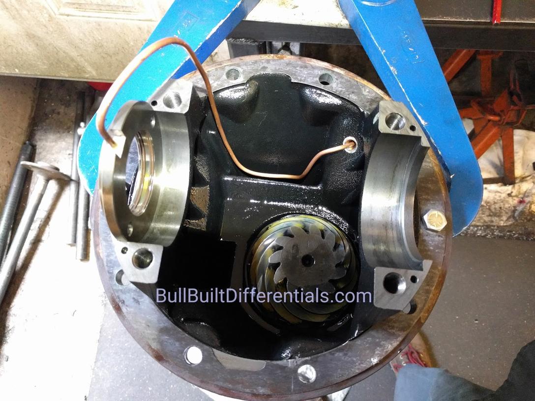

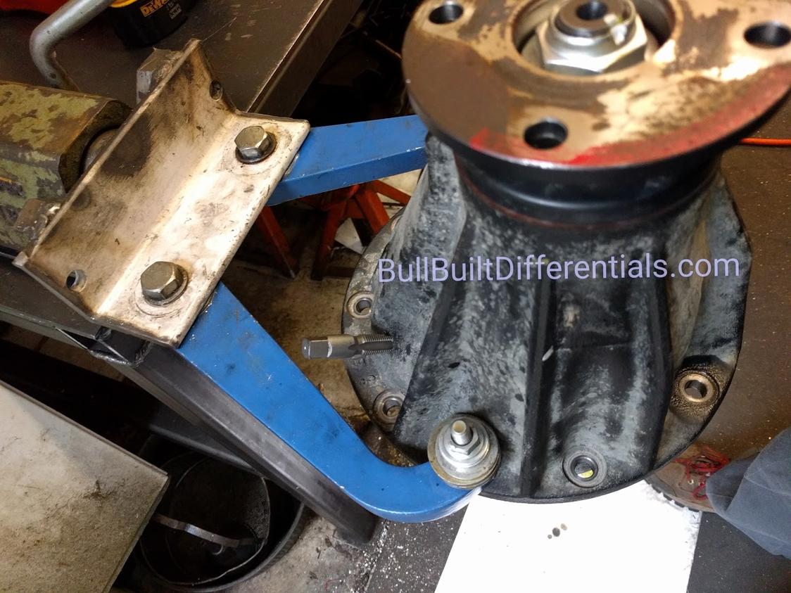

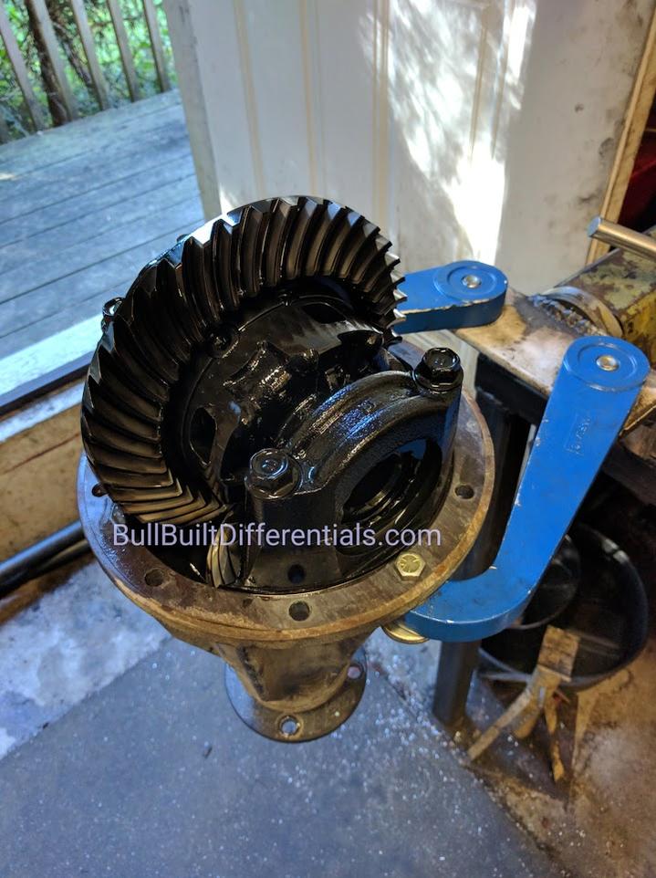

Nils @ Bull Built Differentials did my locker install. Highly recommended by ARB USA themselves. Quick turnaround time too. He'll be doing all my re-gearing and front locker in the near future.
Some pics of the install:
BTW, if anybody is curious the 5th gen uses ARB part# RD193 8.2"
The tricky part about the 5th gen rear is that there is barely any clearance to get the copper airline around. You have less then 1/4" of clearance and you have to bend the copper line correctly into shape before you drop the unit back in.

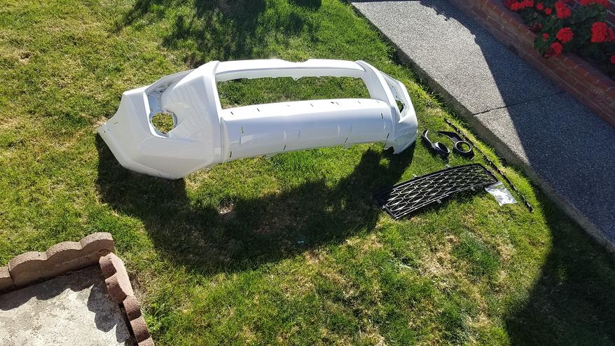

Bought the Addicted Offroad 2014 prototype steel bumper just now. Will be going to pick up another '14 bumper to cut up. Will keep my factory bumper just in case I want to go back to stock.
Scored a bumper and all the extra trim pieces. Going to get the jigsaw ready and hopefully get a straight cut. Thanks Mistaken!
All clean for this garage shot. Going to miss having that extra filler plate. Will be a total PITA to remove that TRD Pro garnish to transfer it to another bumper.
