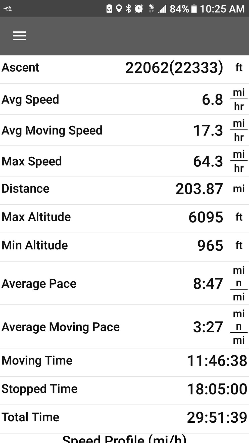

My Gaia tracks and stats for the entire trip.
