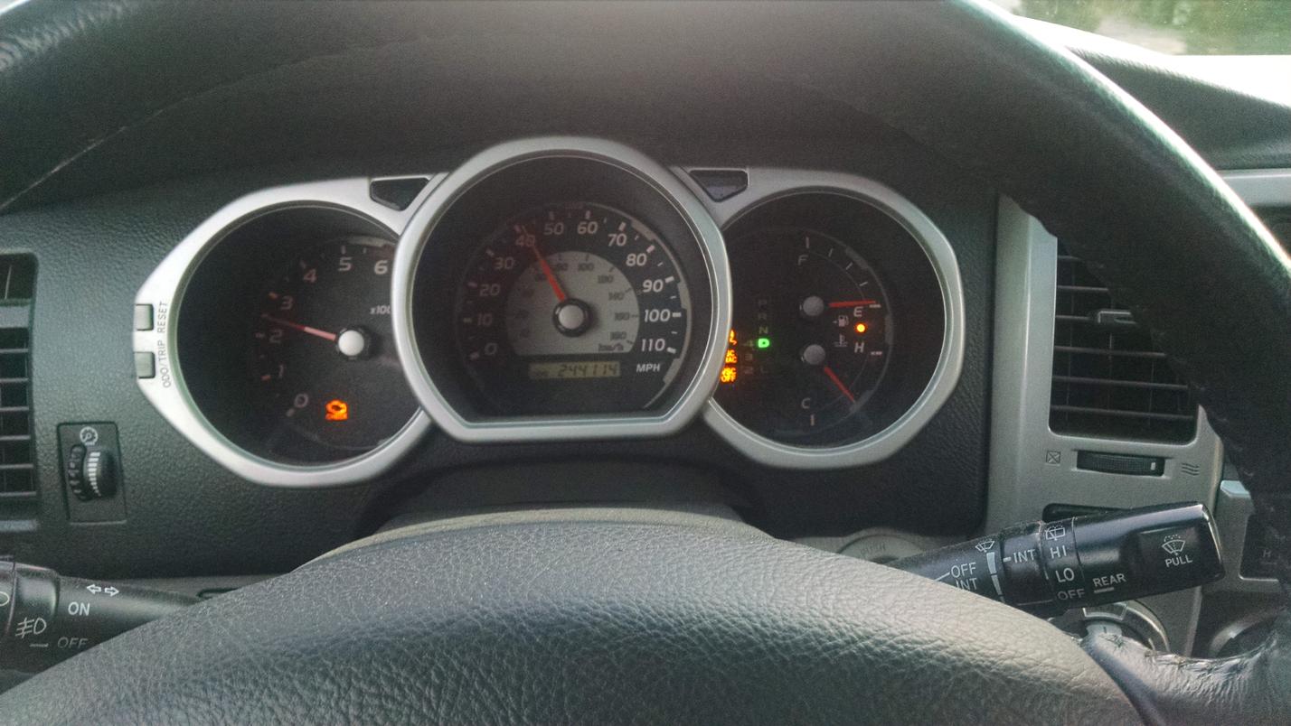

Well, its official....lots of dash lights this morning. I assume I'm limited to 45 mph.....?
For informational purposes, it took roughly 15 cold starts from the time the pump was heard until this morning's complete failure.

Definitely went into limp mode. I can't live like this! LOL
Went to breakfast this morning and tried disconnecting the battery since the pump isn't used on warm starts. Codes cleared for now. Looking forward to installing the bypass.

Thank you for the assist slyfox75. Truck seems to be fine now
