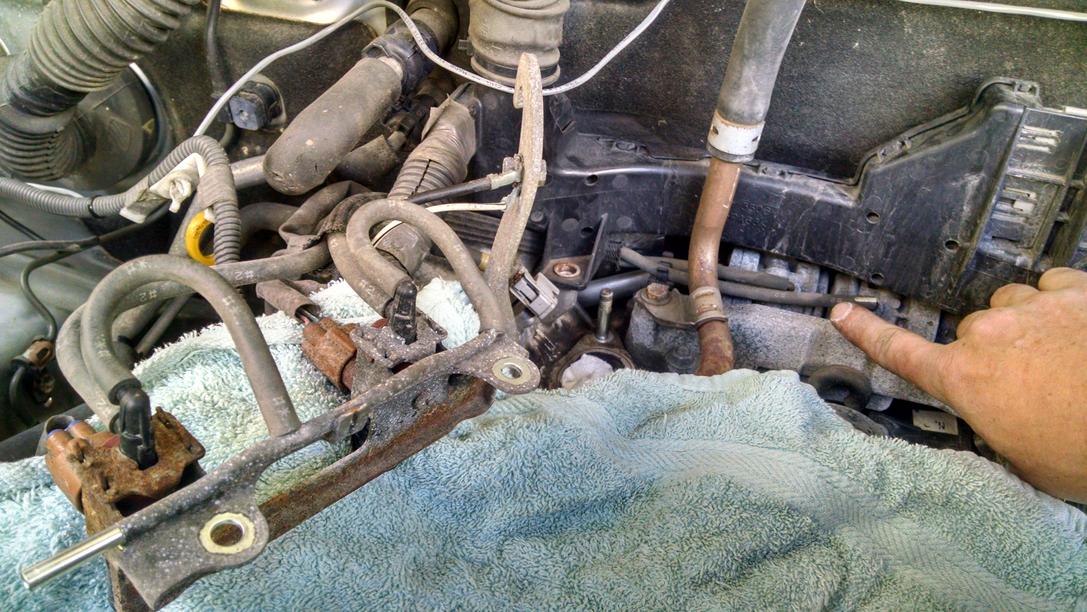

I was not able to get the valve to unstick so I've gone down to removing the intake.
Once I began to trace the flow of the secondary air system, I wondered, does it stand to reason that the two vaccuum lines I'm pointing at which lead up to the two sensors (left side of pic) can be blocked and will offer the same results as installing the bypass plates?

I would be curious if you went to perhaps the NHTSA and tried to speak to them about the obvious lapse in corrective action.

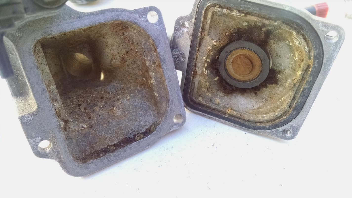

Pictured is what my control valve looked like. Based on how the foam broke down I described it to slyfox75 as heavy pancakes with syrup that has sat on a plate for hours. Makes sense that some valves could stick closed.
Once I have time to do a write up I'll post a link in this thread. The foam is almost like weather stripping but with larger pores, if that makes any sense.
Where did that foam come from?
so you think that foam was part of the valve that eroded/corroded/broke down over time or that is some "growth" or buildup over time that found a home in the valve seat area? Thus making seal not work? if that is case you probably can't just open them up like you did(albeit a PITA) and clean them and reassemble? Thanks for pics.....worth 1000 words.
The foam is inside that control valve body though I'm unsure why it is used....maybe for a filtering effect or perhaps for sound damping from the pump? No idea.
It is my belief that, since my truck sat for a week while I was traveling, the foam was already broken down inside the valve body and it was only a matter of time. It didn't grow, it broke down and was pushed through the valve on that first startup. The small area that is free of foam is, what I imagine, the only available flow path which caused the pump to overrun and create the shop vac noise that many hear during this type of failure.
The resulting engine lights were due to the sensor (attached to the valve) seeing some level of back pressure.
