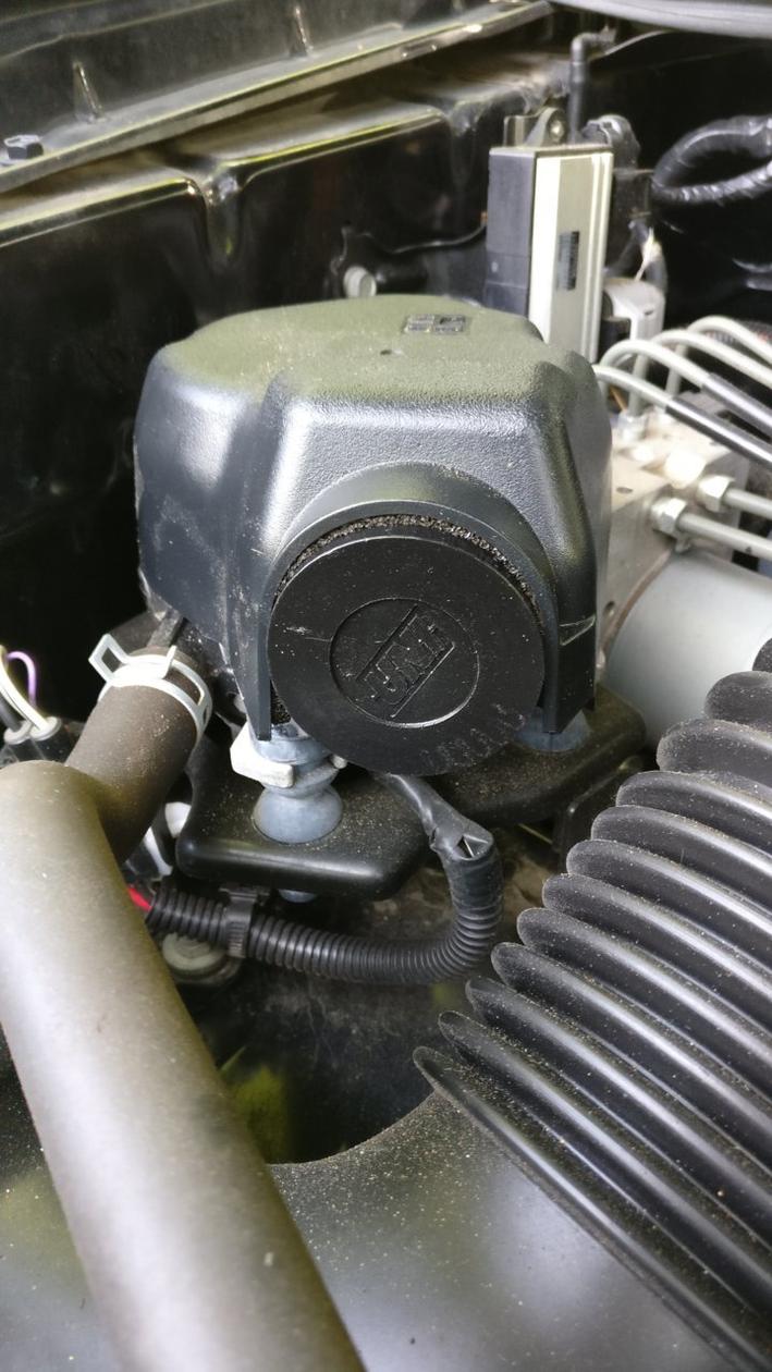

I have had one on my 4runner for over a year. This is a well known problem on Tacoma's since they were one of the first victims to receive the crappy air pumps. Any way below are some pics of the one on my 4Runner never mind the air pumps location it has been moved to make room for a couple of other things. The only thing I have noticed is it makes the pump a bit louder as it probably breaths a bit better now.
With the factory cover on. Not worried about ingesting water on mine the truck will be floating before this thing takes in water on so I will have far greater issues....

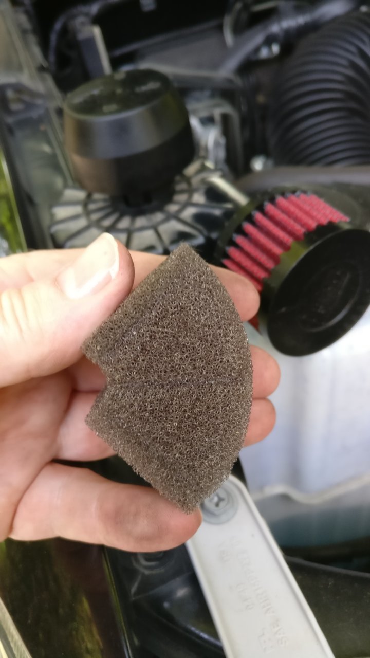

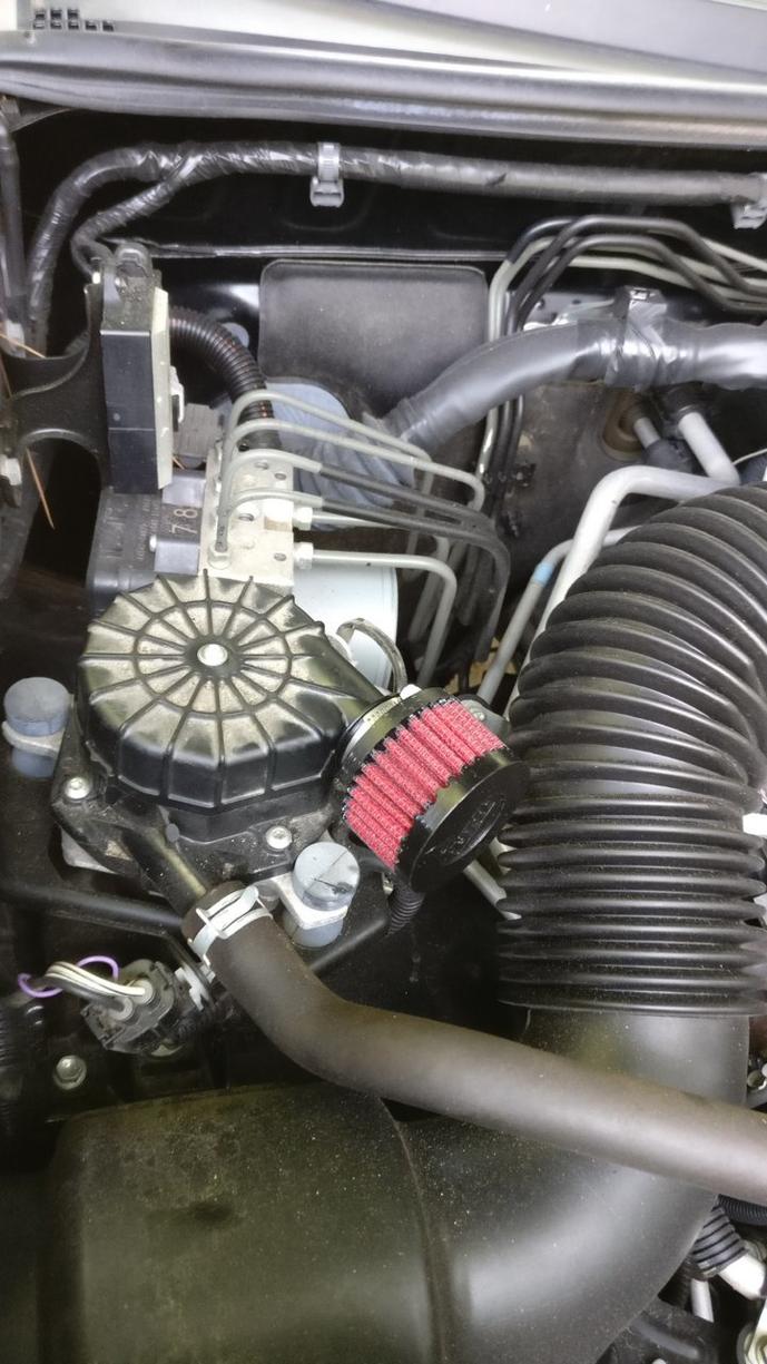

I just did the UniFilter mod on my 2nd Gen Taco. The truck has 53000 miles on it and the foam filter was still intact but brittle. The entire mod took a total of 5 minutes to do and most of that time was spent looking for the T25 driver.
When this mod first came about on the early 2nd Gen 4 bangers the cost of the air pump was $1200 to $1400 but currently sells for $600. The pumps have not been the only casualties of the foam failure. The two injection valves have also been part of some of the failures and they reportedly are running around $700 for the pair and they are only sold in pairs.
To reply to the water ingestion comment, the original foam filter would not keep this from happening so there is no added risk that I can see.
Yes, UniFilter sells filters you clean and oil like a K&N or TwinAir Filter but the filter for this mod is not one of those. This filter will need to be changed instead of cleaned and oiled. How long will this filter last? I don't know, I will be inspecting it at normal service intervals and replace it when needed.
