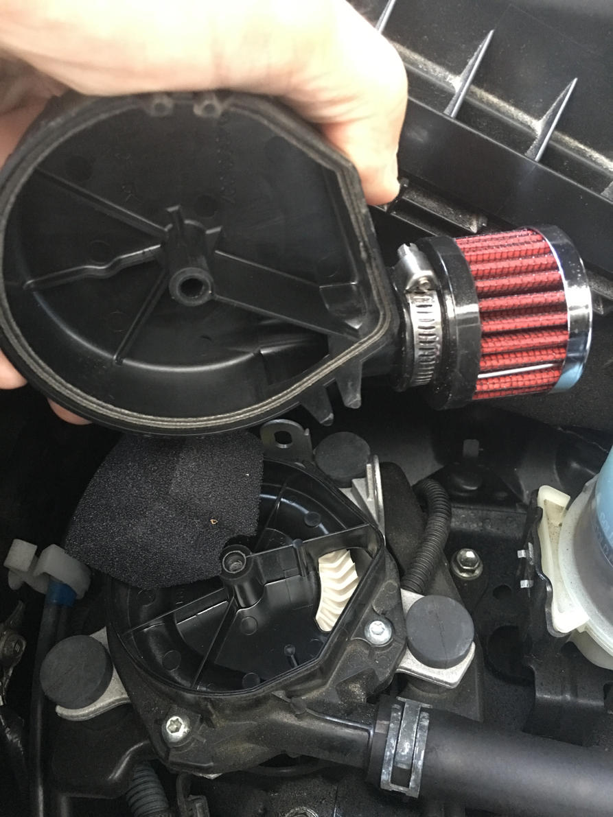

The link explained how to access the foam filter in Post #1.
Once the outer cover is removed, remove the torx screw in the middle of the cover (as shown in photo below), remove the cover and surprise, the foam filter is under the cover!
Remove said foam filter, install uni filter, reassemble.

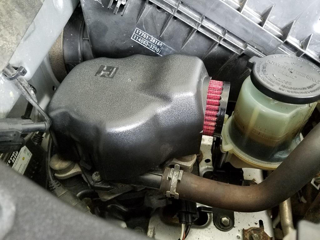

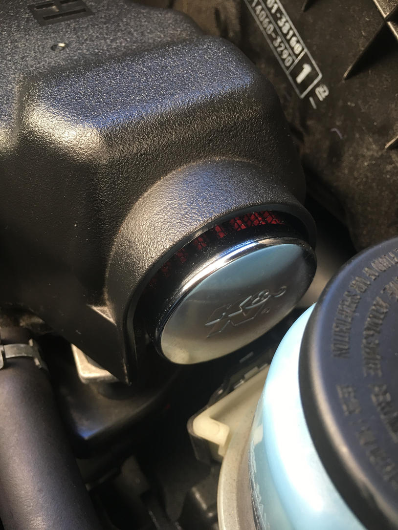

Feels like an extra 5HP at wide open throttle now for sure :trophy:
Ok seriously though, I am perplexed how that little piece of foam in there sat and acted like a piece of filter media, the cap over the intake is an odd design as well I suppose it would suppress intake noise a bit at the nozzle? Who knows, anyway was a worthwhile reason to have a beer and spend a few mins under the hood. Here's some more pics if you haven't seen enough already in this thread >

That K&N one looks like it has a smaller overall diameter and fits better under the plastic cover. Mine had a hard time fitting back on with the Uni-filter, which was why I trimmed it.

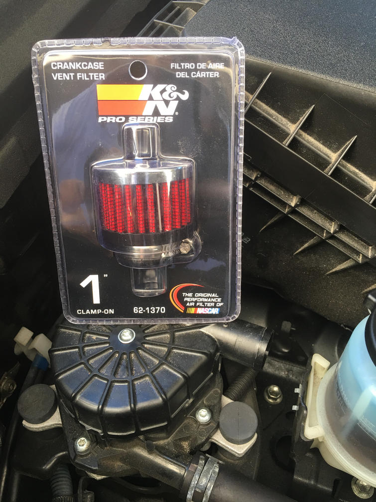

After three weeks and one cancelled Amazon order, I finally received the Uni filter Wednesday and installed it yesterday evening.
A couple notes
The filter fit snuggly under the plastic cover but no trimming was necessary.
There is no whistling or other difference in sound.

Went ahead and did this mod yesterday, took about 3 minutes total, and I cleaned the secondary air pump while I was at it.
Here's the pump location under this trim piece
And here's the stock intake and "filter" mesh, such a shitty design in the first place.
Got it over the nipple and tightened it down.
Would have preferred the unifilter for the black look but I liked that the chrome K&N didn't require any trimming at all and fit perfectly under the trim piece.

To those that have done this mod, any preference/advantage to the K&N as opposed to the Uni filter?
The only difference is that the K&N fits under the trim piece without needing any trimming or cutting, that's why I spent the extra couple bucks for the K&N. There's no other real advantage that I can see
