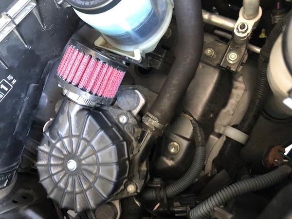

Got my filter in, 5 min install. I saved the parts that came off. That old filter does seem cheap. The pump is a little louder but not much.
Done and Done.
