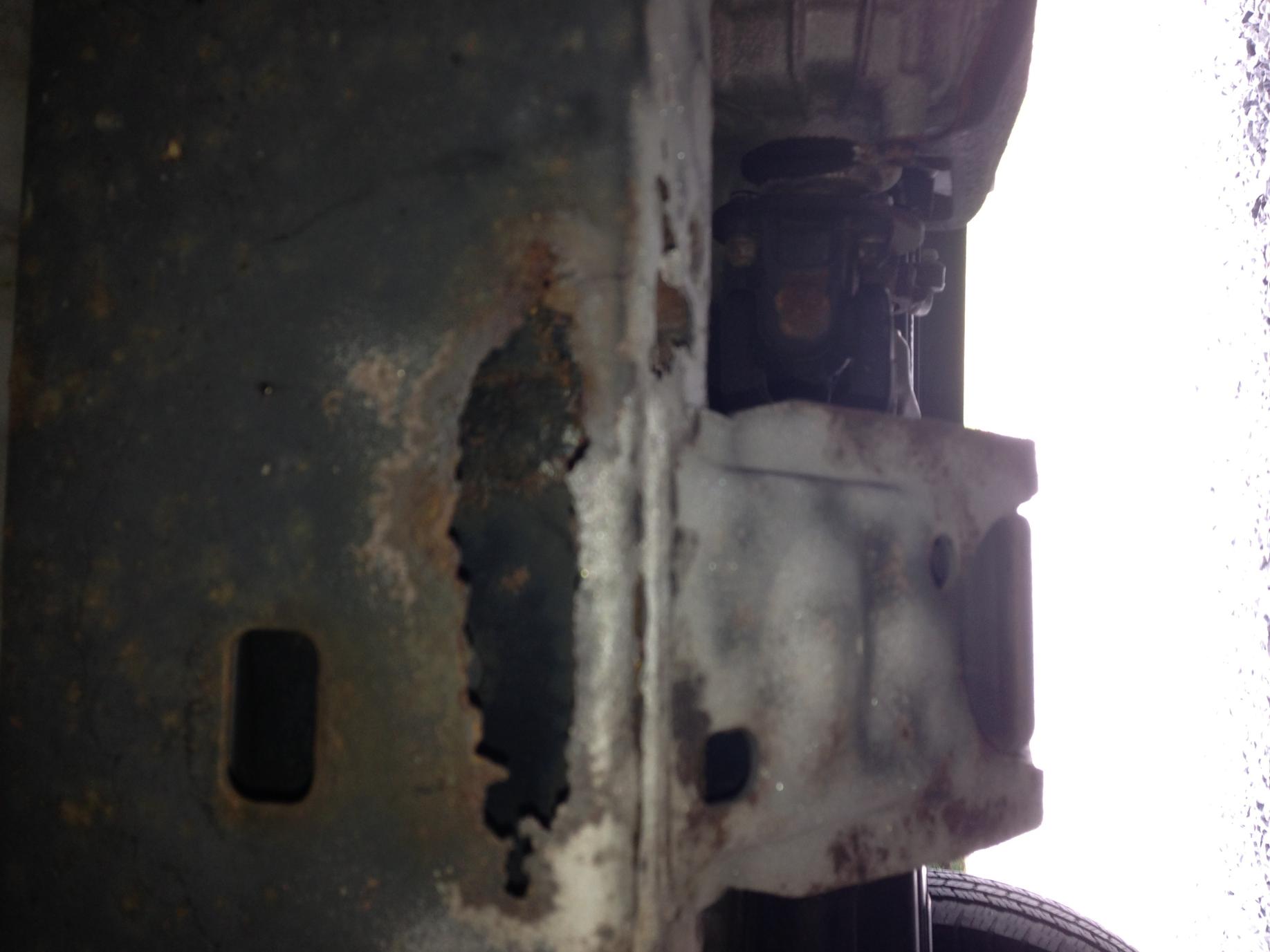

My frame rot
Here is my frame rot. I bought this 96 SR5 as a puppy hauler. Didn't see the rust Untill after I bought it.

This thread is entirely confusing to me. I feel for those of you that do not frequent internet forums and were unaware that older vehicles rust, particularly in the midwest and Canada. But I can't figure out why people can't use the best-in-class ground clearance to crawl under there and do some rust touch-up. It takes no mechanical skill whatsoever.
The biggest problem location is the frame at the rear control arm. If it's rusty, do your best with taking it to bare metal, get some fresh paint on there and keep an eye on it. I also highly recommend buying the Eastwood Internal Frame Coating product and hitting the inside of the frame (even if just in that one location) so you don't have to worry about it rusting from the inside. Here's a video on the product.

POR-15 is great for already rusted areas (after prepping them properly, of course.) It's tough as nails. It's sucks as a general top-coat for the undercarriage, though. Way too picky on application procedure.
The best method I've found is to spot-treat bad areas with POR, and then coat the entire undercarriage with Fluid Film twice per year. It's a wax-like oxygen barrier, you can blast it all over everything in 30 minutes.
