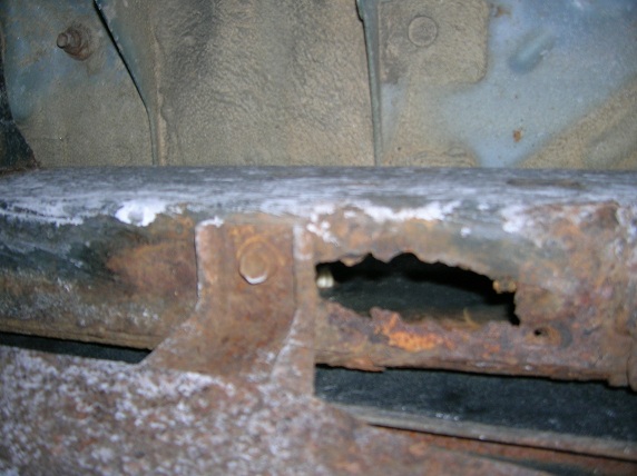

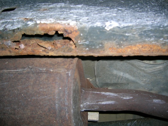

Before:
Driver's side
Driver's side
Passenger's side

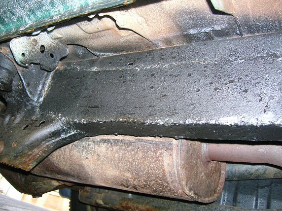

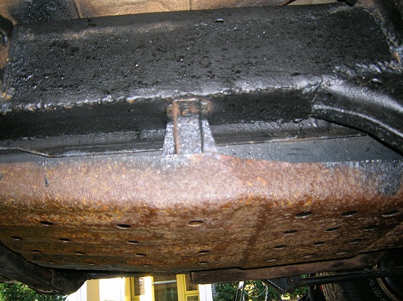

After:
Driver's side
Passenger's side

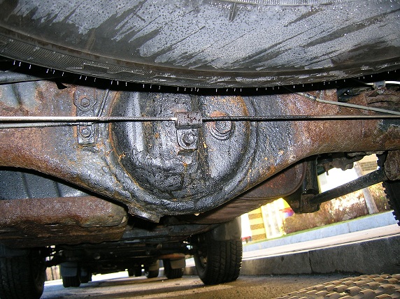

Rear axle cover (the drips are just water)
HMMM.
I may be wrong but isn't this a hole?
2011_03_3120069.jpg~original
No, it's not a hole, though I admit it really looks like one. I had to look at some pics of my axle to make sure.
The left edge of the "hole" is the upright for the UCA, the bottom of the "hole" is the top of the axle housing, and the right/upper side is a mounting ring around the parking brake cable. You can see the cable just left of the "hole", and the attachment for the mounting ring just to the lower right of the "hole.
You can see it a bit better in this photo of my pre-swap axle.
Close-up-axle.jpg~original
It's a little out of focus because I cropped it from a larger picture that was focused on something else.
