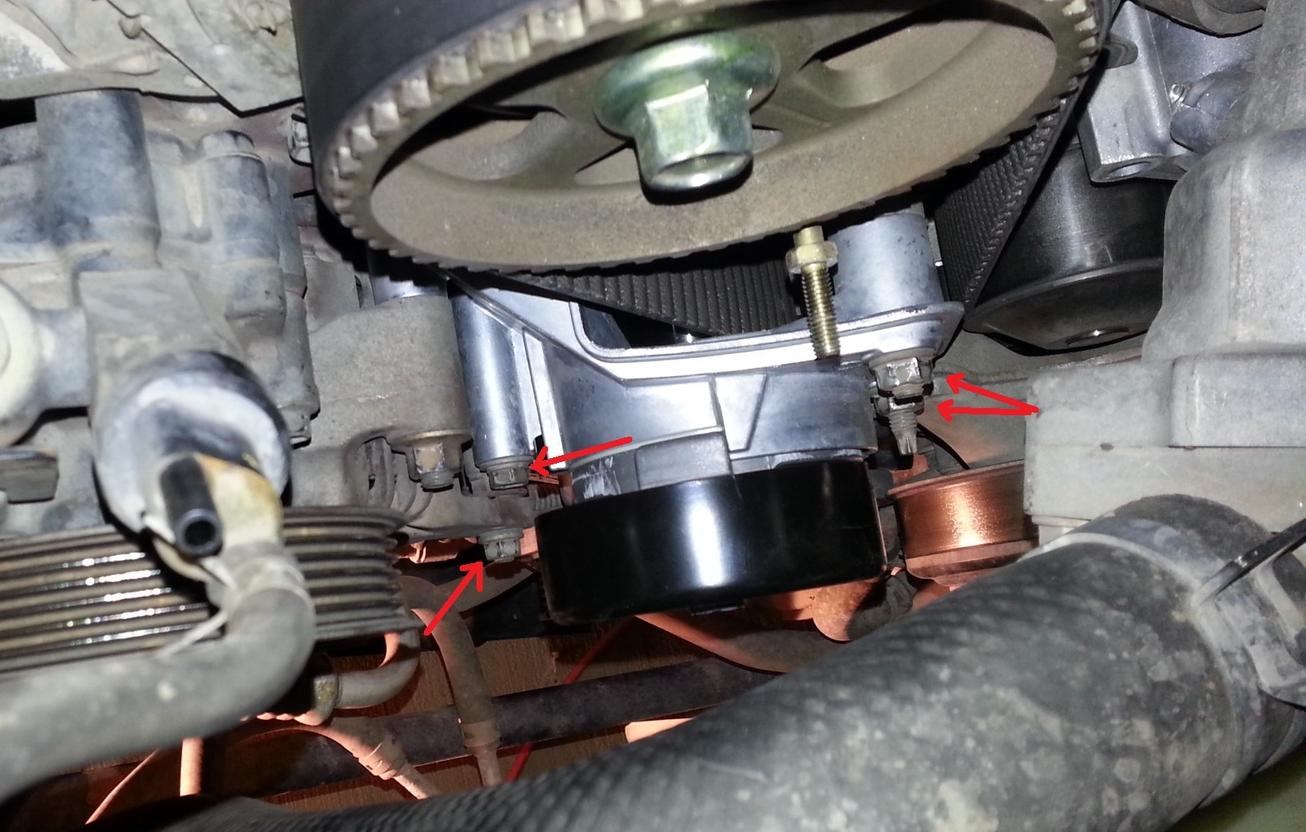

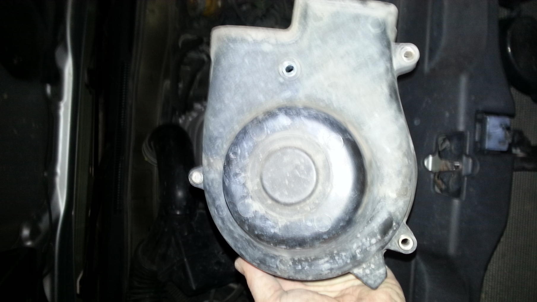

6. Next remove the timing belt cover, there are two pieces. The left side has 3 bolts and 1 nut, 10mm (pictured). The right side has 2 bolts, 12mm (not pictured, but just to the right of the tensioner).
7. Remove tensioner fasteners - 1 bolt and 3 nuts, all 12mm. One nut shares a stud with alternator. (I put arrow by wrong nut, arrow on lowest left nut, should actually point to one just above and to left). The one I'm pointing to is strictly a alternator fastener.

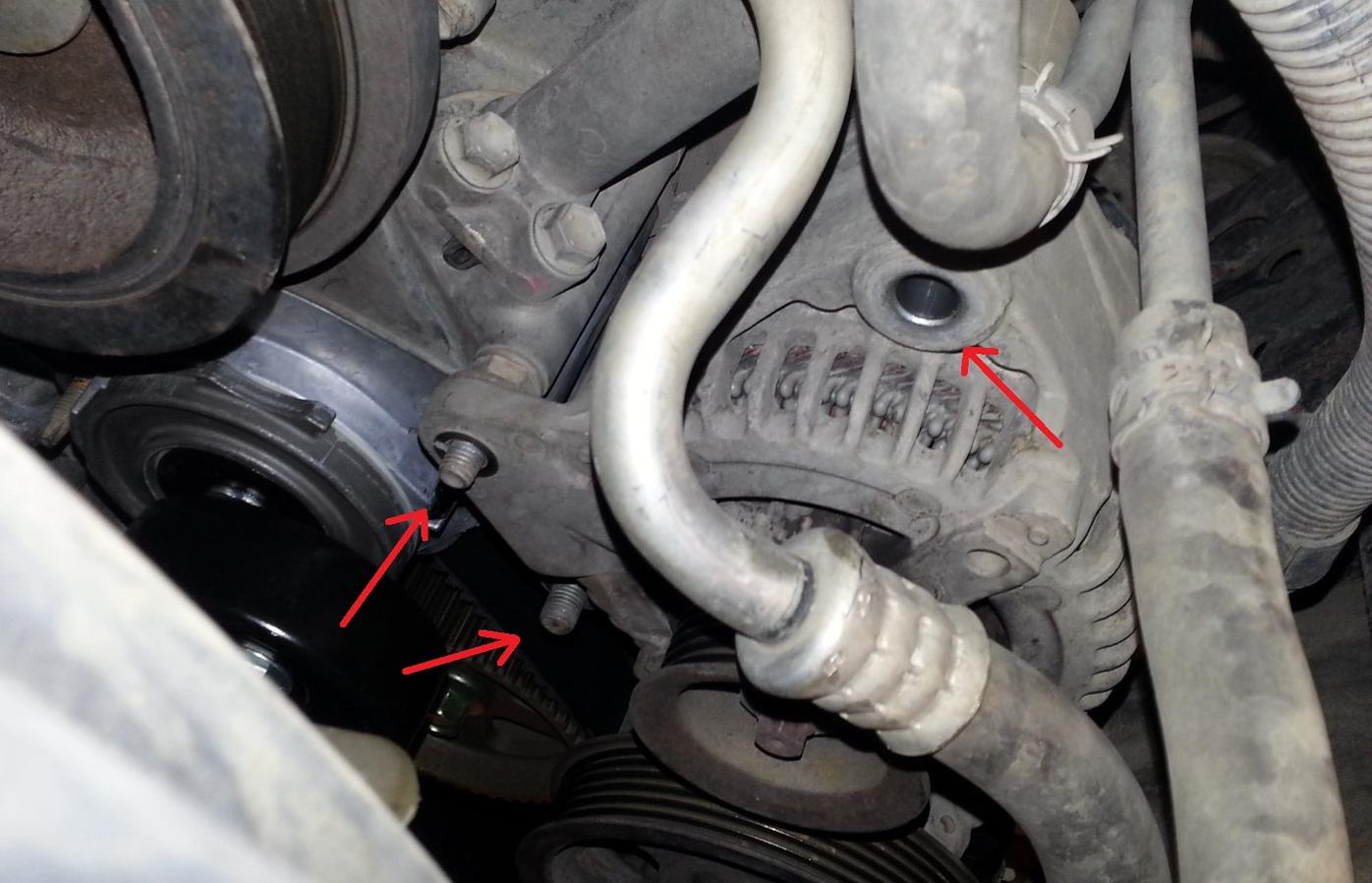

8. Remove alternator fasteners - 1 bolt (accessed from below), and 1 nut from top side of alternator, both 14mm. The third nut (12mm) is shared with the tensioner and was removed in step 7.

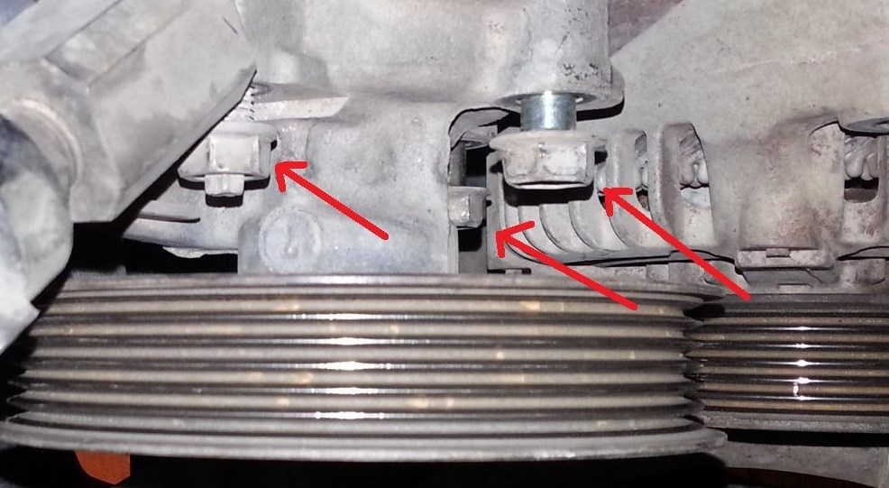

9. Remove power steering pump fasteners - 2 bolts and 1 nut, all 14mm. Access through the hole in the power steering pulley.
10. slide power steering pump toward front of vehicle. Slide alternator off stud shared with tensioner. Pull out tensioner.

Took me about 6 hours as the stud that holds the plastic cover on the timing belt threaded off instead of the tophat nut.
I also was able to do the entire replacement without removing the radiator hose and having to mess with the re-fill of the fluid. I will say it would have definitely made things easier.
I also just used this post as reference. Was a lot of help. Solid pictures.

I've removed the bolts to the p.s. pump and can't get the dam thing to budge. I was tempted to bang it woth a 4lb hammer bit dont want to damage the pulley. Any suggestions?
