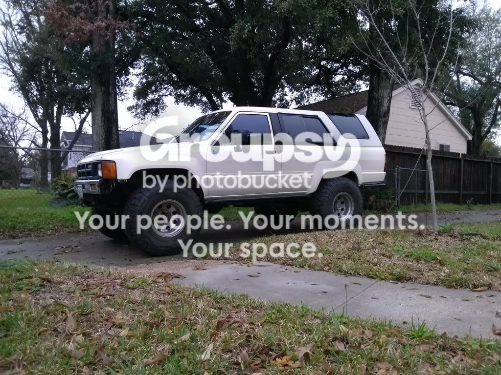

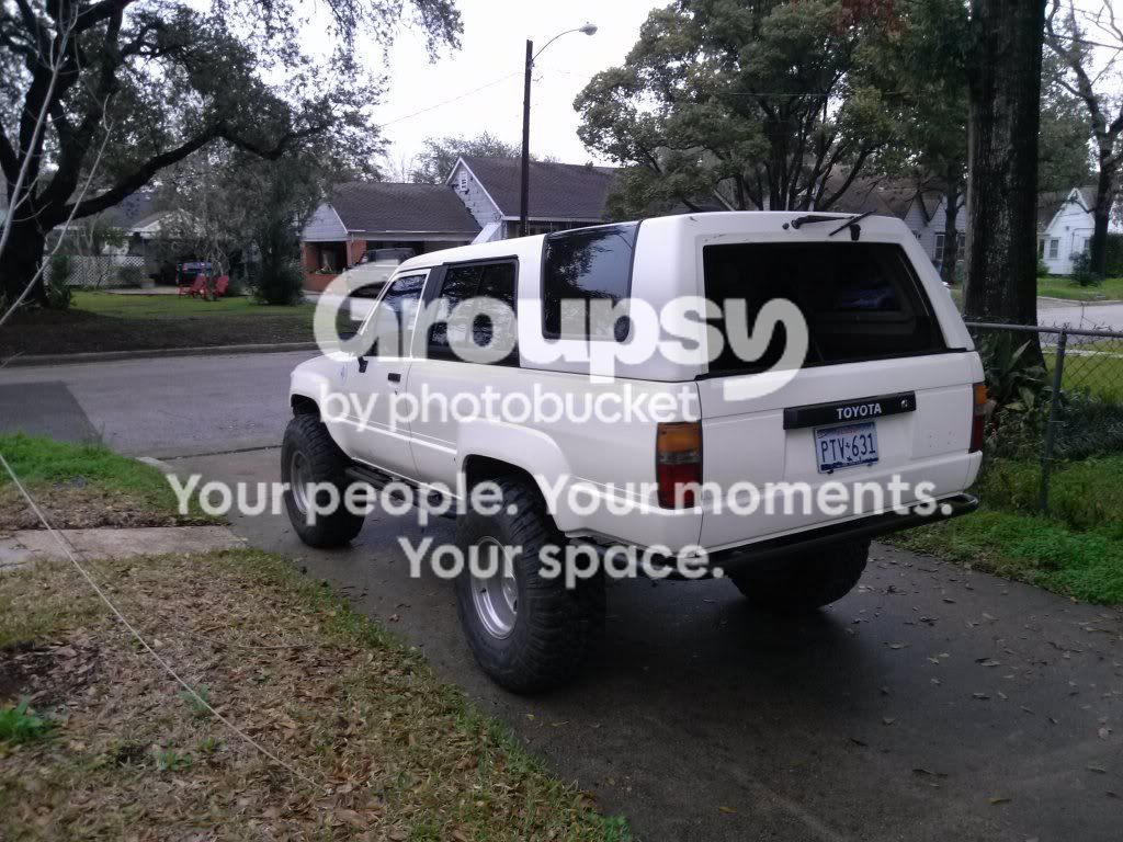

Pics:
0218121439.jpg~original
0218121439a.jpg~original
