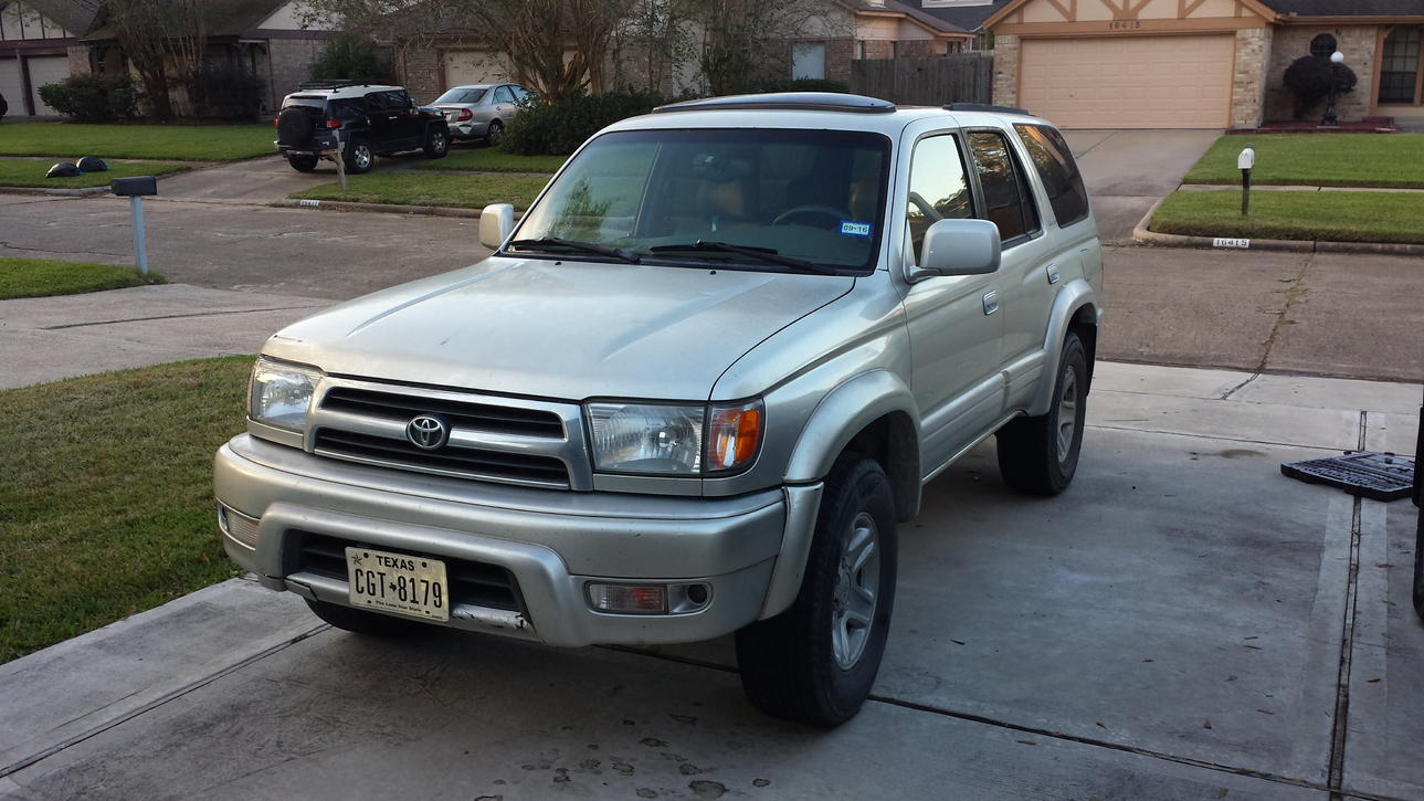

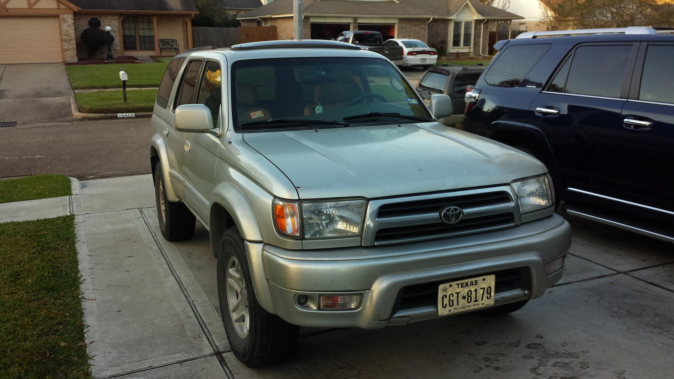

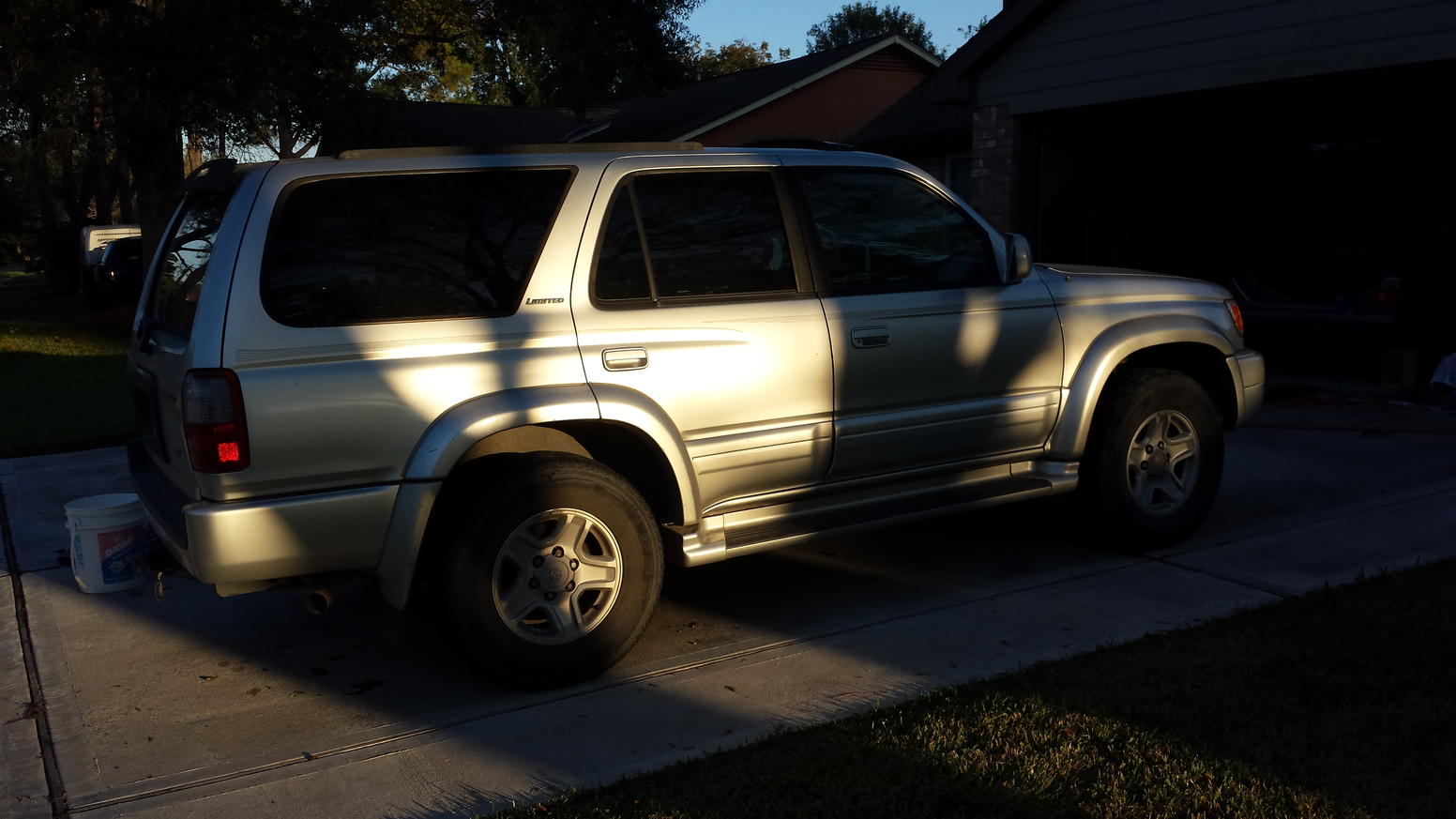

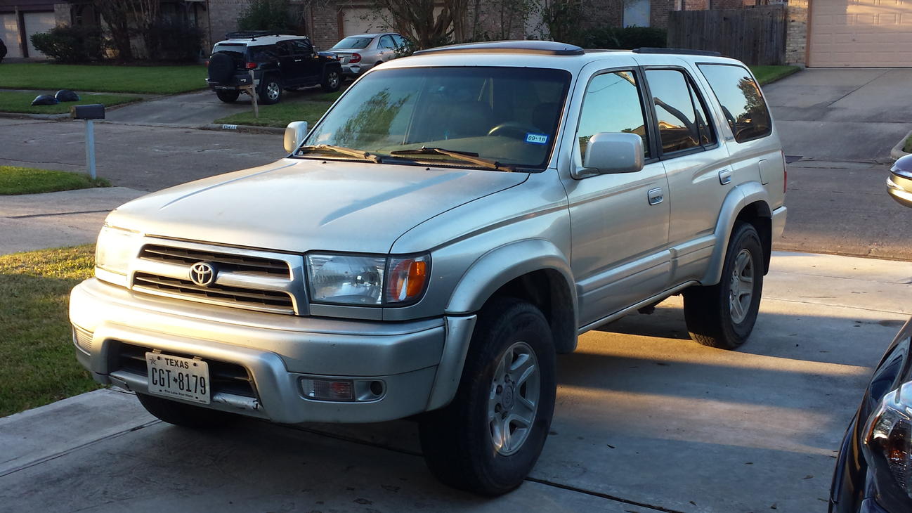

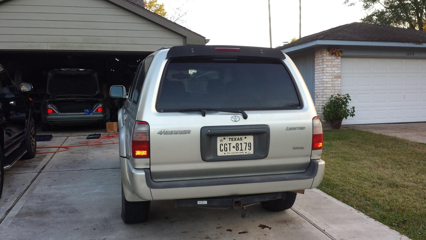

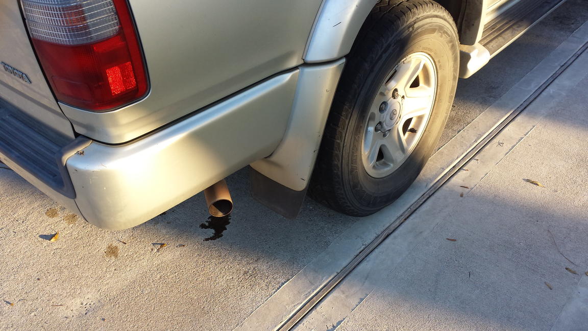

Just getting started. I had already removed the luggage rack and forgot to take pictures. :redface:

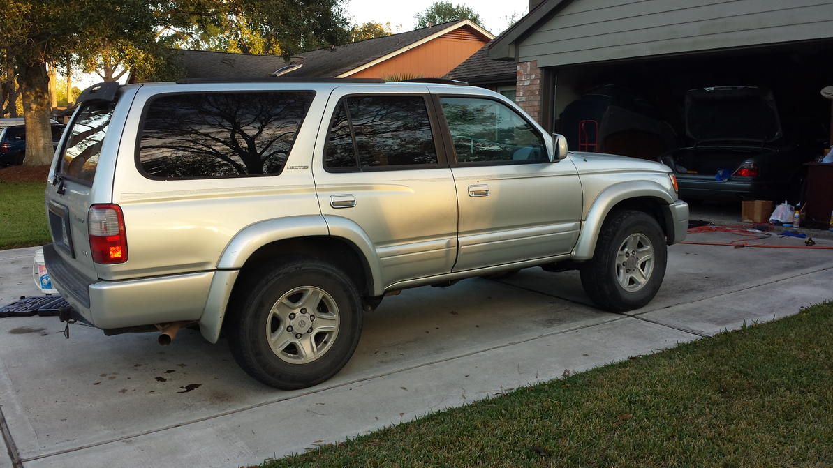

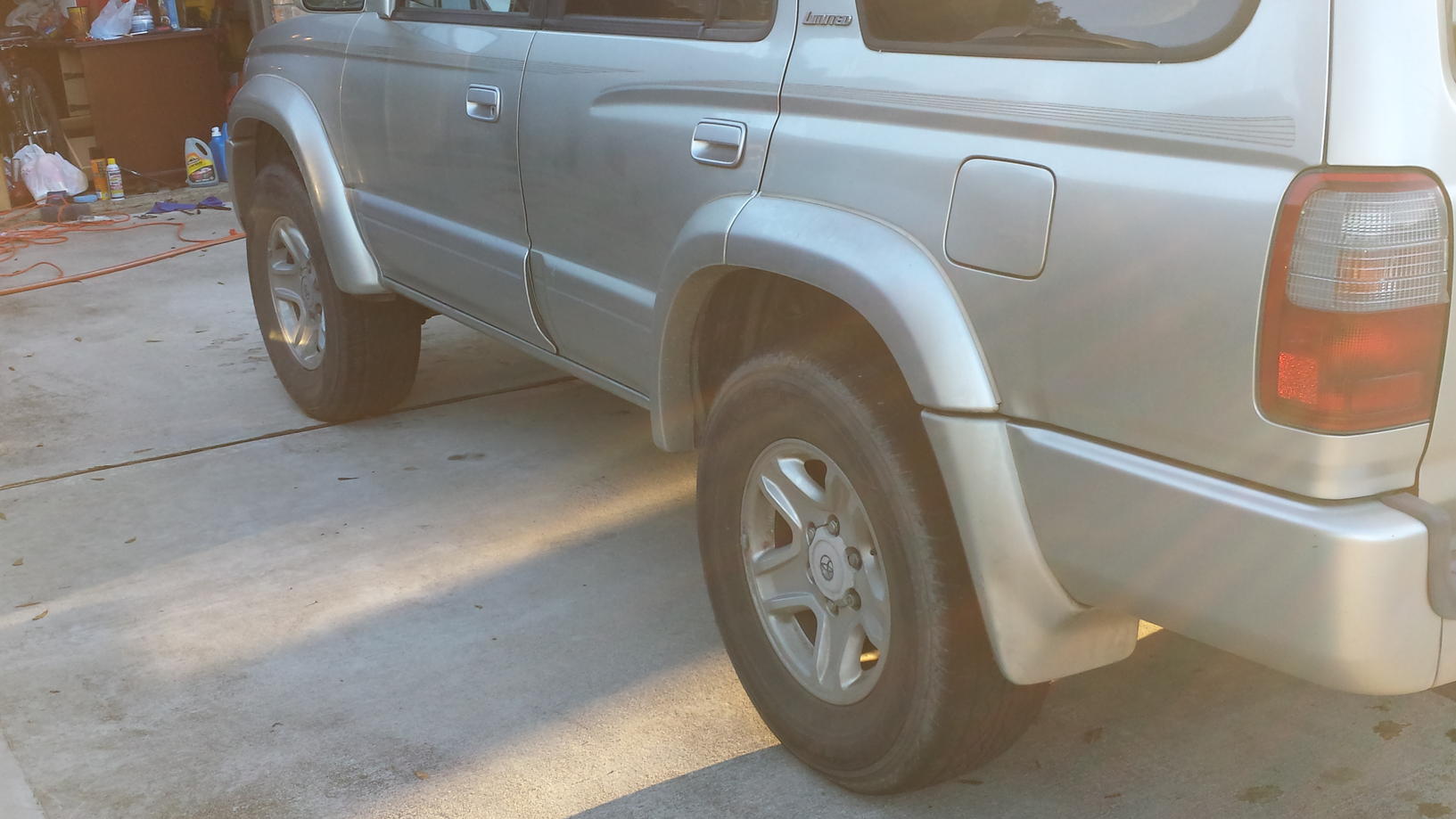

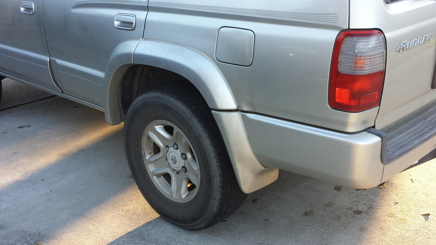

I removed running boards and trimmed the mud flaps.
It was pretty ratty looking: paint peeling and all. I might paint it and put it back on. I kind of like the way it looks without it though and I've only used it once in 4 years.

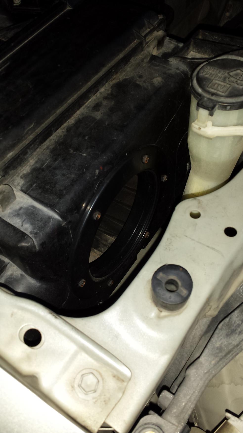

Deck plate mod is complete. Please pay no mind to the dirty engine compartment. I will address that issue when I tackle the leaking valve covers.

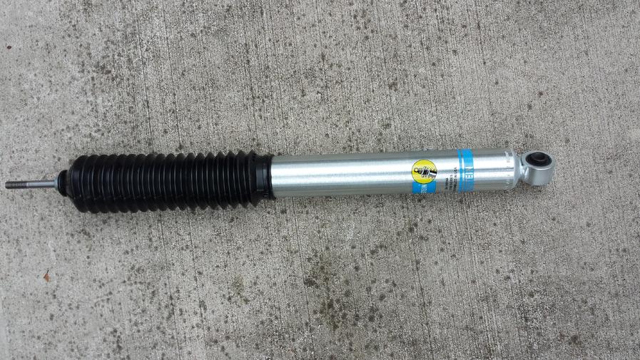

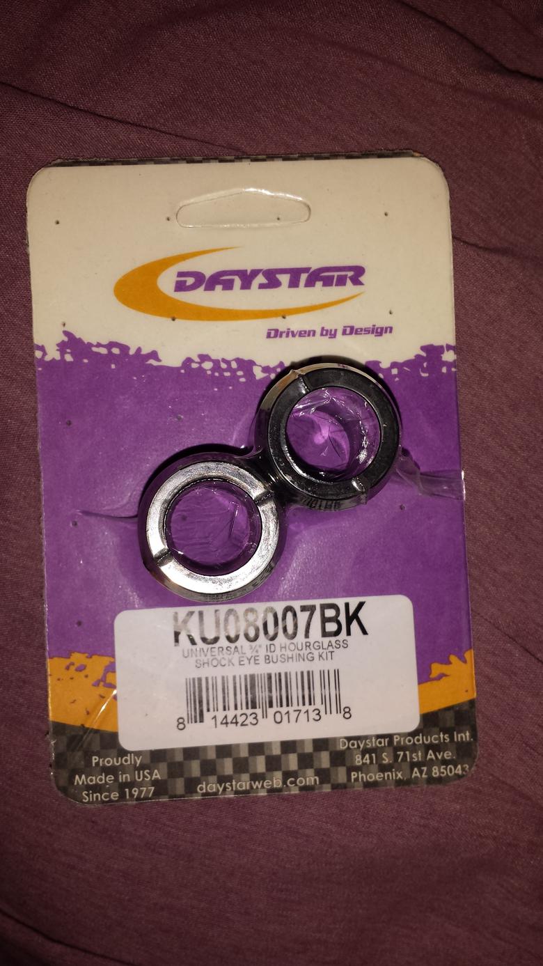

Tundra Billstein 5100's for front and rear and Daystar
bushing kit

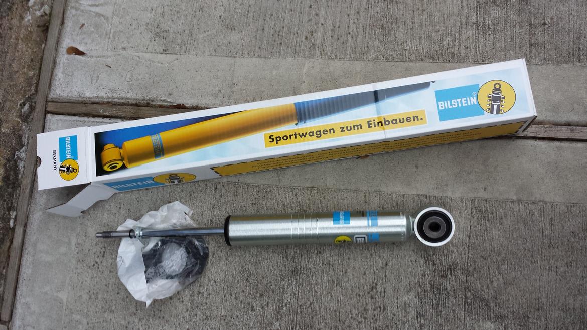

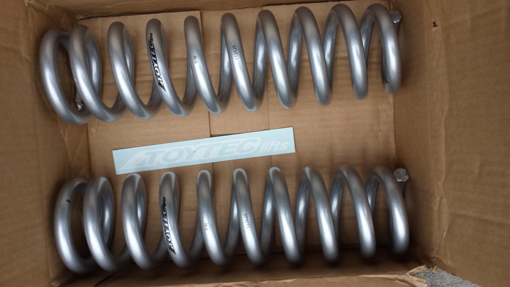

Toytec Eibach springs for front
LC coils for rear (Lexus LX470 - 8.75 wraps) not pictured

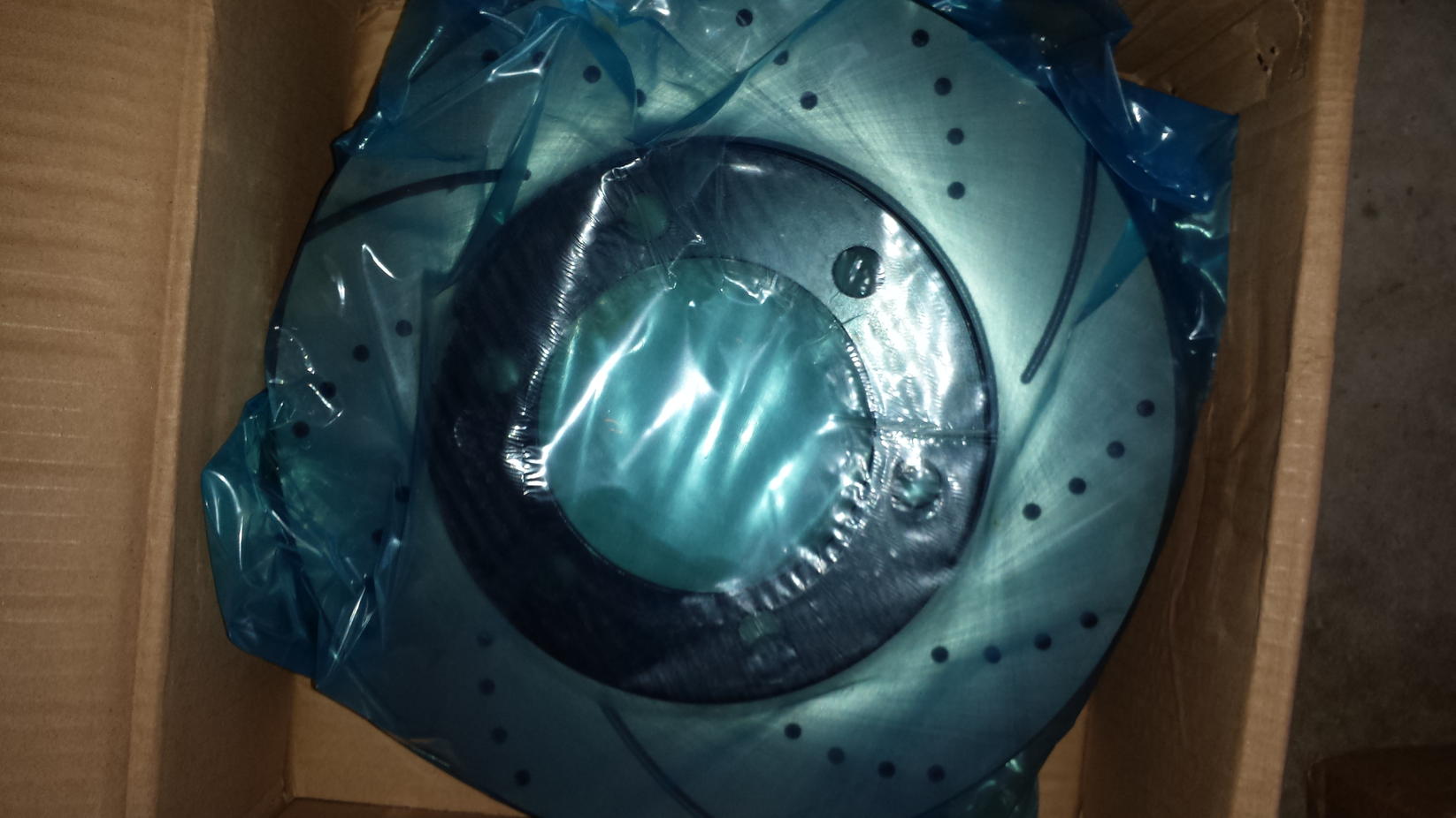

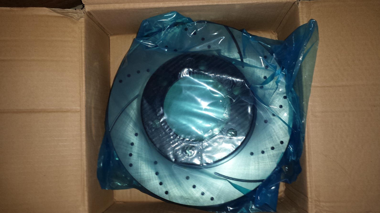

Cross drilled and slotted rotors for Tundra brake upgrade
Raybestos remanufactured calipers for both sides

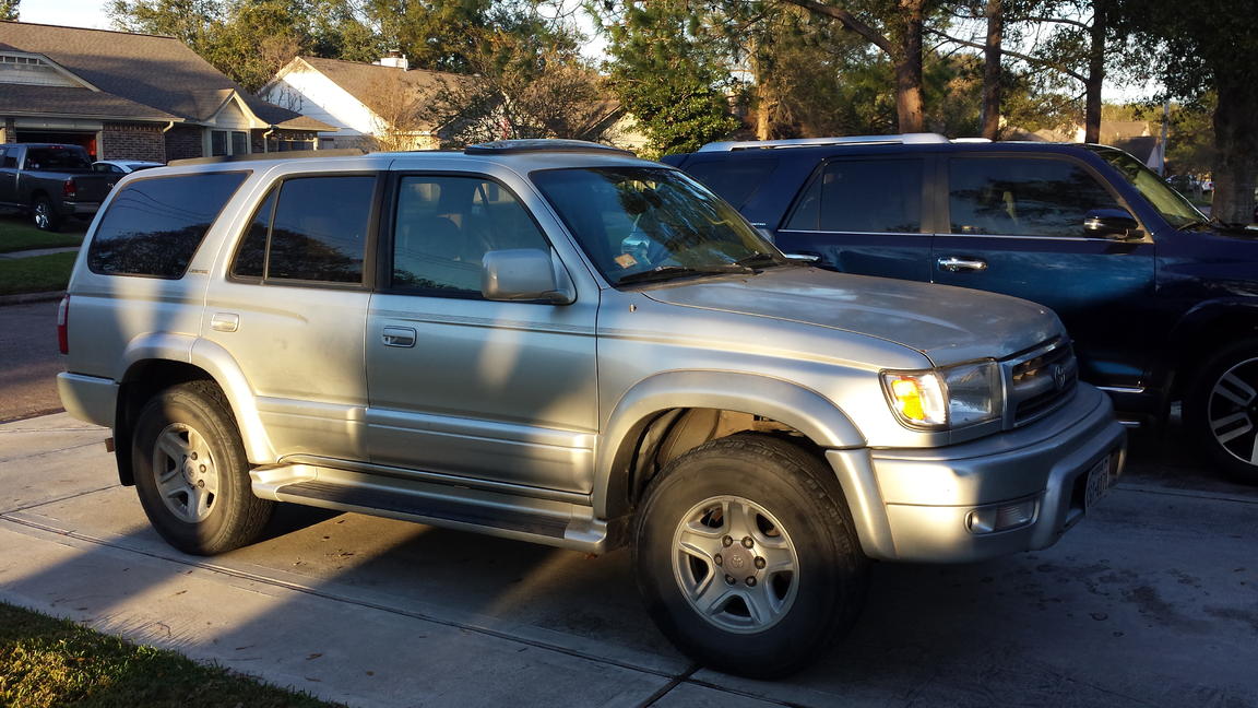

Hey - It looks like my truck minus the 4x4, hidden winch, running boards, roof rack, snorkel and blown V8...
Picture of my truck
