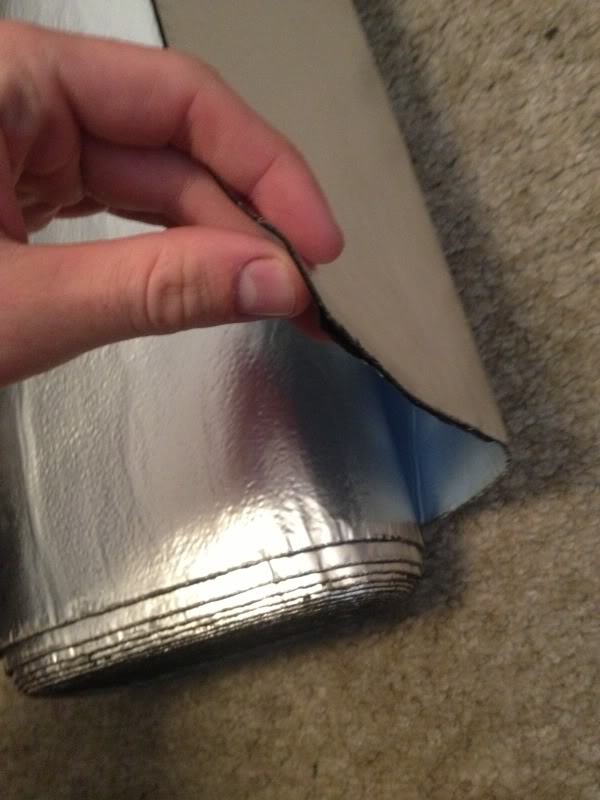

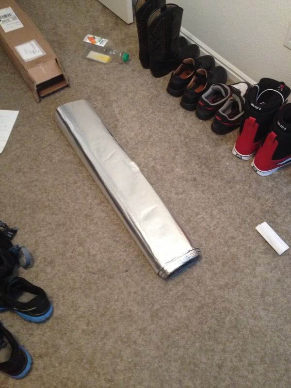

I also did this mod a few years ago back in 2007. After looking at your thread pictures I have concluded that the unlabeled "sound mat" you bought off EBAY for $65 is actually construction grade roofing liner.
I did a bit of research before doing a sound proofing mod and I decided to go with the cheap construction material myself. Well I walked into a local paint and roofing supply store to buy my matting and it came in the same 100 sq ft roll and had the same unlabeled silver lining. Back to your sound mat ... I am sure that you and I have the exact same material and I strongly believe yours is construction material just like mine.
Best sound mod for < $100 ever! I did the two front doors and entire interior. It has worked out great btw and the smell went away after a few weeks.

Yeah I know it was roofing material. But fit works amazing on stopping rattles from my subs
