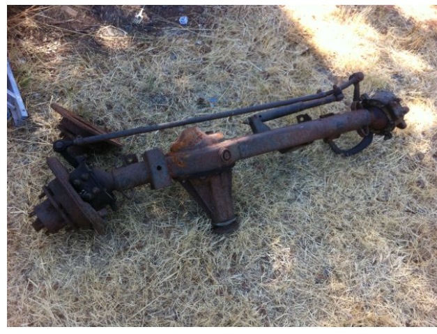

Jeramy New member Aug 2, 2012 #1 So I found a 1985 toyota pickup front axle should I buy it for a SAS in my 95 4runner it going for 100
Jeramy New member Aug 2, 2012 #4 this is what it looks like Attachments photo.JPG 135.6 KB · Views: 243
KidVermicious New member Aug 2, 2012 #6 With a wire wheel. But I'd get a look at it first and make sure it's all just surface rust. If it's eaten into anything, anywhere, I'd give it a pass.
fourwd1 Moderator Aug 3, 2012 #8 Surface rust isn't a problem. Don't worry about the brakes, steering, etc, if you're doing a SAS all that is going to be replaced anyway. And $100 is dirt cheap, they haven't been made since 1985.
H hoe_nah New member Aug 3, 2012 #9 $100????? Wow I'd be all over that. Lowest I've seen in my area was 100 for just the housing complete you looking at 300-500
92-SR5 New member Aug 3, 2012 #10 Yeah same here, they are worth gold around Portland. I'd buy it in a heartbeat!
