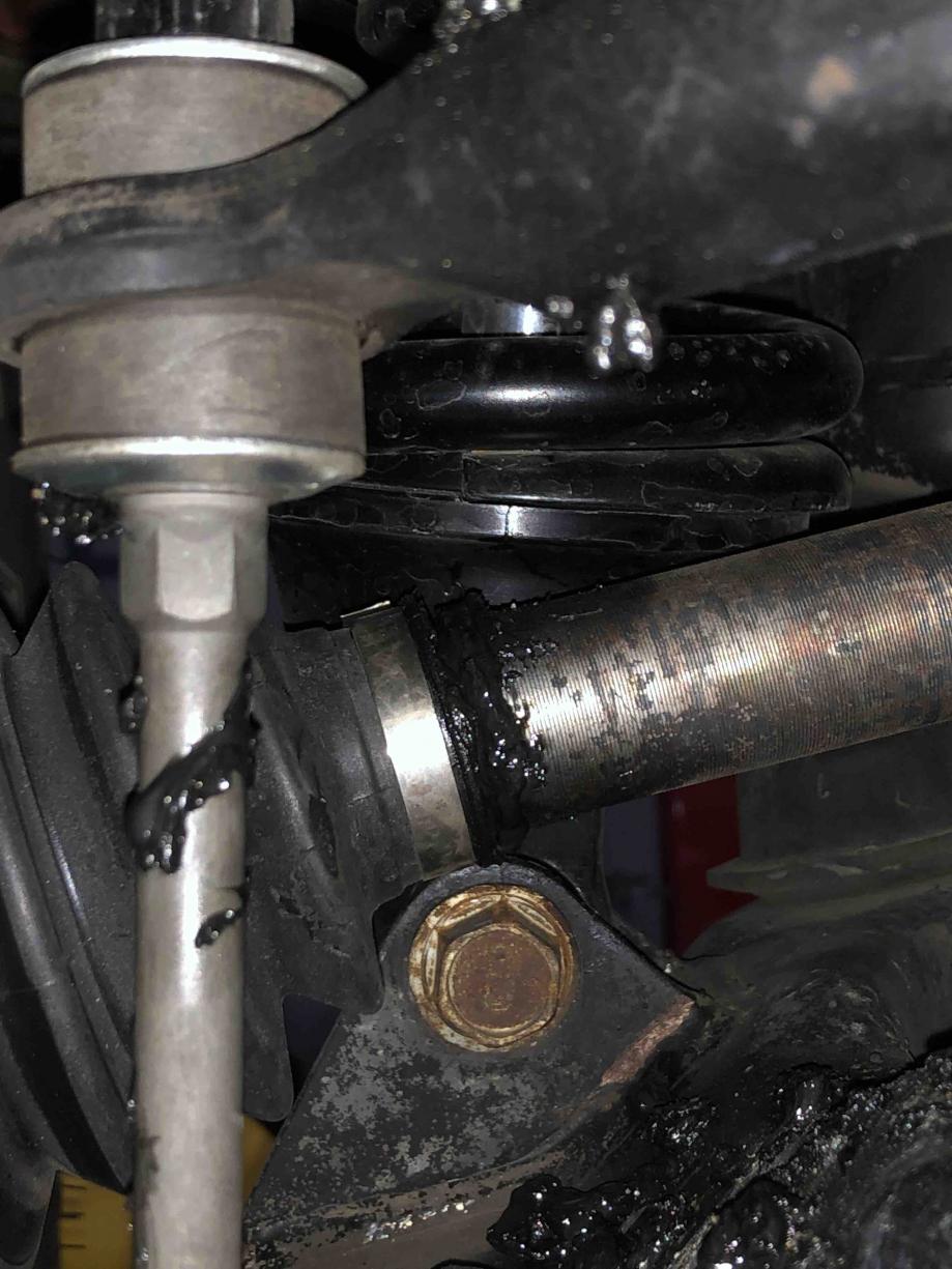

I just recently replaced both CV axels when i installed my icon coilovers. Both were purchased at Quest Autoparts.
One is starting to leak and its only been 500 miles.
One of my friends said wait until it gets worse, another said swap it since I have the warranty.
So now I seek the input of my fellow 4runner brothers.
it looks like the clamp wasnt tightened enough, and I was told I cant tighten it, I have to replace it if I want it fixed.
Thanks!

I would change it. Probably for a better quality one. Toyota does sell remanufactured cv that arent too crazy priced. I have new napa ones in Tetanus 1.
Sent from my SM-J337V using Tapatalk
I would return them and get NAPA axles. At the very least I would exchange it before it starts leaking more and getting grease slung all over the place.
You can cut off that clamp and put another one on and most likely do it while it's still on the vehicle. A good pair of dikes will cut the old clamp off. There are DIY CV Band Clamp kits. When I did a CV Axle Reboot video with [MENTION=102606]infamousRNR[/MENTION], we did a boot stretch mod and realized the OEM inner clamp wouldn't work for us to clamp the boot in a less wide spot on the axle shaft so we had to make a custom one. The first kit we used was made by Moog and it was a pain in the ass to join the clamp pieces. I have since found another kit that is much better.
These are the clamps I would suggest purchasing. Way easier to use compared to the Moog kit. Amazon.com: TJ Longda 20 Pieces SS Adjustable Axle Drive Shaft CV Joint Boot Clamps 48mm and 120mm: Automotive
Here’s a link to a Good Pair of CV Boot Clamp Pliers. There are crappy pliers out there but this is a quality set made by Lisle: Amazon.com: Lisle 30800 CV Boot Clamp Pliers: Automotive
They make quite a mess in due time!
I recently had my CV start splattering after I lifted my '98. I tried replacing the band, and that made it worse --- one short test drive on pavement and the boot came loose and made a HUGE mess.
I vote take it back since you have the warranty and get a better one. I went for NAPA for mine.

mine did that for about 6 months from the inner edge with the stretch mod. couldnt find a clamp that worked all that well and had just ziptied it as tight as possible. well i cut those off and put on heavier duty double zipties and it seems to be holding for now... or im out of grease... tbd.
i keep spares just incase but zero signs of needing them so far.
it just looks like the boot is burping. as every stated you can clip it and seal it up better. make sure you clean off the excess grease and watch for future burping. i can attest to how much of a mess they make if you dont clean up/take care of it now; grease gets flung EVERYWHERE.
if you arent buying OEM axles, in the future i recommend new NAPAs. theyre 83 a side with no core charge and a lifetime warranty. users on here have reported successfully being able to swap them out when their boots tear (and of course when they actually break). you just need to keep your original receipt.
the center shaft also looks a lot better that what you have currently (although its not something i would worry about right now). is what you picked up from quest a new axle or a rebuilt one?

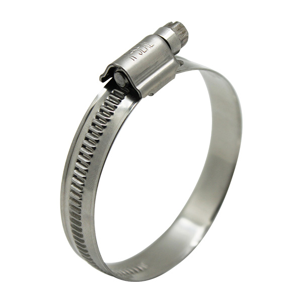

I ended up using worm clamps similar to these. Then that way if it starts to leak out I just wipe it clean and tighten it down a little bit more. Mcmaster carr is where I got them from. These rigs tend to love tearing rubber boots after they've been slighly lifted. At least that hasn't happened yet.
Even so theirs still plenty of grease inside the knuckle/housing. I've repacked my passenger side twice and driver side once and their still fine.
This is a brand new axle. When I went to napa they said they had new ones in stock and didnt. So my mechanic friend said quests were just as good as napa.The other axle is holding up perfectly.
I didnt look hard enough, but these can be tightened?
Sometimes yes. I had one on my 09 Tocuma leak grease was under warranty. The dealer fixed it. 2 months later the boot leaked again. Toyota replaced it the axle. Never leaked again.
cv joint
are those the clamps that came with the axle? I got mine from napa and they look different. I would wipe off put new clamp on if it still leaks you have your answer
I’d just use the worm drive clamps linked above. I bought one off eBay when. I boot started leaking after my lift. Removed the OEM clamp and put on the worm drive hose clamp, hasn’t leaked since.
That's the answer I needed. Thank you lol
I wasnt sure if a new clamp would work well enough. But I have my answer, thank you!
