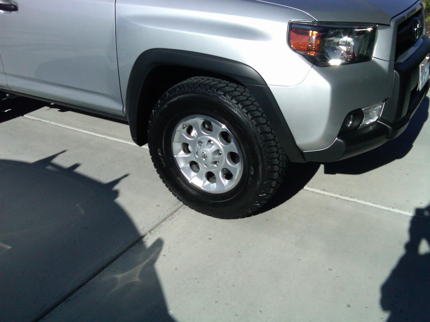

Yes, a 285/70R17 will fit on a stock Trail Edition (no lift or spacers) provided you do the wheel well mod LWN described on page #1 of this thread. This was a super easy mod to do while the truck was on the lift at the tire shop. Once you trim a little plastic away to allow the plastic wheel well liners to move forward ~1/2", I'd recommend running the screw directly through the plastic to ensure it stays in place.
I mounted a set of 285/70R17 Goodyear Silent Armors a month ago on my TE and they are working like champs so far. No rubbing that I've experienced so far (with 3k miles on them now). I will say that I haven't taken them off highway yet so the suspension hasn't seen full travel at all, but so far, so good. The only potential rub issue I see under full compression would be on the passenger side -- Toyota conveniently mounted the windshield washer reservior on at the front of the wheel well (eventhough there is ample space under the hood to have placed it elsewhere). It is the only thing that prevents moving the wheel well liner forward any further on that side.
Last thought, Goodyear does make these 285s in a P rating for those that aren't hauling heavy loads and want a "smoother" ride compared to an E rated tire. Also, the P's were a bit cheaper (and lighter) per wheel. I do have my eyes on a set of Duratrac's once the snow starts falling in a few months, though I had Silent Armors on my old 2002 T4R Sport and they got me up and down Little Cottonwood with ease on snorkel days at Alta and the Bird...
All that said, here are some pics:

No offense, but those tires on those wheels remind me of a ballerina wearing football cleats. Maybe if you put the white letter in they might look better. The sidewall profile is too small as it is!!

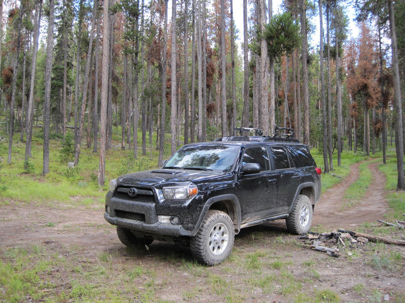

Here they are at 11k:
Like Harper said, they are at home off road. However, I once swerved violently on the freeway with them and was able to regain control. They are certainly no street tire, but they do OK. I recently loaded them up to 45 psi from 32, due to reading on another thread about LT's. I managed to get 20 mpg at one point, which is up from maybe 17.5 at 32 psi. I have taken them on many long drives. Last week, I took them up to the Tetons and Glacier. Drove for 7 hours back in constant rain and they were ok around 70 mph on Montana backroads.
I will get them again, they are very strong, though I was also considering the Grabber's for the sake of fuel economy at one point. My plan is 305's with ATX artillery wheels once these wear down or I can sell them.
