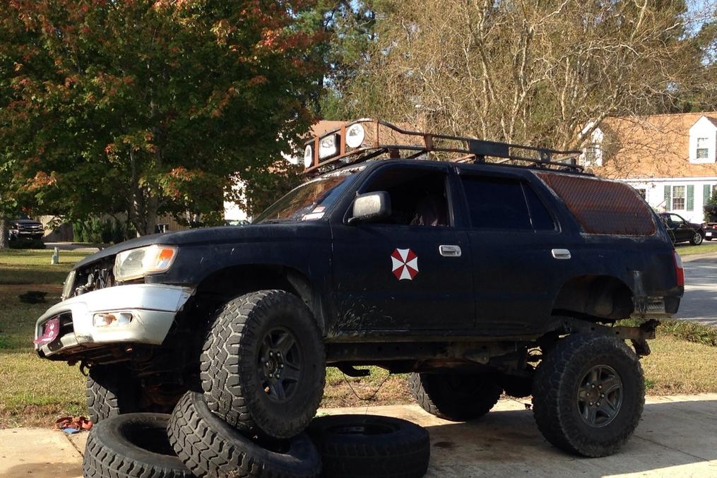

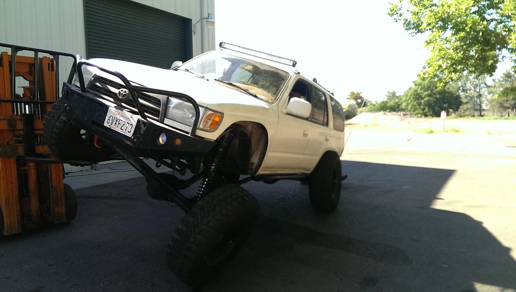

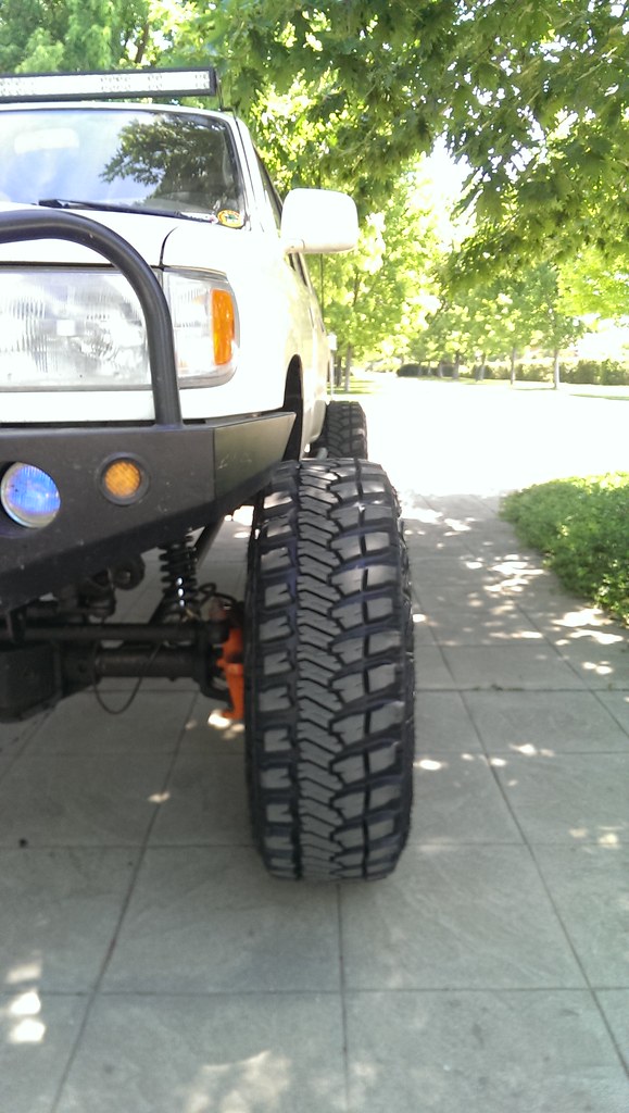

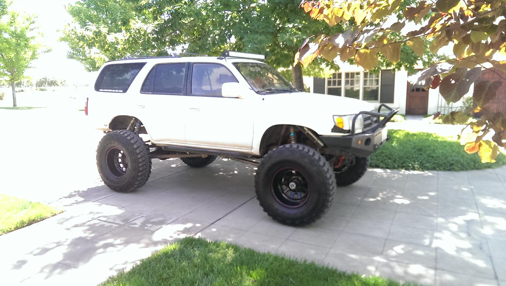

IFS on 35's to SAS on 37's HP44/9" ARB's F/R, 5.13's, Reid's, 3link/3link, 12" and 14" coilovers. Still so much to do.
http://www.toyota-4runner.org/3rd-gen-t4rs/74558-downpour11s-build-thread.html

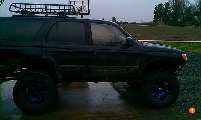

From This:
IMG_0087.jpg~original
To This:

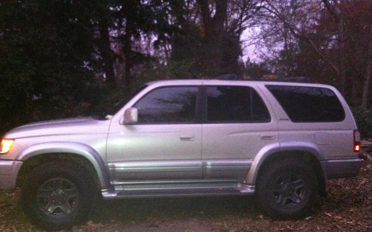

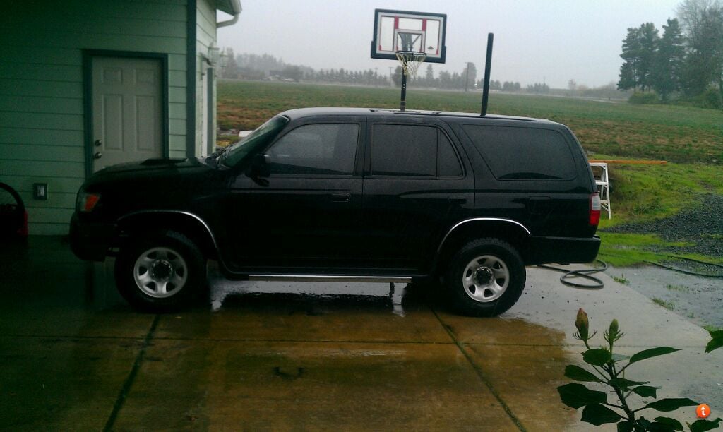

Mine isn't as impressive or the typical off road type that the majority of you guys are going for but I made my red '98 SR5 with brown interior into a black '01-'02 Sport Edition with a black interior.
Here are the only before pictures I have of it, in front of the jetta.
<img src="http://img.photobucket.com/albums/v202/zacattack20/4Runner/First/IMG_0347_zps7a6d5909.jpg" border="0">
<img src="http://img.photobucket.com/albums/v202/zacattack20/4Runner/First/IMG_0352_zps59a8398e.jpg" border="0">
And After.
Exterior
<img src="http://i1350.photobucket.com/albums/p779/zacforsale/IMG_2284_zps5634a35b.jpg" border="0">

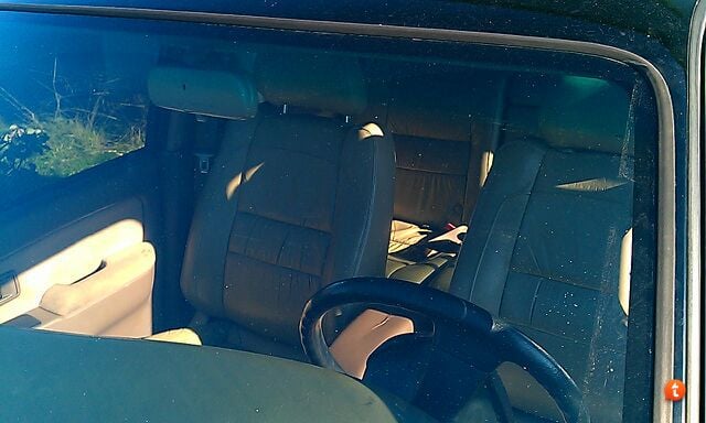

Interior
<img src="http://i1350.photobucket.com/albums/p779/zacforsale/B920D34D-5BE4-4331-8E6B-1D955CC457F7_zpsbhbbgkbm.jpg" border="0">
And the push start just because I doubt there is any other 3rd gen with one.
<img src="http://i1350.photobucket.com/albums/p779/zacforsale/photo_zpsbc86a94a.png" border="0">

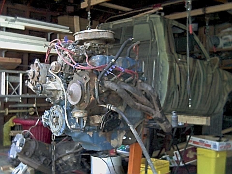

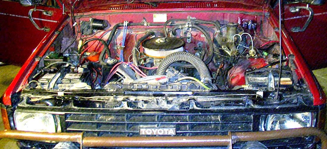

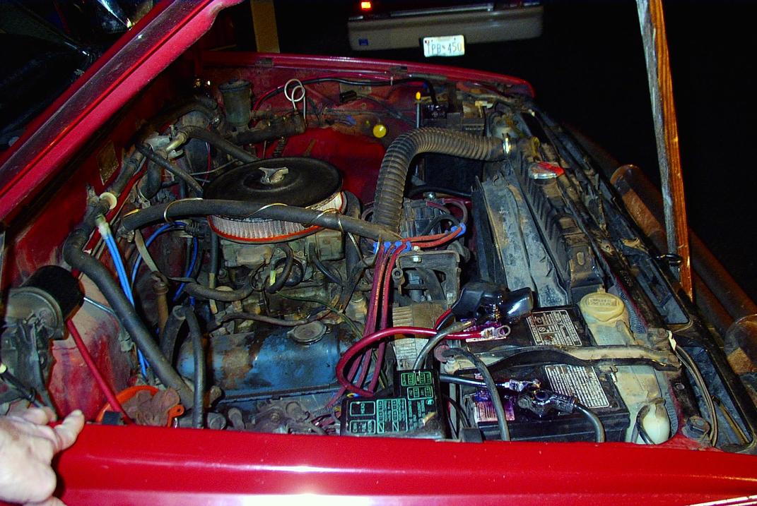

I lost most of the pics of the Buick V6/TH-350 auto trans swap in a computer crash. These are some from the later frame and body swap.
Top to bottom:
Engine compartment
231 V6 on engine stand, TH350 trans in background

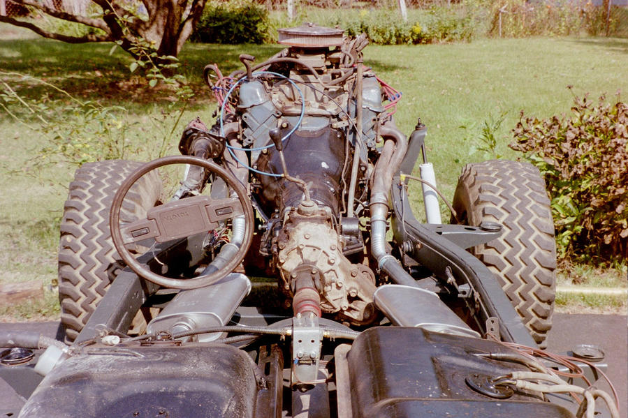

Rolling frame ready for new body (84 2WD)

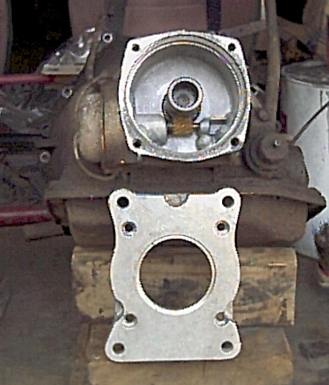

TH350 with t-case adapter plate ready for install

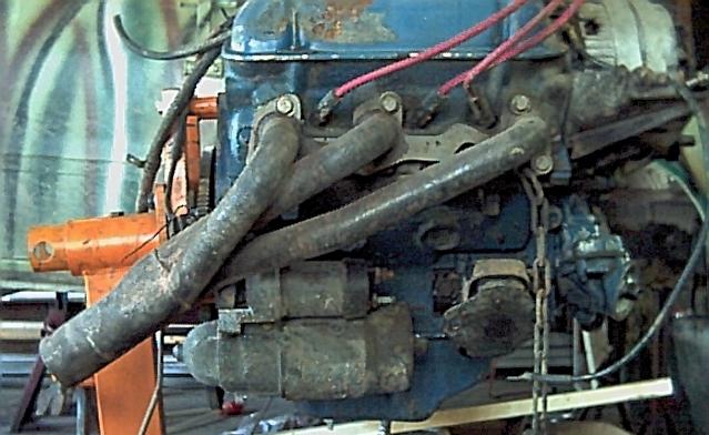

V6 with Downey headers

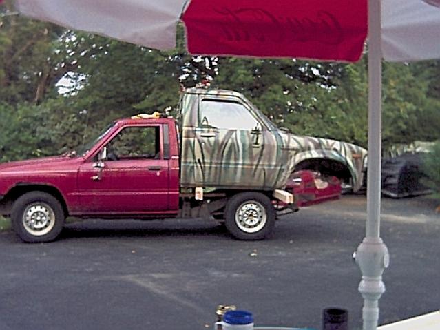

old 83 cab ready to come off
double cab

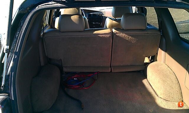

Here's how my 97 started out.
First thing was a complete interior conversion, from gray to tan.
That included swapping seats from an infiniti QX4 in.
Did the 4wd conversion with manual hubs too.
Working on making it look like an 02 Limited one thing at a time.
Apologies for the not so good pics.

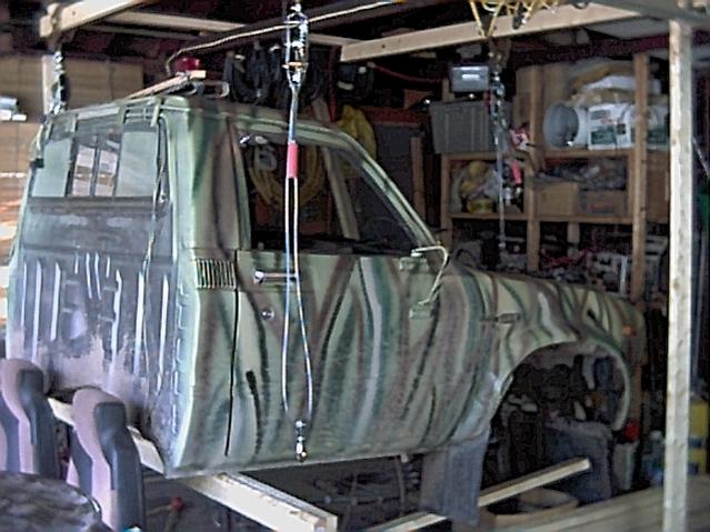

84 4runner.
built before forums existed and so not a lot of documentation. But it is about to go through its next evolution.
A body swap,
5.0 engine swap,
AOD trans with dual case swap.
Rear axle swap,
interior swap.
Full Cage
LOL basically the frame is all I'm keeping and the Tires of Course. Be watching here for updates

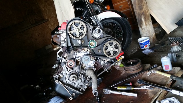

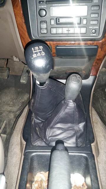

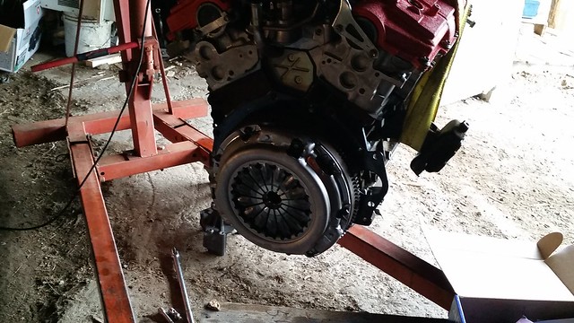

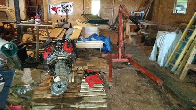

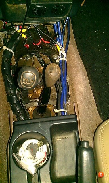

So just some quick details on it.

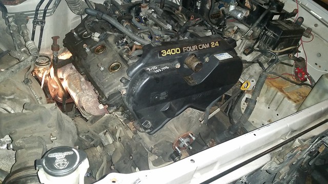

My motor had been missing for about 8 months on 2 cylinders. Badly. Had horrible compression. And being young and stupid, I bought it with excessive blow by not having a clue what it was pr where it would end up at. Anyways....
Got a jdm motor, from jdm engine zone out of clifton new jersey. Pir hased on ebay via the make an offer option. Basically got it for 1250 shipped to western pa. Pretty good to deal with. Good communication on ebay. Extremely fast shipping. 3 business days from purchase and it was in my garage. And kost importantly a great motor.
It was from a hiace mini van so some parts needed to be swapped, which I got from the donor 4runner. Things like the ac mount, the fan pulley, the oil cooler, the exhaust manifolds, and the throttle body. Did this without my 4runner being down wjich worked out great.
I swapped the 5 speed in at the same time. Really quite simple, especially when already pulling the motor. Went with a new aisin clutch kit. I also switched from a push buttin transfer case to a j shuft transfer case. Wiring was easi, y the hardest part, but was really jot hard at all. Just took time and patience. And the exact wiring diagrams. [MENTION=84972]danthemanx07[/MENTION] AND [MENTION=10169]TheDurk[/MENTION] were instrumental in helping me here because I had never tackled something like this. But really with there help to bounce ideas off of, its not hard to figure out at all.
Anyways here are the pictures.
20140512_183450 by zgensler31, on Flickr
20140512_183414 by zgensler31, on Flickr
20140509_183454 by zgensler31, on Flickr
20140501_173305 by zgensler31, on Flickr
And the money shot!
20140522_220437 by zgensler31, on Flickr
Afterthoughts.....its amazing and well worth it. My 4runner no lpnger shakes like an 80's diesel. Its got power. It doesn bog out on hills. Thw five speed has gotten me up to 18 mpg while driving it like a sports car. Its actually quote quick now with the manual. And it is sooooo much fun to drive.
Every time I get in and drive it around I am still amazed that I pulled this off. I didnt screw it up!
Huge thanks go out to [MENTION=10169]TheDurk[/MENTION] and [MENTION=84972]danthemanx07[/MENTION] for there help. Truly insteumental and couldnt have been done without you.

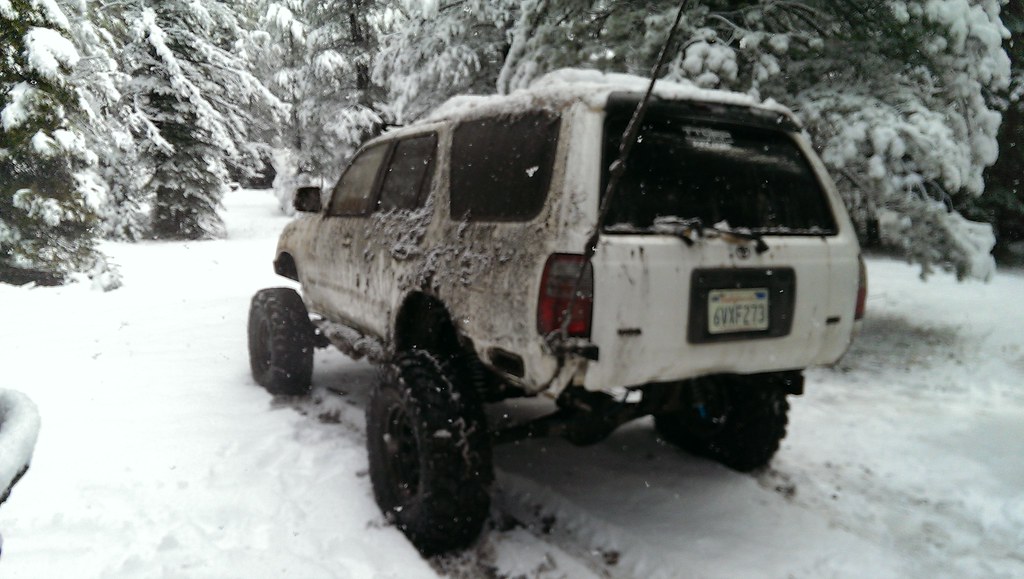

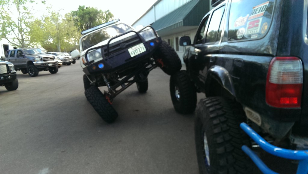

Ok I'll play along. Mine has been through a few changes. haha
How I bought it...
Most recent pics...
If you can't beat em, join em! :love:
