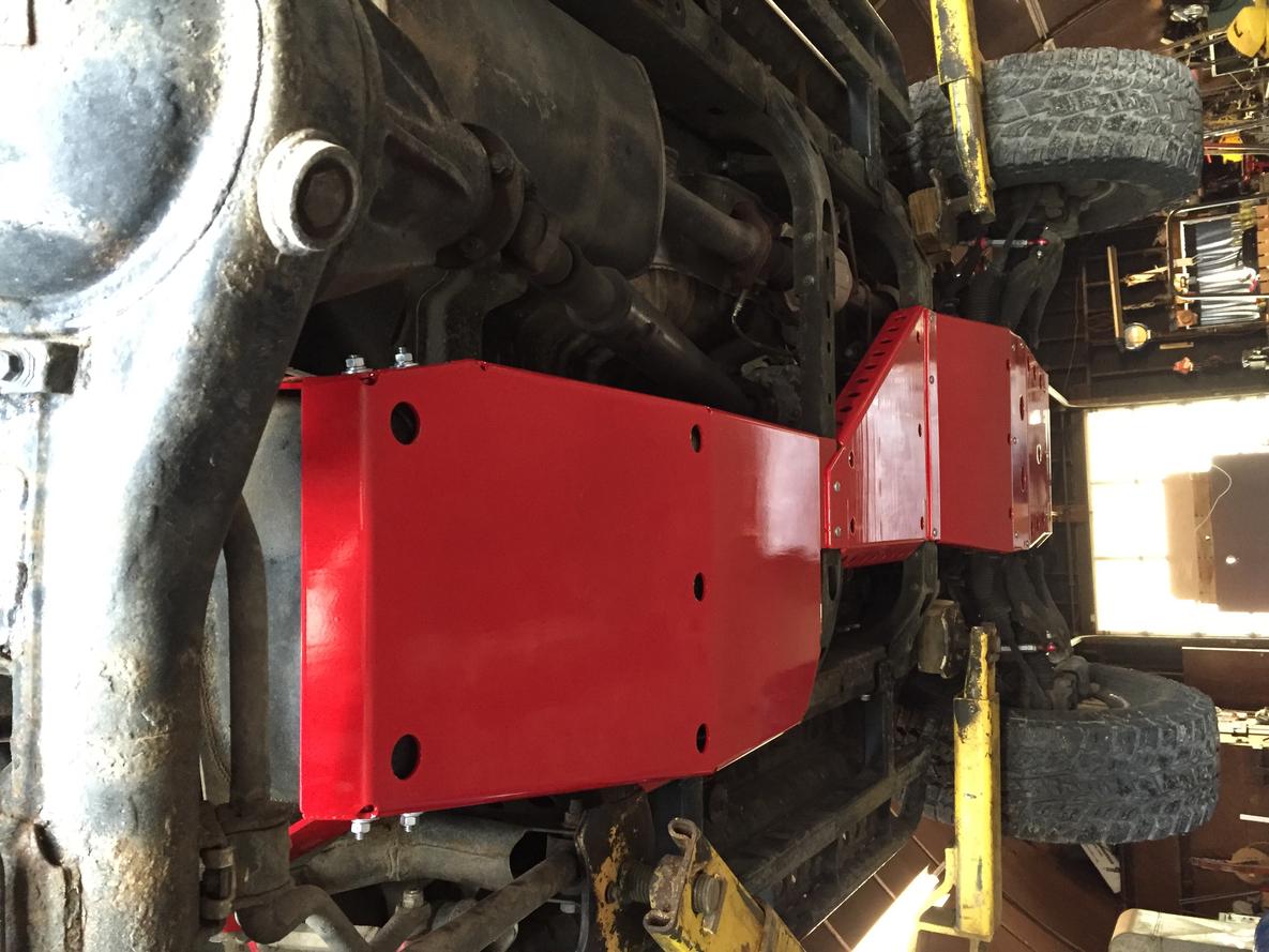

Installed!
Finally got some time to get these all on, thanks Shrockworks, these are quality, can't wait to put them to work!
Heres a pic from the other end...starting at the gas tank skid! I loved this kit...all five pieces! Very easy to install. Looks great...can't wait to abuse them this summer :lol:
