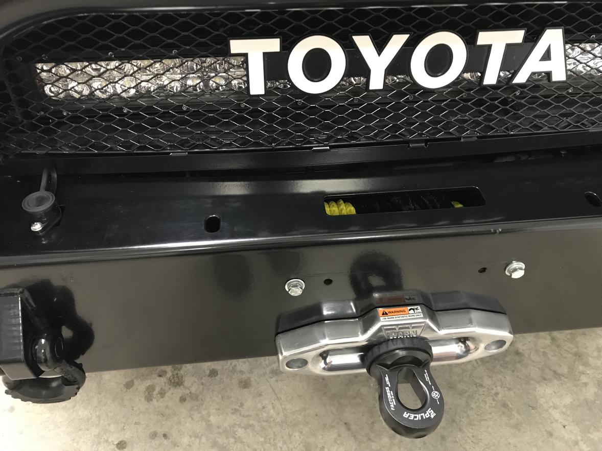

Sorry for the duplicate pics since I already posted in the "What did you do to/in your 5th Gen" section, but I got to thinking it would be good info for this thread.
So I came across a great Craigslist deal on a brand new Warn XD9000 for $500. I also found Dyneema synthetic line (3/8"x90') on Quadtratec for a good price. Their yellow line was on close out for $150, can't beat that. It came with a tube thimble and a ridiculously large hook, so I decided to get the new Factor55 Splicer and splice the line on myself. The Splicer is nice since there are fewer parts to fail and they are typically safer than hooks.
As mentioned above by [MENTION=78273]Jeremy556[/MENTION] , it was absolutely necessary to remove the bumper to install the winch. Even if I was able to squeeze the winch into the bumper while it was mounted, it would have been very tedious trying to get the winch bolted up while the bumper was on the vehicle. Also, the mounting of the winch solenoid would have been damn near impossible since this required me to drill two holes.
I mounted my solenoid box on the angled sheet metal that is just below the grill, towards the passenger side, running perpendicular to the radiator. This is where Shrockworks mounted theirs in the install instructions http://oneping.net/instructions/5th Gen 4 Runner - Front Bumper Instructions.pdf
Since there is a hole to mount it on the top of the bumper, and since it would be a pain in the arse to plug the remote in while the solenoid box is hidden behind the bumper, I purchased the Warn 2' extension for, gulp, $45. https://www.amazon.com/Warn-14867-WARN-Socket-Extension/dp/B001PJS6QK
I ran a bead of clear RTV silicone where the extension plugs into the solenoid box just to make sure it is water tight.
All in all this was a straightforward install. Removing the bumper was a piece of cake, but I used an extra set up hands to mount it back up with the winch installed. I also took my time running the wires. I wrapped them with wire loom to protect them and used plenty of zip ties.
Anyway, here are a couple pics.

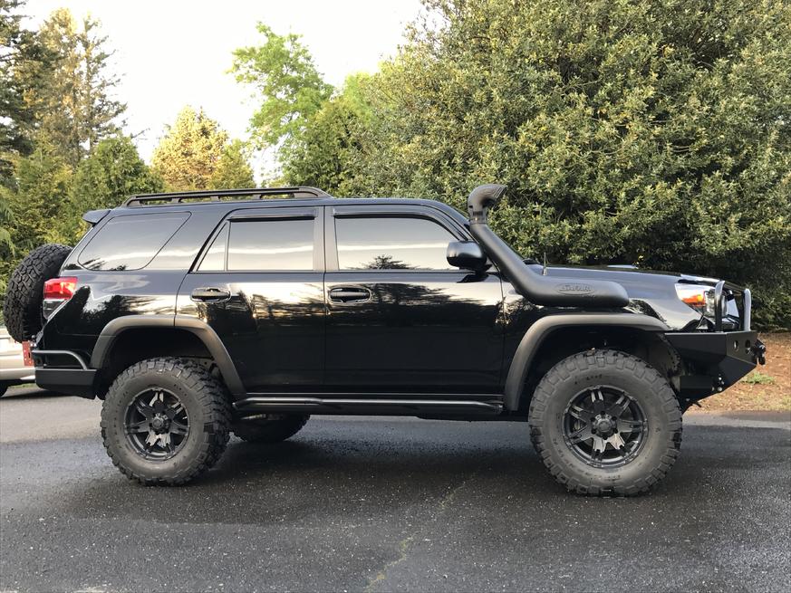

Can you post me some sideway pics of the rig please, I have a rake from the bumper :/ I need to find a solution as a next upgrade hehe or get a rear bumper to even things out but that's not this year for sure lol ! Also will need some new UCA's which are killing me in the price range fml ......
I'm not at home but here is the rig without the winch installed. I'm going to crank up my coilovers a bit to counter the added weight. I've got about 2" of forward rake going on. When my Icons need rebuilt I will go with the 700lb coils. It will handle the weight better and keep the preload down.

So you are already running OME 887's? What rear coils do you have?
OME 889 with Nitrochargers also. What options do I have to get more lift in the front ?
Your rear 889 coils are giving you 3" of lift instead of 2" like it says in your sig. From the factory, you have about a 1.5"-2" forward rake. So, with 3" of lift in the front and rear, you are going to maintain the same amount of rake. With the weight you have in the front, the coils may start to sag a bit causing more rake. You could use a couple trim spacers with the OME's, but you are still going to have some rake because you shouldn't lift the front more than 3".
You could get some OME 895E coils which will provide about 2" of lift in the rear. This would get rid of some of your rake but it will lower the rear obviously.

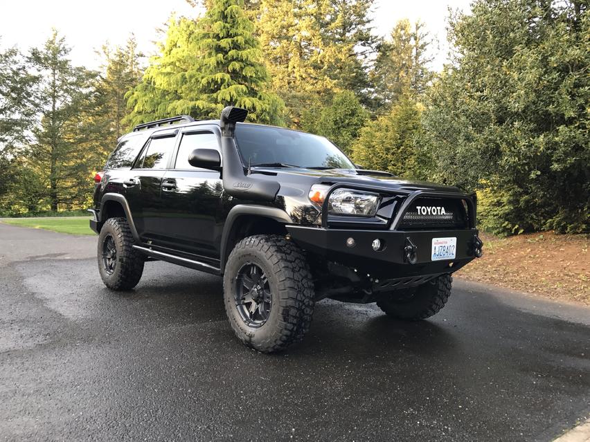

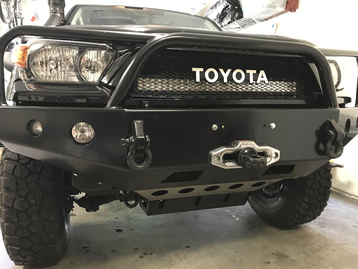

Here it is guys :)
Installed it last week ! I would like to give a BIG thanks to Mitch from Srockworks. I talked with him a couple of times and he was very nice. I was missing the turn signal lights and when I called him to let him know. He sent it out the same day express mail. I got my lights 2 days later !
The build is solid. Great quality and fits real nice. Here it is guys ! I also went all out with OME Heavy duty coils in the front with all out Nitro Chargers shocks front and back. I kept the medium duty OME coils in the back because I already have the airlift 1000 and I felt like I didnt need them right now.
Tje ride is definitly stiffer and I like it like that :)
Also got a winch in there hehe.
Now I just need to find some places deep in the woods and get down and dirty lol as the truck is already full of scratchs front small hunting and fishing trips
