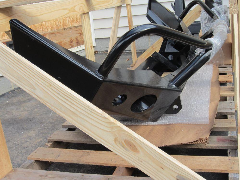

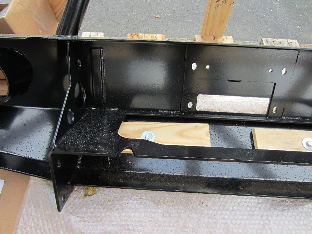

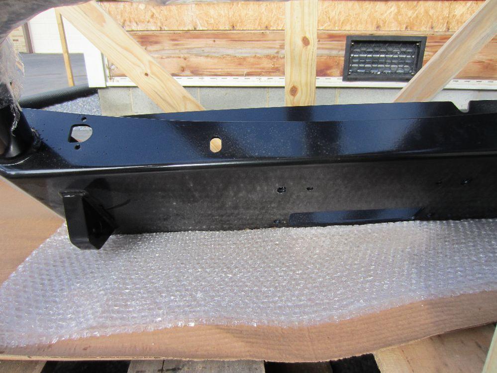

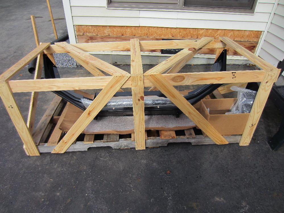

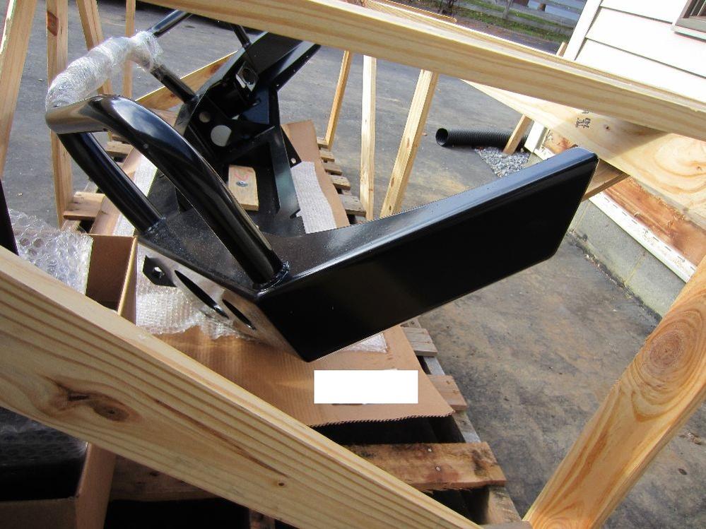

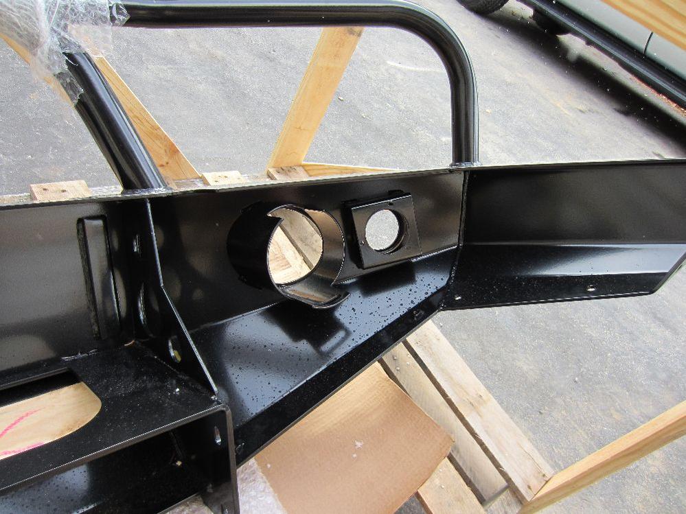

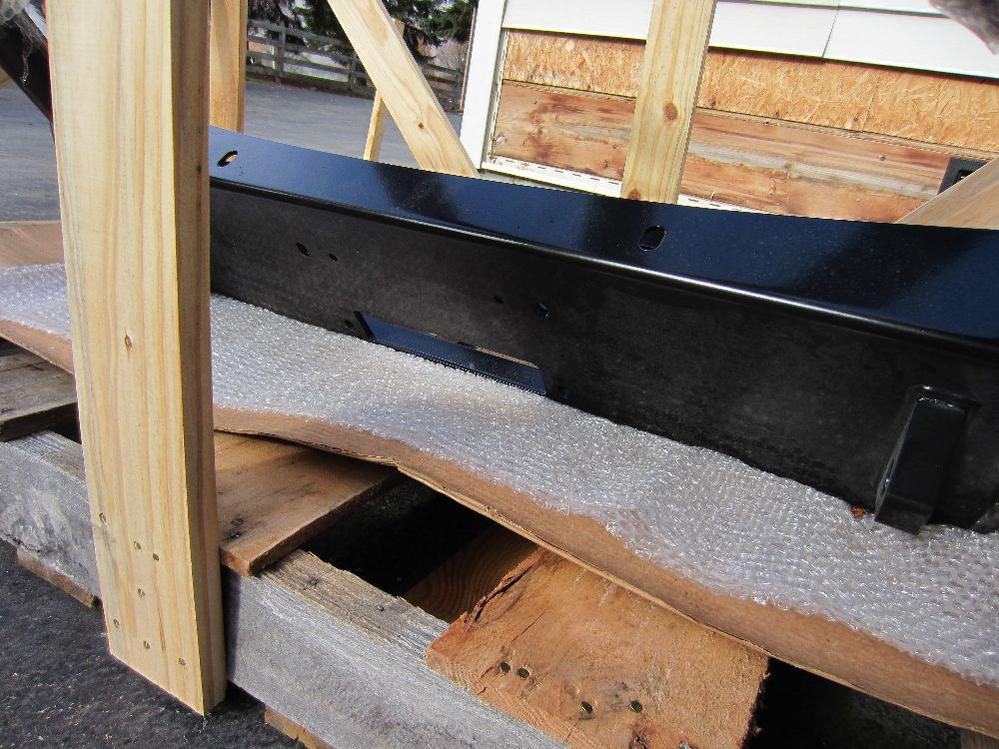

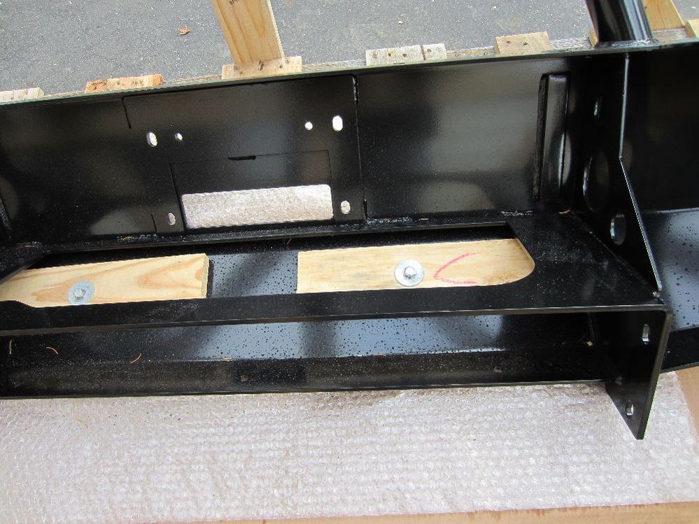

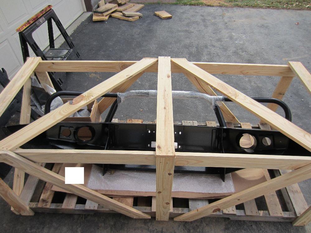

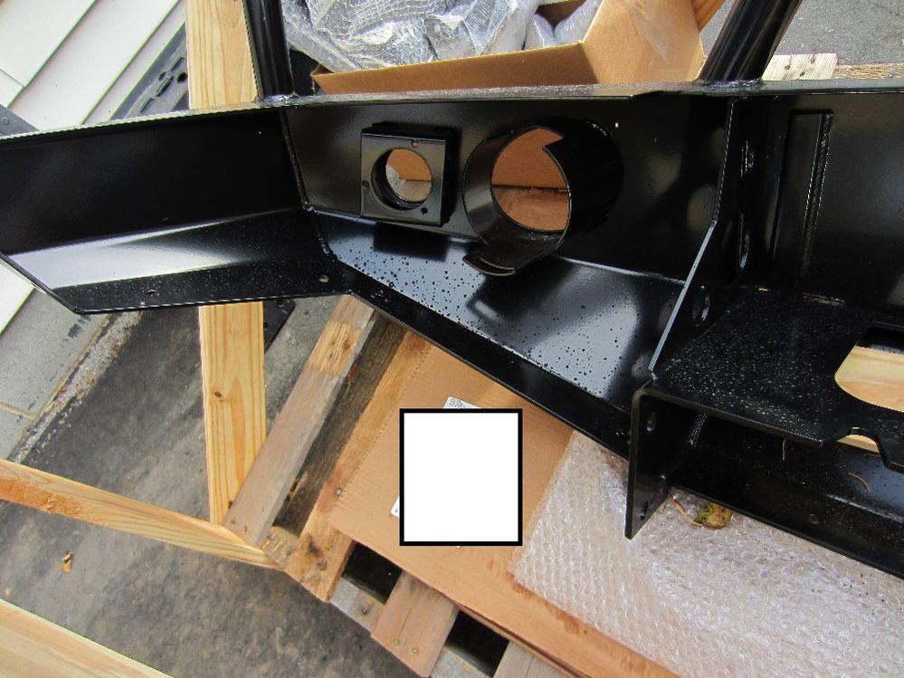

Bumper still bolted to pallet, everything else removed from the crate. This should give a good idea of how the bumper is built.
Note you also get the following:
-bag of hardware
-winch solenoid bracket (big L bracket)
-Hood release helper (looks like a U), packed with:

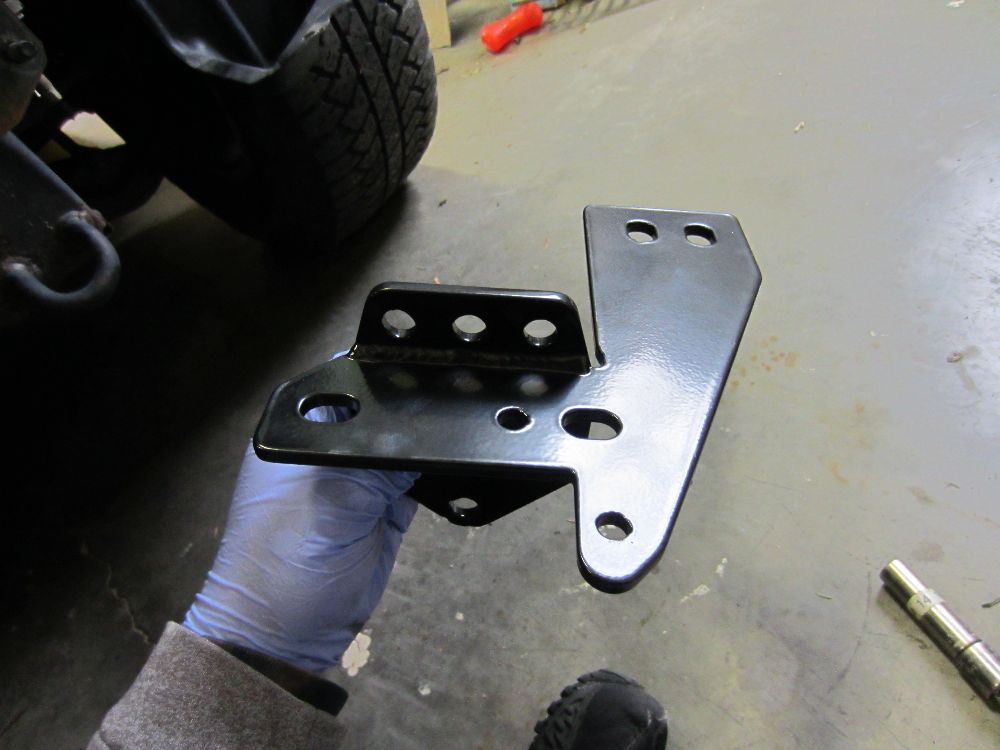

-A/C line elevation bracket (about 3/4" by 1.5", three holes)
-left and right frame mount brackets
-left and right bottom shields (covers washer bottle,etc)
-replacement turn signals that mount into the small holes. I did not install them as my 2007 has turn signals integrated into the headlight assembly. (Edit: These are Hella units that use GE 2357NA bulbs. I think that the lights are 2BA 008 947-00)

Two more of the bumper in the crate.

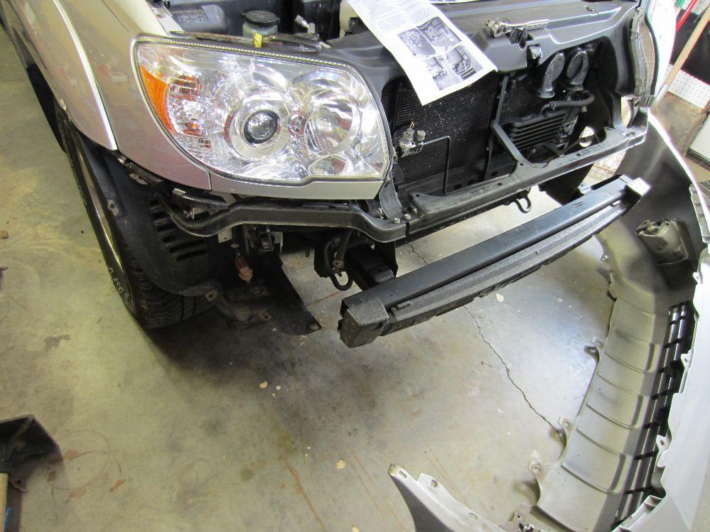

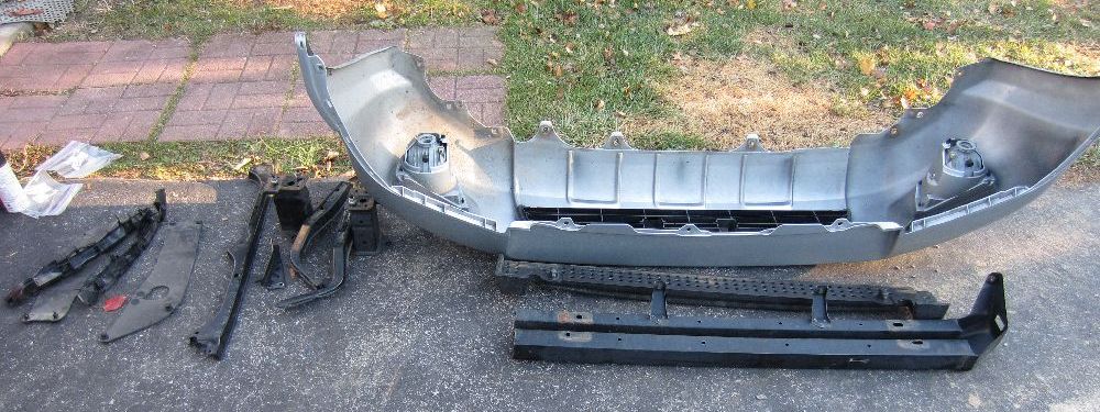

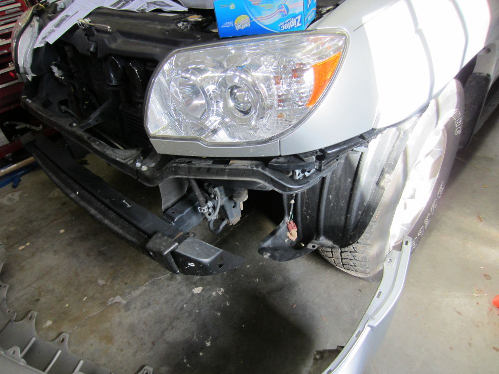

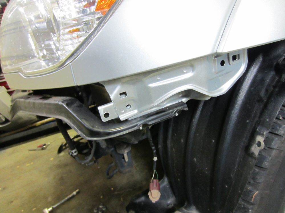

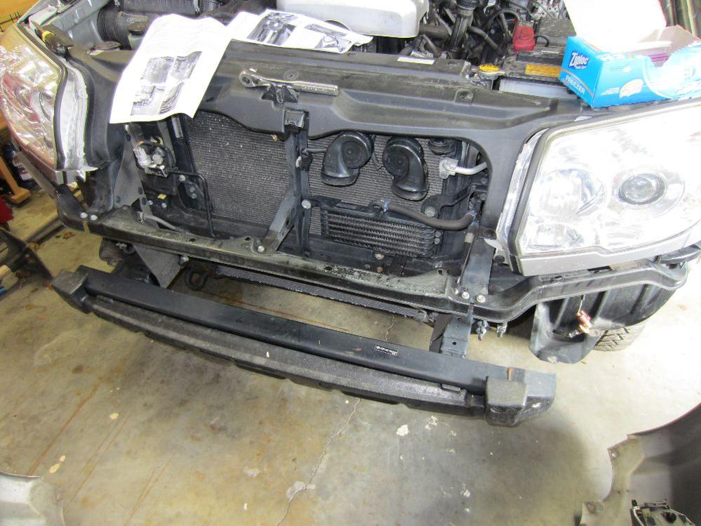

After removing front bumper cover.

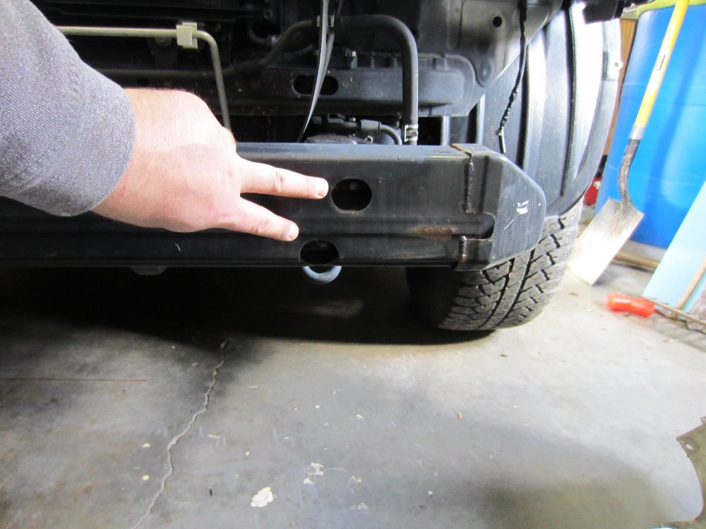

Location of 2x14mm nuts each side to remove bumper and styrofoam. Note these may be rusted and you may have to penetrate w/ WD-40 or equivalent.

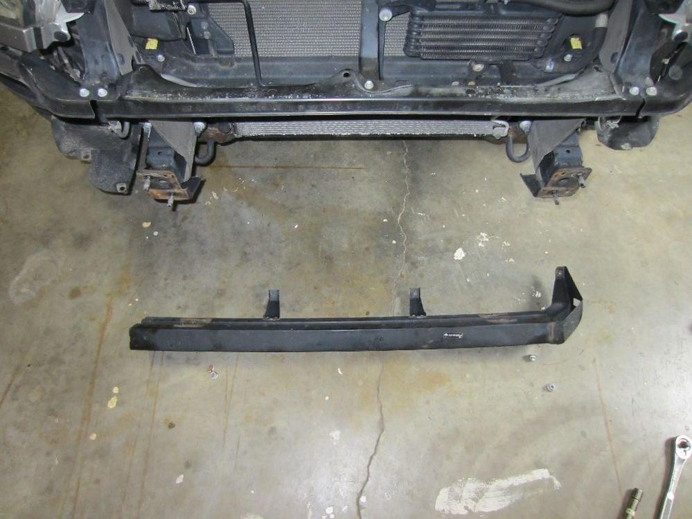

Front bumper beam after removal.

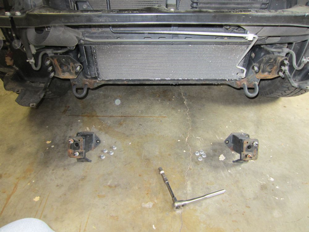

Driver's side bumper beam bracket to remove with 4x14mm nuts.
After removing bumper beam brackets.

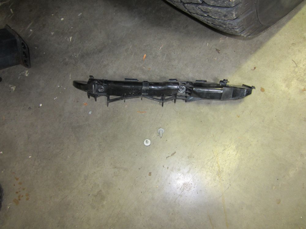

After removing black plastic brackets from leading edge of front fenders. 2x10mm each side.

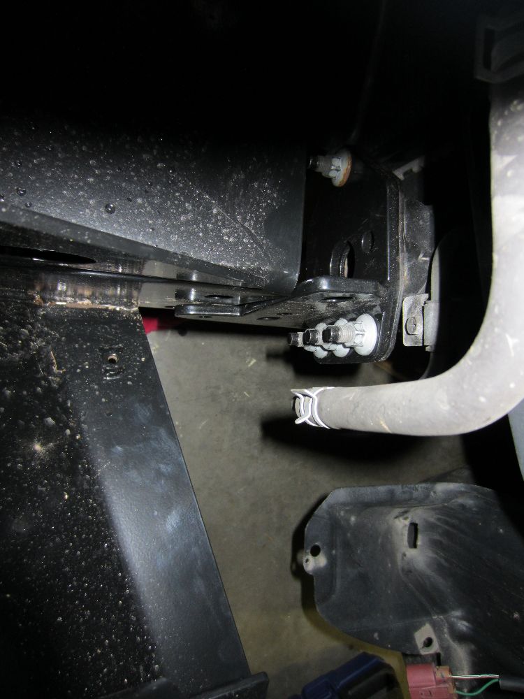

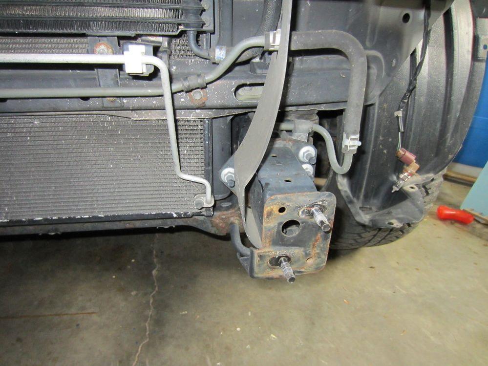

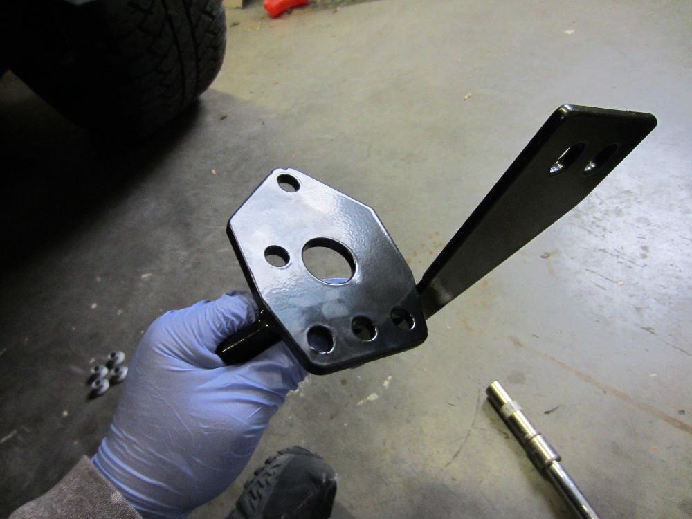

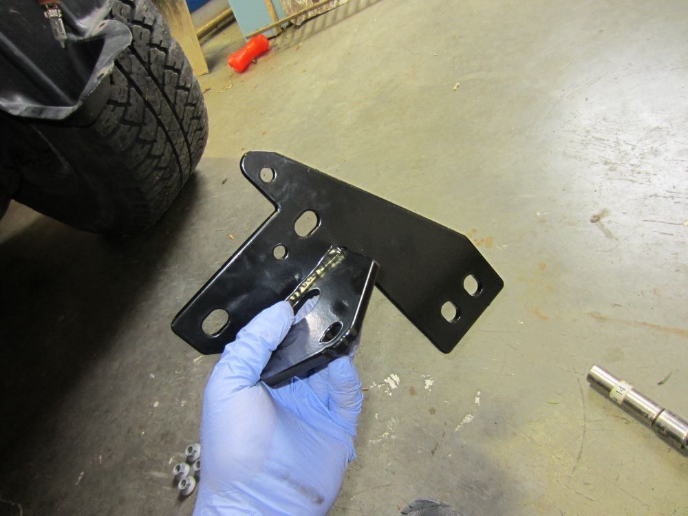

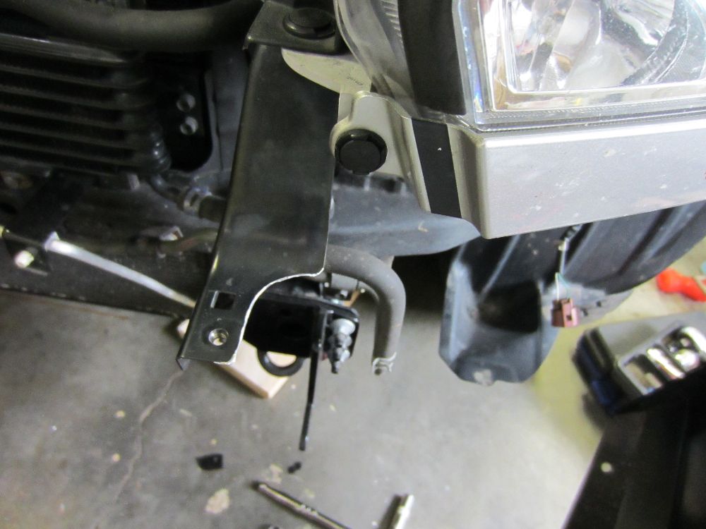

Driver's side bumper to frame bracket. Passenger similar.

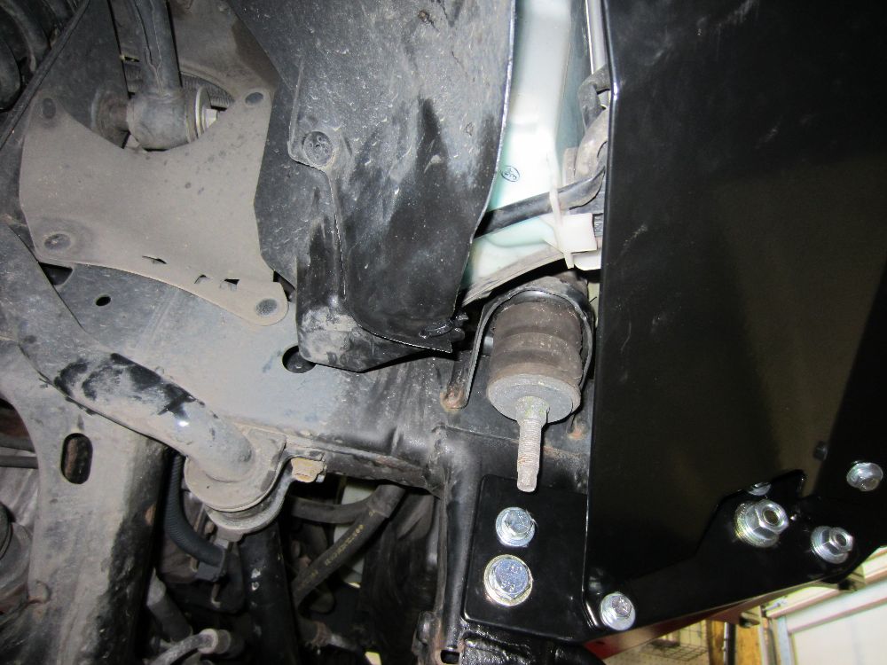

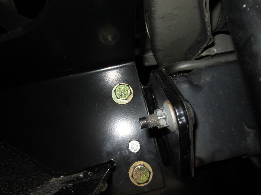

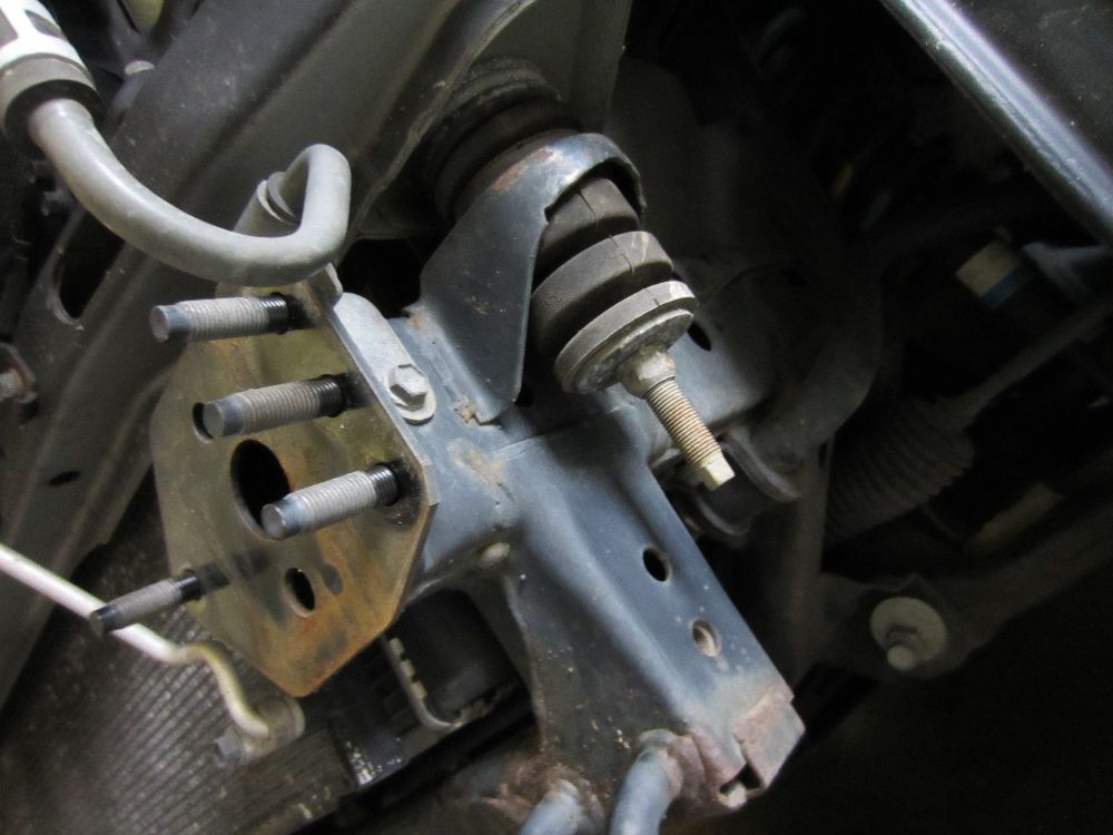

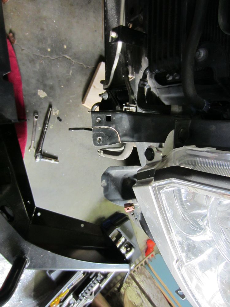

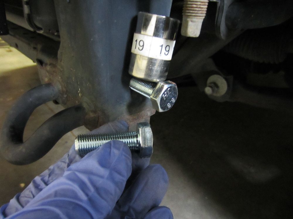

Close up of where you will be installing two bolts for side of Shrockworks brackets (driver/left side)
M12 bolt started in the driver/left side bottom side hole. 19mm required. you will likely have rust in these threads, use caution.

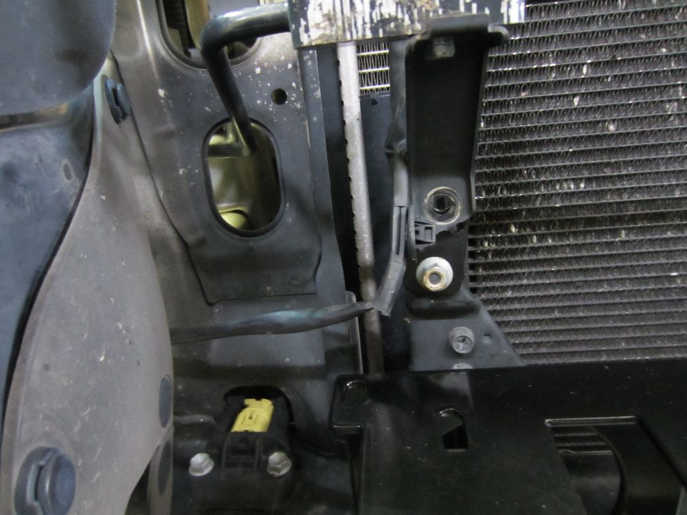

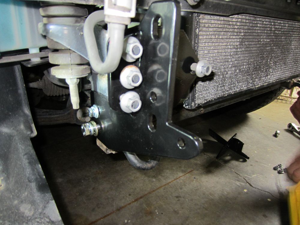

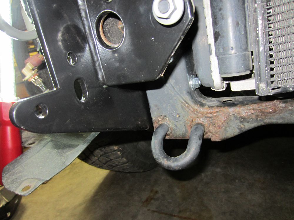

Passenger/right side bracket loosely installed. 4x14mm stock nuts, 1x19mm M12 bolt with 1/2 lock washer and 1/2" flat washer, 1x3/8" 3 1/2" long bolt with 1 lock washer, 2 flat washers, 1 nut. 14mm. LEAVE THESE LOOSE until you actually mount the bumper.
Inside view of passenger/right side. note nut and washer at bottom of radiator, just above factory recovery point.

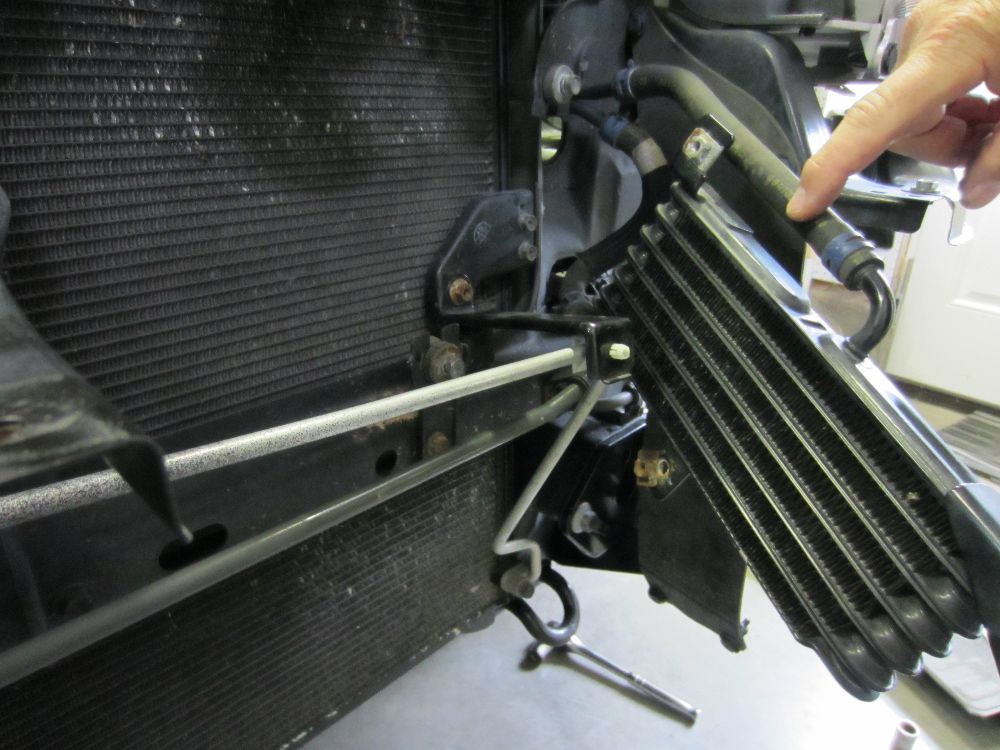

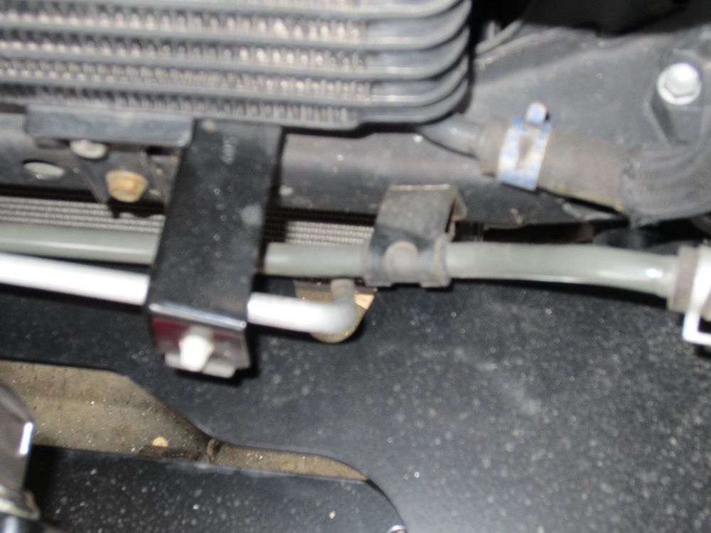

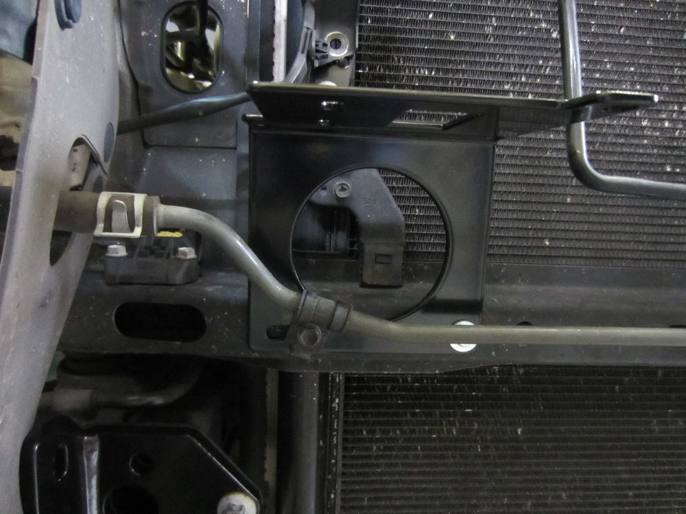

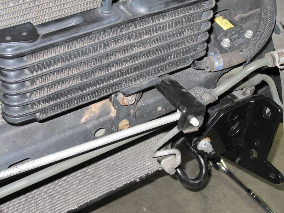

A/C line elevation bracket partially installed. I had to flex the line where it comes through the sheet metal just beside the radiator, so it wouldn't hit the top of the hold. Also note that the bracket on the driver/left side just in front of the transmission cooler was loosened before installing this bracket.
After moving the a/c line to the back of the bracket on drivers/left side. the transmission cooler was loosened and moved outward so the bracket could be unbolted and the bracket easily flipped.

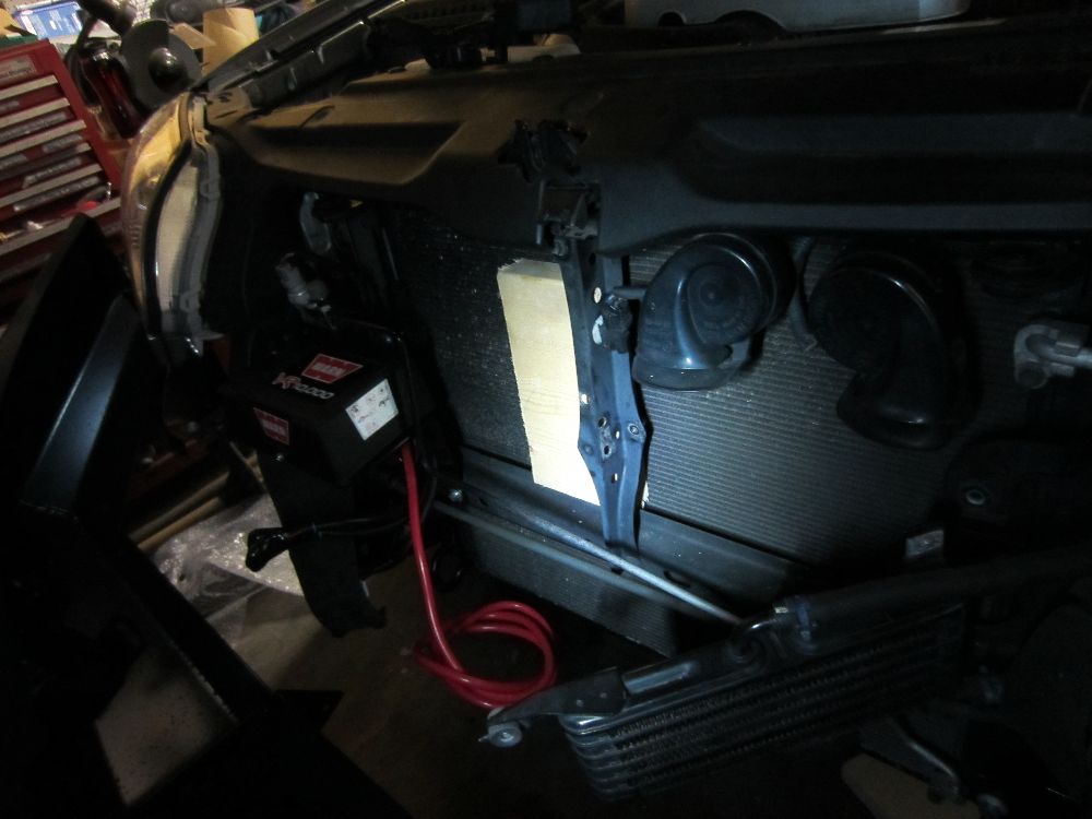

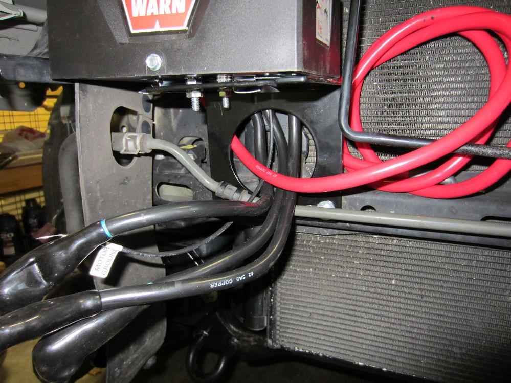

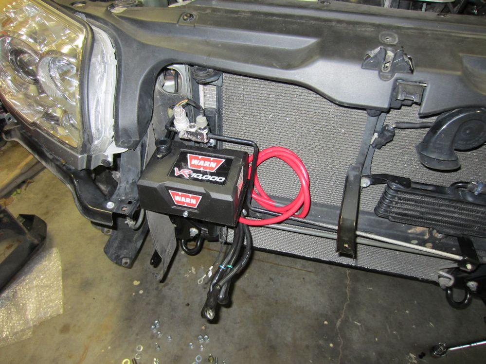

Solenoid bracket installed. i will be using a Warn winch and this fit perfectly
Transmission cooler reinstalled. The clip on the bottom bolt didn't want to stay in place and required additional attention.
Solenoid box installed.
Solenoid wiring run through hole in bracket. I will be wrapping the wires in extra loom and may be re-routing wiring at a later time.

After removing center upper bumper cover bracket. three spot welds were drilled out, so it can be reattached later if desired. The transmission cooler had to be moved out of the way again to do this. note the piece of scrap wood protecting the A/C condenser.
The brackets to mount the bumper cover mounts are hitting the bumper. Plan: cut out the outer nuts on each side. This should allow for restoration to stock if later desired. NOTE: I had to remove the metal bumper cover supports that are under the headlights. 3x10mm per bracket. The ones under the passenger headlight were very rusted on my car and I had to spin one off with a Vice-Grip. Sorry, no picture of the removal, but you can see them in the pile of parts picture at the end.
This is what happens if you don't correctly loosen the frame brackets and try to install the bumper. note the top of the bracket hitting the bumper instead of sliding in next to it.

A/C line properly routed through hole in bumper. note you may need to bend the line near the sightglass by the solenoid box area to correctly line up.

Passenger bumper bracket from inside
Passenger bumper bracket from outside

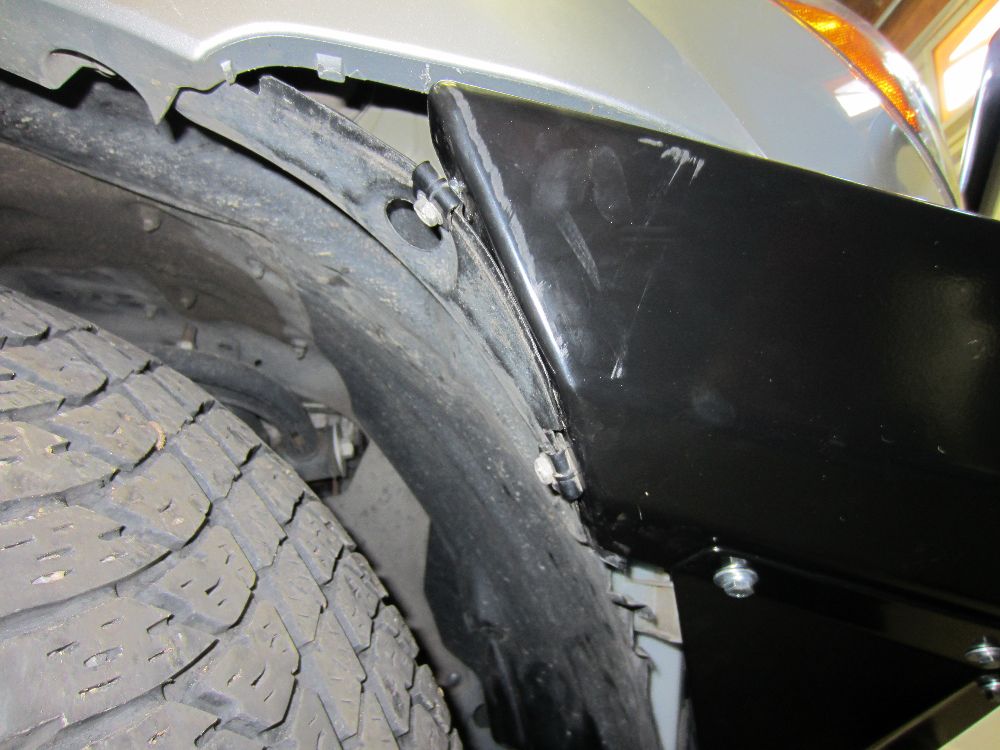

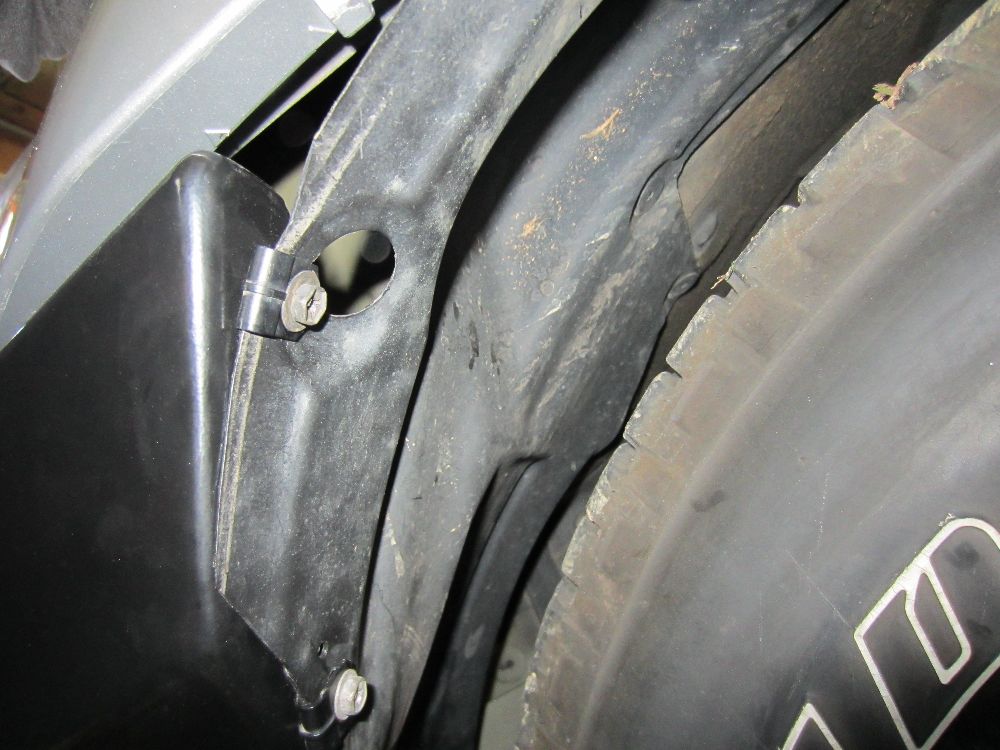

Passenger fender liner after cutting and reattaching with OEM Toyota brackets. I used a zip tie to tie the bottom of the fender liner to the washer bottle bracket. Also note the shield protecting the washer fluid bottle.
Drivers fender liner after cutting and reattaching with OEM Toyota brackets. I used a zip tie to tie the bottom of the fender liner to a bracket in the fender.

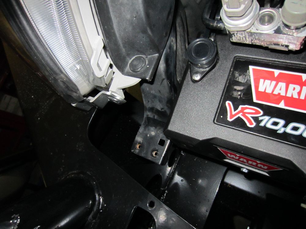

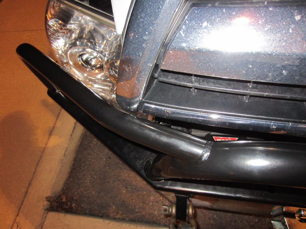

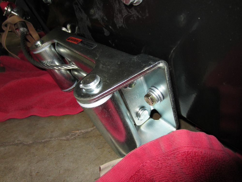

Warn winch fairlead mounted, note extra washers
Note the hood is very close to the bumper, use caution when closing

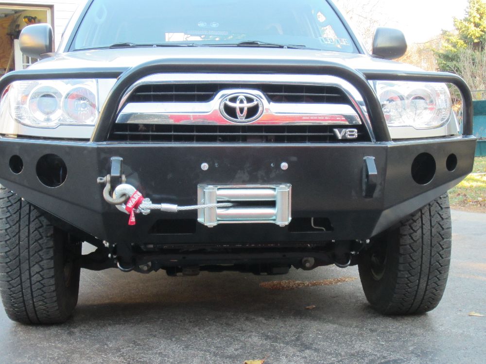

End result. still need to wire winch, purchase and install foglights, and readjust headlights. Still deciding if I want to install the duplicate turn signals.

Just a heads up not trying to be picky but bumper looks a little high on drivers side could hit H/light or fender when frame flexes.
:iagree:, :nicethread:
+1 on increasing the bumper to fender gap. Both sides, 3/4" minimum.
+1 on :nicethread: Nice write up, thanks for posting.

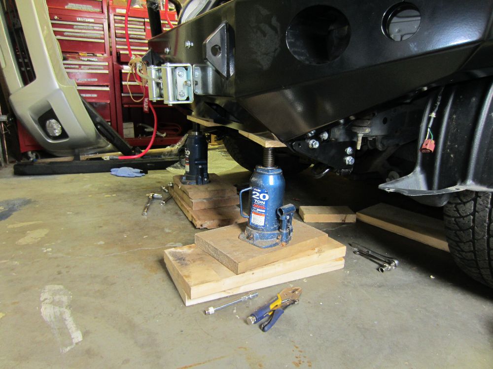

If I could add to the thread... The SW bumper can also be installed by using a floor jack with a removable saddle and a couple pieces of wood. It took me about an hour of trying to figure out a way to solo this with items I had on hand. Once set up, it took me 5 minutes to raise the bumper and line up the bolt holes. Aligning it however was a little more work and involved a lot of tightening and loosening of bolts.
Items needed:
- A sturdy floor jack with a removable saddle and at least 20" lift
- The 2 lag bolts that were used to lag the bumper to the pallet
- Flat washers in addition to the body washers that were used with the lag bolts
- lumber: 4x4x18, 1x4x18(part of the pallet)
Drill a pilot hole on one side of the 4x4 then another one on the opposite side. Offset the holes so the lag bolts don't hit each other. Remove the jack saddle and bolt the 4x4 to the jack.
P1000260.jpg~original
Lift the bumper onto the 4x4 lining up the center hole at the bottom of the bumper with the hole in the top of the 4x4. Place the 1x4 over the bottom lip of the bumper and bolt it into the top of the 4x4. The bottom lip of the bumper should now be sandwiched between the 2 pieces of wood.
P1000256.jpg~original
Now all you have to do is jack the bumper up and maneuver it into place between the frame rails. This works great for adjusting and solo removal of the bumper too.:D

I agree, the gap still needs some adjustment. Looks like there may have been undisclosed damage from before I bought the car and the bumper wouldn't drop much lower due to how the frame mount brackets lined up. :bash: Not sure how much I'll be able to get out of it.
I will be putting some more miles on the car to see how it settles out, re-torque and re-align. Won't be seeing any off-road for another week or so.
