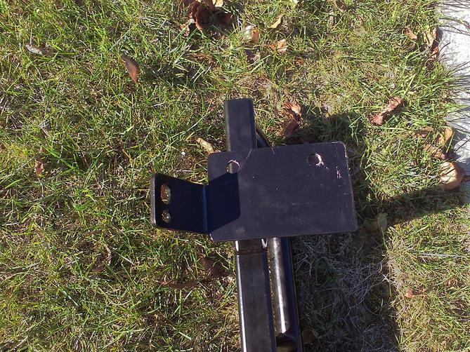

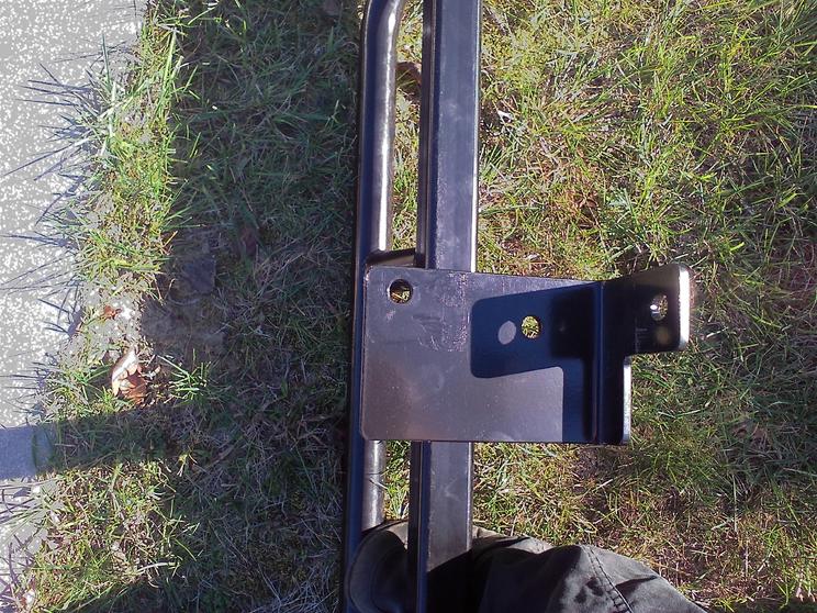

all the photos of the shrockworks sliders are installed and I can't see the bottom portion. I'm curious on the build and how it connects to the car. Anybody have photos of the bottom or uninstalled sliders?

They bolt to the frame using pre-existing threaded holes, or blind nuts on metal strips inserted through a couple holes which currently have plastic plugs. There is only one extra hole that needs to be drilled in the crossmember, and 2 years later I still haven't got round to it so I probably never will. I don't count it as a deal breaker. Sorry but I don't have pre-installation pics. It's about a 2 hour job for 2 people, and we spent 15 or 20 minutes of that figuring out where to put the blind nuts before my nephew spotted the plastic plugs. If you have KDSS the line brackets will have to be loosened and the slider brackets installed under them before reattaching.
I would recommend about a 1/2" longer bolt for the holes that use blind nuts. It would have been much easier getting them started with a longer bolt.

not at all! thank you for the pics. I am actually trying to compare the C4 to the shrockworks. It looks like the C4 sliders have more attachment points to the vehicle compared to the shrockworks. Thanks again for the bad ass photos.
