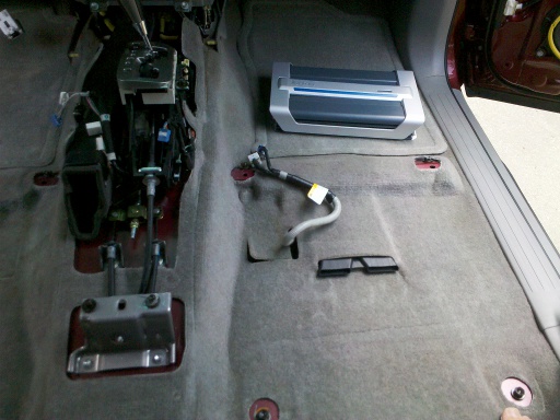

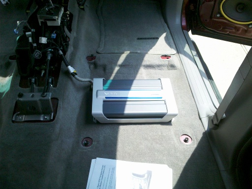

Alright, I got started but I ran into a snag.
I measured out what I had to work with under the passenger seat but I failed to notice the vent when I was picking an amp. The first picture shows where I would have put the amp. The second picture shows the vent that would be covered up.

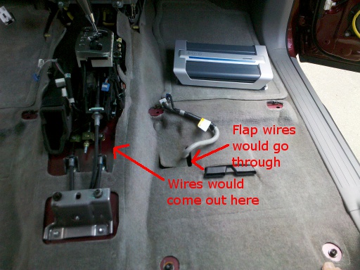

My plan was to run all the wires through the flap in the carpet (see third pic of what I mean), under the center console (why I took it out) and to the head unit. I would tie the speaker wires into the wire harness I got so I could use the factory speaker wires instead of running speaker wires all throughout the 4Runner.
I wanted to go this route because I didn't want an amp laying in the back. I think this way would look good. It is just that vent under the seat that is in the way.
I think my best option would be to return the amp to amazon and look for a smaller amp that could fit on top of the vent without blocking it. See fourth pic of what I mean.
What do you guys think?

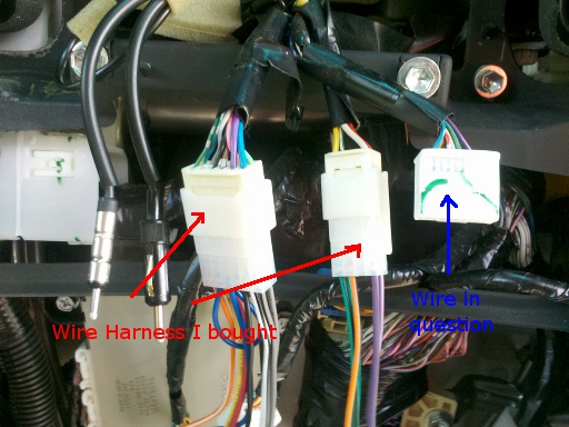

Also what is this third connection I took out from the stock head unit? See fifth pic for what I mean.

mount the amp straight up and down with the truck, and cut 2 2x2 squares out of 3/4 inch mdf and use that as legs on the bottom part of the amp that is facing the rear, this will create the clearance for the vent to blow air.
i think if u mount the amp facing left and right, the seats will barley fit i think.
Thanks for the replies. I thought about scion unit but I wanted the dvd screen.
Out of the options that I have found just by googling:
1. Simply lay the amp on top of the vent and not worry about it
2. Pull the vent out and block the air flow somehow
3. Put spacers under the amp to allow the air to pass under it like riceandpho suggested
I will go the spacer route. I'll run by home depot and see if I can get a good piece of MDF board and make something.
Yeah I realize left to right will barely clear the seat. I been thinking about it and have changed my mind on that. I will run it length wise since I will have better access to the controls on the amp. I just was worried about ppl in the back seat kicking the connections. I will just have to tell anyone seating back there to be careful.
