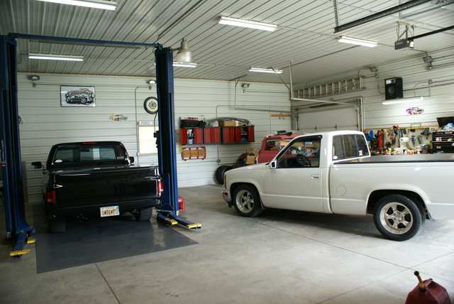

I purchased a used two-post lift for my garage, so if I don't have the right jack stands, then I use it.
Nice garage.
I have to ask though why one would use jack stands at all if there is a lift available.:behindsofa:

xcmtb83, nice garage man. What's a GMC doing in that thing? :P
You might say that I am invested in the GM products in my house. The GMC sitting in the lift area is my 84 weekend warrior (custom paint and stroker engine), the white Silverado has moved on to another person. I do however, have a newer 2011 GMC daily driver. I hit a deer earlier with the 2011 and while it was in the body shop, I got a great deal on the 97 Toyota 4 Runner. My plans were to use it in the winter weather and to take it to work daily, to deal with the crazy contract, door dinging, and "I can't drive in bad weather" construction workers that we now have at our power plant. The Toyota is going to be the beater truck. The very first day that I drove the Toyota to work, I hit another deer, so the Toy got a new front bumper to repair it. It was almost cheaper to put the ARB bumper on, than replacing the cheesy factory sheet metal bumper. There was not a lot of difference in cost, but a tremendous difference in construction quality.
As for using jack stands, Not everything goes on the lift. If it is a long term project, like the chopped and lowered 68 Chevy C-10 in the back of my garage, then the stands are used. During the winter months, my son brings his truck home to store it and that takes a lot of space and moving all of them around to do an oil change is sometimes easier to just set the truck or car on jack stands. Then there is the wife's car, that sits in the one car attached garage to the house. Sounds horrible, doesn't it?
