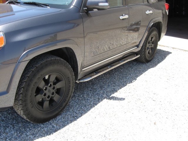

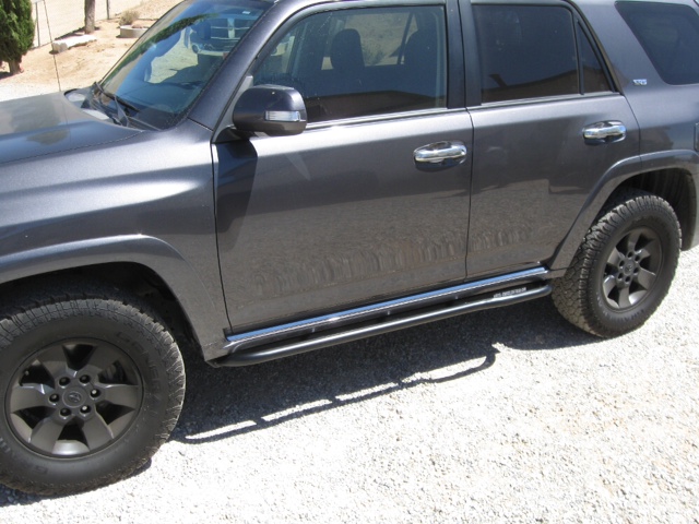

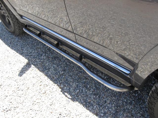

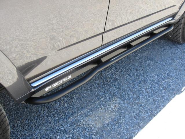

Hello All,
I was looking for sliders and a friend suggested white-knuckle off road. At the time I contacted them, they didn't have a model for the 5th gen T4R available. They contacted me after developing their model and I thought I'd advise all of you about what the sent. Note: white-knuckle neither asked me to post, nor is giving me a discount for doing so; this is just an FYI. They have a number of options; see their webpage for details. Below is what I was sent:
"I just finished making sliders for the 5th Gen 4Runner SR5 and Trail Edition. Attached are few pictures of each. The pricing will be the same as our 4th Gen 4Runner sliders. They mount to the frame with Ubolts in 3 locations on each side and require no drilling. These are built super tough! Please let me know what you think.
Thanks!
John
white-knuckleoffroad.com"

I saw your pics on another thread. From what I understand they will fit on a stock Limited/SR5 without any modification of rocker panels or Xreas suspension. Is that correct?

On the first, second, and fourth pic that OP posted, it looks like the rockers MIGHT be trimmed. It looks like they are kind of close to the rocker on the front. If the rockers are not trimmed in these pics, then do they have a different model for rigs with TE rockers, or are they just going to hang lower than SW or BB ones?
If they bolt straight to the frame, I would NOT expect them to fit on an SR5/Le without rocker removal/modification. There is also the question of gussets on the top of the bars that extend out from the frame. If there are any to reinforce the surface that the u-bolt connects to, than you will have an issue with the XREAS lines as well.
The pics don't provide enough detail to confirm/deny any fit issues on the SR5/LE.

I E-mailed John from White Knuckle as stated in another thread. His response back to me.
"Thank you for your interest in our 5th Gen 4Runner rock sliders. I will have the Limited with XREAS ready to offer in about 2 weeks. You are correct, no modifications needed. The pricing is the same as our 4th Gen 4Runner sliders which start at $520 for bare metal finish & HREW round tube with other finish and tube options available (same as 4th Gen 4Runner). The full diamond top plate is $120 and the shipping total is $110 to the US 48 states. "
