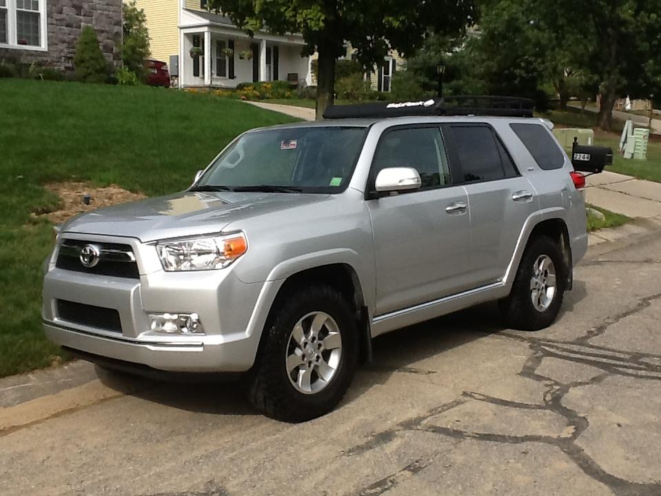

Okay.... Took off the rack, added copious amounts of silicone and new stainless steel washers. It seems BajaRack provided stainless steel bolts, but standard washers. I will give it a water test in the morning.
