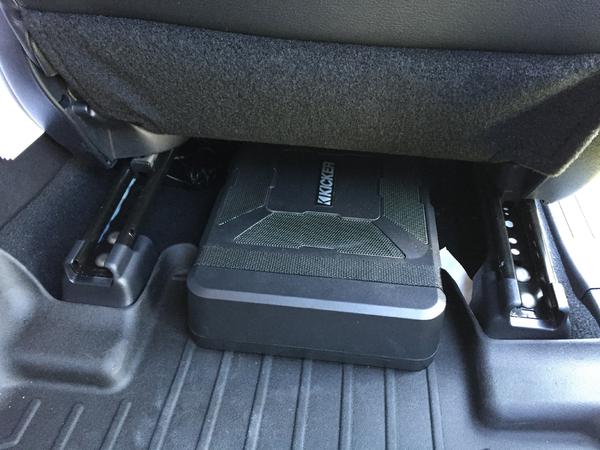

Thanks for the photos. I had not thought of mounting it in that direction. I think it is too wide to fit width-wise under the seat. Does it not interfere with the feet of back seat passengers they way you have it?
Did you anchor it to the floor? Where did you tap into the speakers?

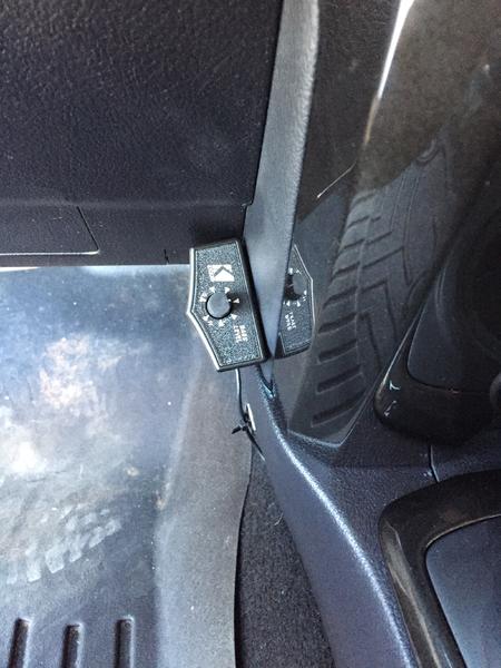

It doesnt stick out as far as it looks. A I havent heard anyone complain about it taking up too much space. I havent really secured it yet. It comes with shitty mounting straps that you have to drill holes in the floor to use it, so I got some industrial velcro to use instead. I havent applied it yet but it doesnt really slide around. Also I tapped in behind the radio and routed wire through the center console and out the carpet.

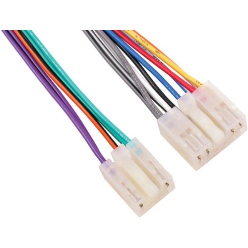

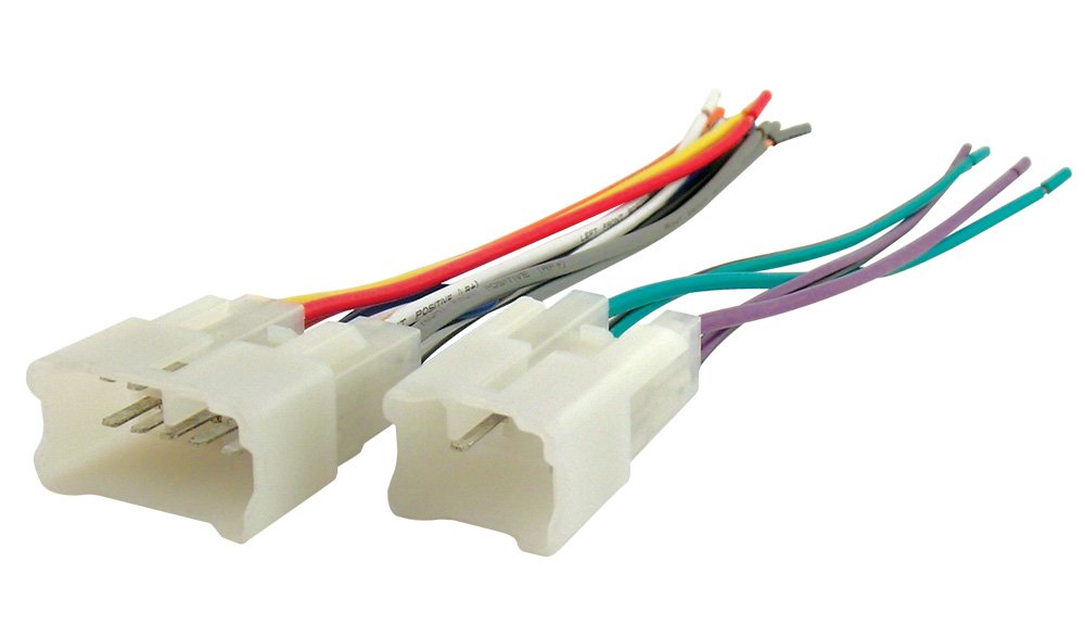

Well I finished my install. For those of you that don't want to cut into the wires, you can do like I did and purchase these harnesses to plug into your existing harnesses and just do your crimp connections there.
****DO NOT USE THE REAR ONE AS IT WILL MAKE YOUR HEAD UNIT LIGHTS STOP FUNCTIONING WHEN THE HEADLIGHTS ARE ON****

are you still using your factory headunit? are you now powering your speakers through the amp? i'm confused as to why you needed those harnesses. thanks.
Yes, I am still using the factor head unit and all stock speakers. The amplifier is built into the Kicker subwoofer and only powers the subwoofer (the power is run directly from the battery).
I suppose I didn't really NEED them, but I didn't want to cut any factory wires. So, I purchased a wire harness and a reverse wire harness so that I could plug one into the radio, and one into the wire harness that was originally plugged into the radio. Then I just made the appropriate connections with crimps to connect the two together along with adding the wiring for the Kicker.
Now, If I ever decide I want to take out the subwoofer, it is as simple as unplugging the harness contraption that I made and plugging the factory harness back into the radio.
Hope that makes sense...

It would be fine to tap into the rear speakers if you want to do cutting. What I was trying to say is that if you are going to use the harness kit, don't use the included harness for the rear speakers. Apparently there are several more pins in the factory harness that run the power for the backlight on the control buttons. If you use the rear speaker wire harness that comes in the package, your sub will work but the lights will not. I ended up just running it all of the main/power harness and it now works perfectly and is "plug and play".
Nice job!
Do you have a link or part numbers for the harnesses? I'm probably going to do this down the road.
Search on amazon for:
Scosche Reverse Wiring Harness for 1984-Up Toyota Power/4 Speaker Connector
and
Scosche Radio Wiring Harness for 1987-Up Toyota Power/4 Speaker Connector
