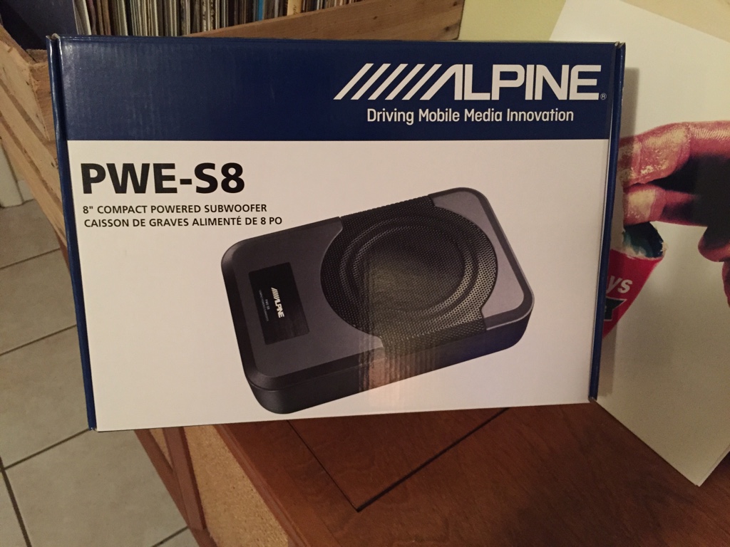

Hey guys, sorry it took so long for the response. It took me about a week to get it installed. As I said before, it fits perfectly under the passenger seat. And the sound is really nice. It fills in the bottom really well, and has a nice rich tone. It's not going to rattle your windows (as said many times before with these slim subs) but it does have a nice punch when you want it. I'd recommend it to yall if you're looking to fill the lows without losing any space whatsoever.
