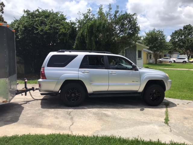

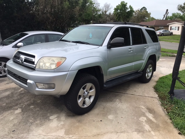

Only issue i have is, i'm pretty sure its sagging pretty bad, the front looked a little more raised than my previous runner which i found that the previous owner put cheapo autozone struts on so it raised it 1". I took some pictures to show. Trailer is a 6x12, has (3) 4 wheelers standing on their ass inside. I bought this to tow the 4 wheelers but than reading how awesome they are and being that i am in florida some off roading will definitely be possible.
Can i get away with slapping a set of the bilstein 5100 $500, on the springs currently on there or is it a little more complicated than that.
Also when I’m going over railroad tracks or a random hard bump feels like the steering pulls hard which ever direction it took the hit

also are you guys towing anything??? cause my main concern is when i load the trailer onto her, back sags a little like in the pictures, would this setup work???

The fronts are direct bolt on except for trimming that lower shock eyelet. I put aftermarket shocks in the back, didn't touch the springs as it doesn't squat at all but I don't tow anything huge. If I did I'd probably add Airlift airbags instead.
Since I plan on keeping it and most likely plan to off-road with it occasionally. I’m pretty sure I’m set with wanting the bilsteins shock wise.
But I need to figure out the springs as per my reading that’s what will really handle the sag when I load the trailer on it. Sorry haven’t had suspension work in a while and 4x4 is all new to me.
Now I have a 6x12 enclosed, almost always it will be loaded with (3) 4 wheelers that weigh about 600 lbs each standing up. Plus whatever gear I bring. From what I’ve found
Trailer 1800
Atvs 1800
So I’ll be at about 4k lbs.
I also have the regular hitch not the one that bolts to the undercarriage.
I haven’t towed yet since I’ve gotten this runner but just from reading here and their wanna make it as safe as possible.

If I were going to haul 4000 lbs often or more than a couple of times, I would get the V8 hitch, or a equivalent aftermarket hitch, I just don't think I could trust the V6 hitch just being bolted to that comparatively flimsy rear cross member compared to the V8 hitch being bolted directly to the main frame rails.

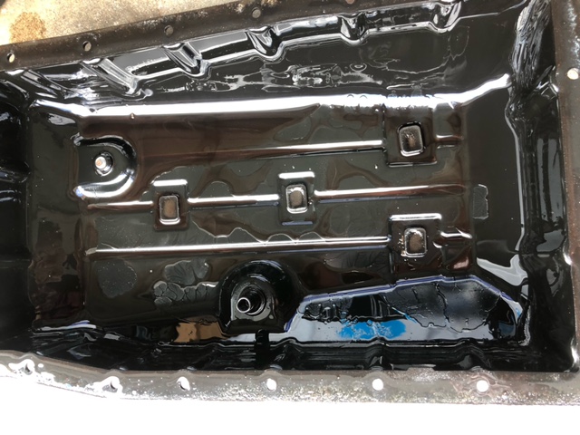

i had ordered the transmission filter a couple months ago so had to find that, but fluid came in faster than expected and the kiddos were at grandpa's so i took advantage of the time and did some apparently much needed maintenance. Fluid was a little dark, pan was pretty dirty, light sluggy grey stuff, so cleaned it all up and the magnets. changed the filter, the gasket and bolted everything back up. Happen to see a zerk and thought he why not do those as well, filled up 5 of them with some fresh grease. Went through all the gears, which noticed my lower gears are harder to shift into with the shifter, so mechanism might need to be looked at soon. Put it into 4x4 as well. and than took it for a spin, all is well.

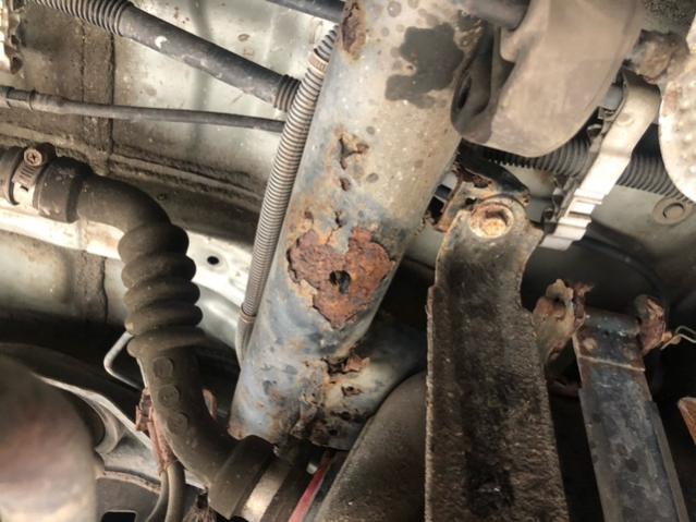

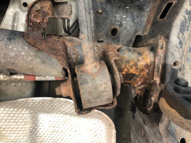

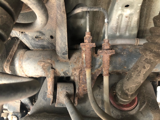

but while i had the suspension apart, will be a good time to do some rust removing and preventative as some spots need attention. that round cross bar that goes across the back of the frame on top of the axle, that holds the spring perch and the rear axle etc, i can look through one side of the hole from the rear tire and see flakes of rust through there, outside has a couple bad spots as well. i plan to wire brush everything and most likely use POR15.
i was thinking of sticking a broom stick or something to loosen all the flakes inside and than find a product with a hose that i can stick through one side come out the other, start spraying and pull it back through while spraying to cover the inside.
so maybe some tips on how you guys treated and handled the crevices and inside of the frame and with what product?? can por15 be put into a spray bottle???

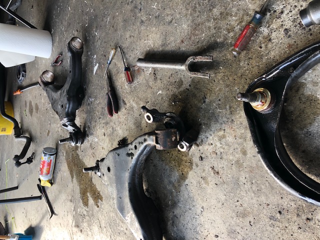

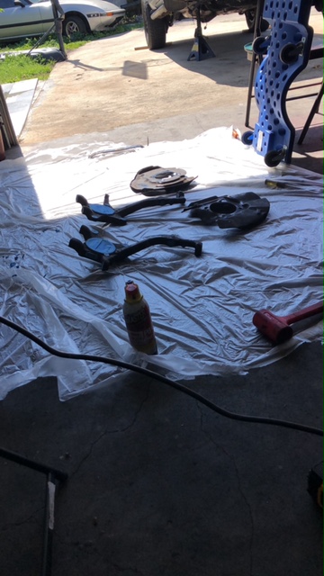

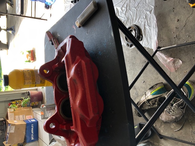

still haven't finished the front end, decided to replace a couple things while i was in there to not step on my foot later. so wheel hub/bearings and axles should be here between today and tomorrow.
i went ahead and painted the spare parts with rustoleum and while i was at it i rebuilt and painted the calipers.
painting the frame and wheel well area as well tomorrow
waiting on some bushings on friday, that i need to finish the lca and i can start assembling everything again for the front and i can start messing with the rear.
