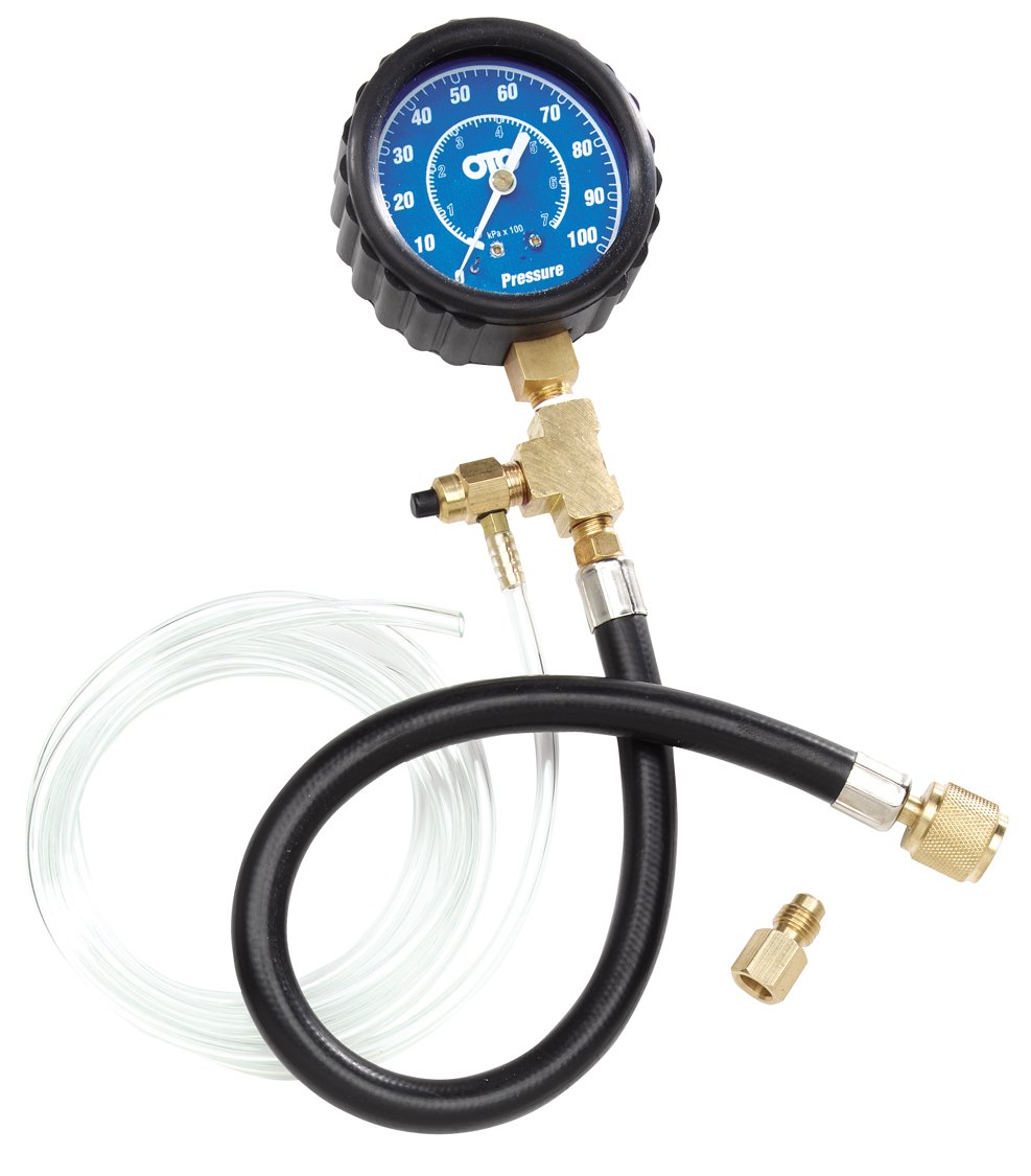

As far as I could tell, there's no way to use a fuel pressure tester, like the one in this picture, on our trucks as they don't have an access port. I believe there's some sort of SST that goes inline where the banjo fittings are, however I'm not 100% sure. Maybe someone else knows. I just didn't want the OP to waste $40 at AZ or PB for a tester that won't fit our trucks.
Edit: Here's the SST you need to test Fuel pressure.
