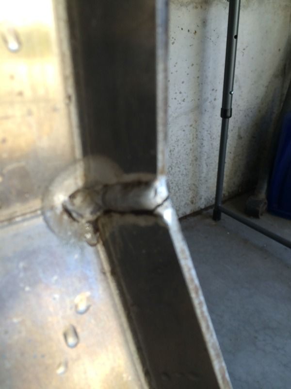

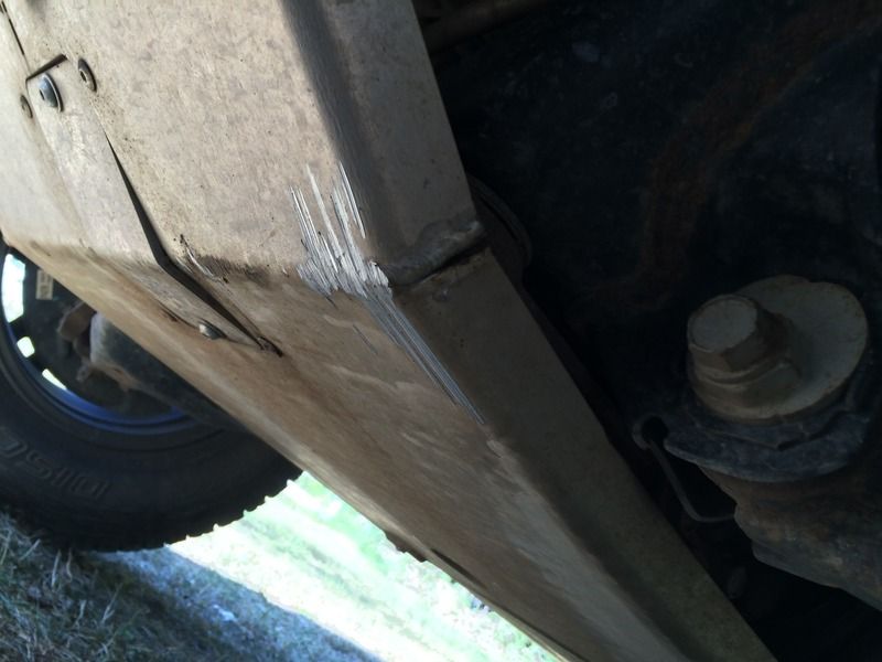

So, I never noticed when I hit the skid on Engineers Pass that I also cracked the weld on the passenger side. Noticed this today when I pulled the skid plate off.
That is also real common for aluminum. I originally had an aluminum front skid on my red truck and that same thing happened.
See of you can find a guy to TIG welded it, that looks like aluminum MIG.
I don't know if it's really worth it. The skid plate is kind of twisted (which was also causing the one noise I had) I'd have to find someone or something to try and bend the plate back into shape before having welds repaired.
ARB makes some 1/8" steel skid plates, they go from the front to the t-case, they are not all that expensive either. There is a KDSS version that is what I have on our 2012. They are still light.
A 3/16" steel BudBuilt is very strong, but also very heavy. Heavier the truck, the harder it will be to wheel. Protect it, but don't over load it either, it's a balance.
