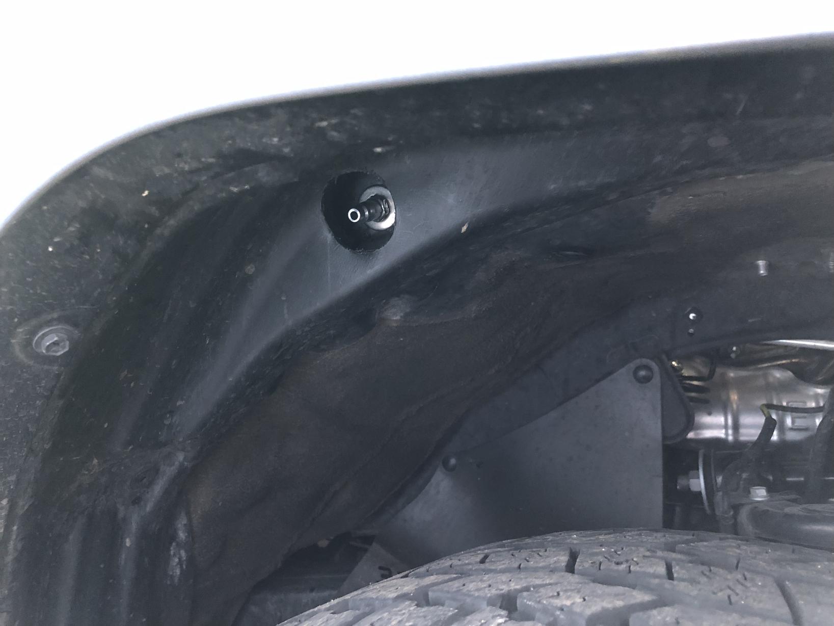

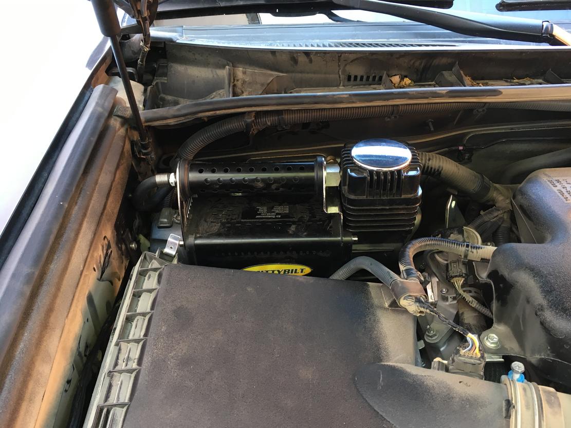

I mounted mine under the hood. It works great. I made a bracket that attached in 3 places. I used 2 existing screw holes and added a rivnut. It was still shaking around a bit so I later added an aluminum brace that attached to the top of the compressor and it’s been solid. the air connection comes out in the passenger wheel well.

That is a monster !.... :wow: Maybe I was thingin' the smittybuilt 2780 would fit and not the 2781'...
Can anyone provided actual dimensions a (see sheet below)? I ask that as the net' listed 16.1", however image Dontkicktrees' posted shows it in an area that's has only 15" total clearance and it has a little room to spare even.

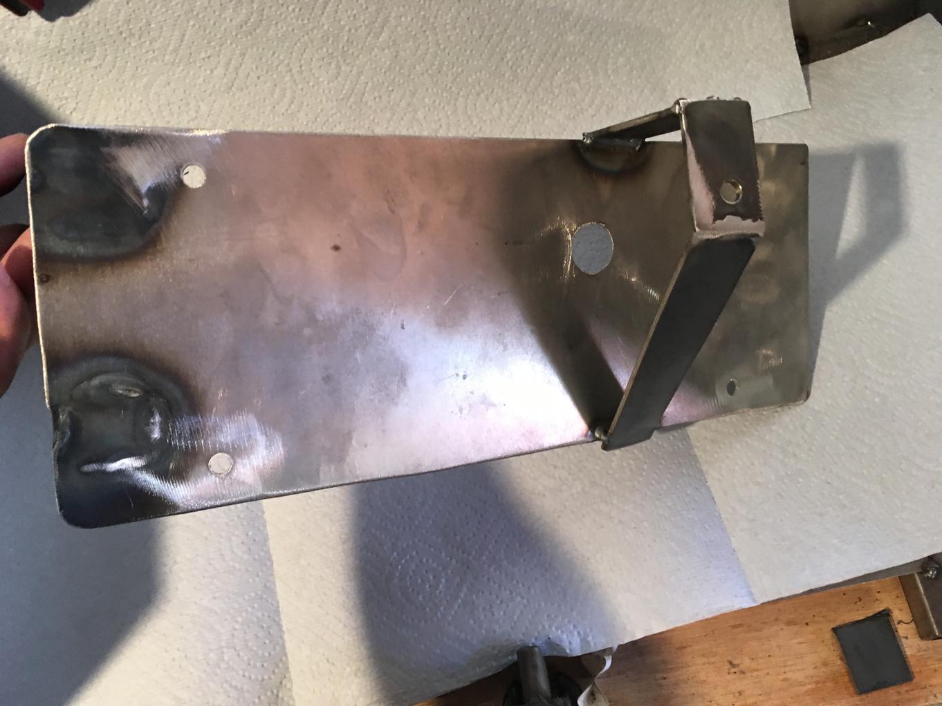

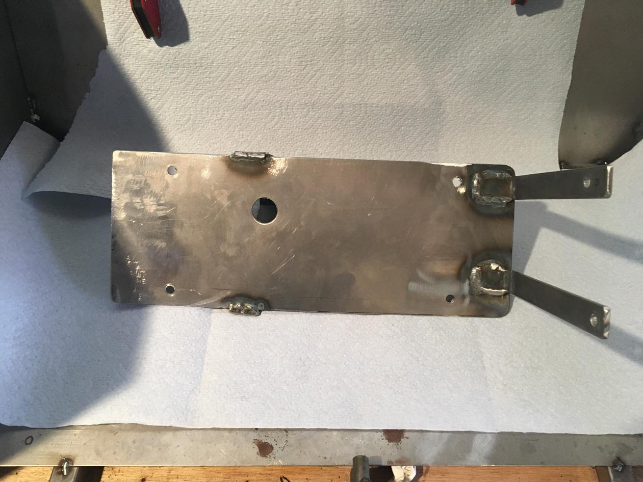

It’s the 2781. There isn’t a ton of clearance but it fits. I took the base plate off the compressor and mounted the feet to my home made tray. Sorry I don’t have better pictures. If you want another angle Let me know, I can go take some.
