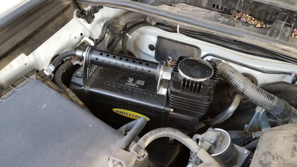

I mounted mine under the hood. It works great. I made a bracket that attached in 3 places. I used 2 existing screw holes and added a rivnut. It was still shaking around a bit so I later added an aluminum brace that attached to the top of the compressor and it’s been solid. the air connection comes out in the passenger wheel well.

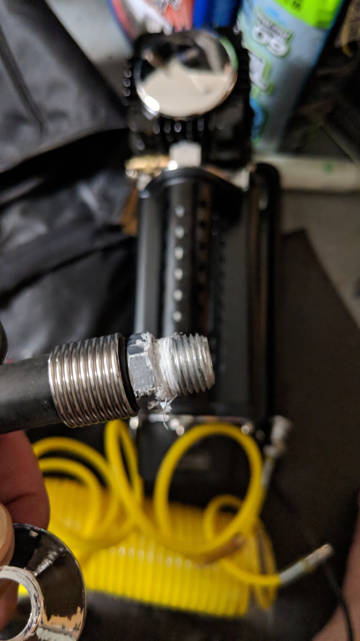

do you know what fitting/thread pitch they use for the hose that comes out of the compressor? I want to replace it with a quick disconnect but it's not the same 1/4" that you see on most compressors.
im not sure what pitch it is, but you could just cut that hose short, and use a nipple type quick disconnect on the other end.
I just use mine as is. works great. the only thing, I changed the air chuck side. I used a euro style lock on chuck, much better than that screw on thing.

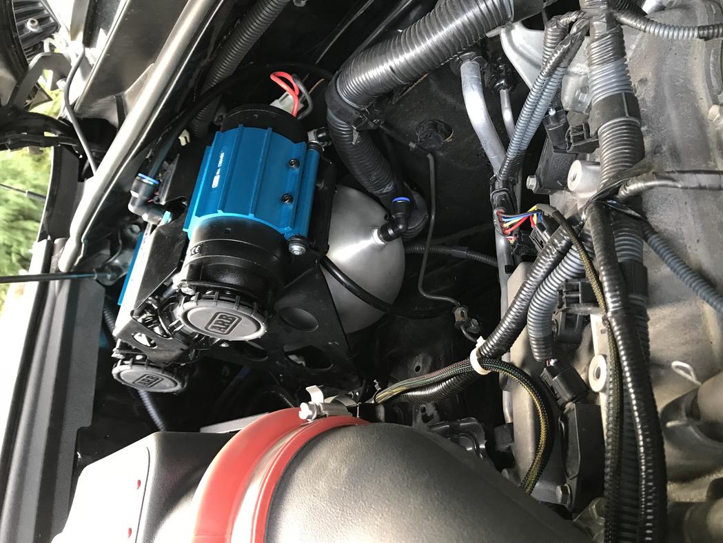

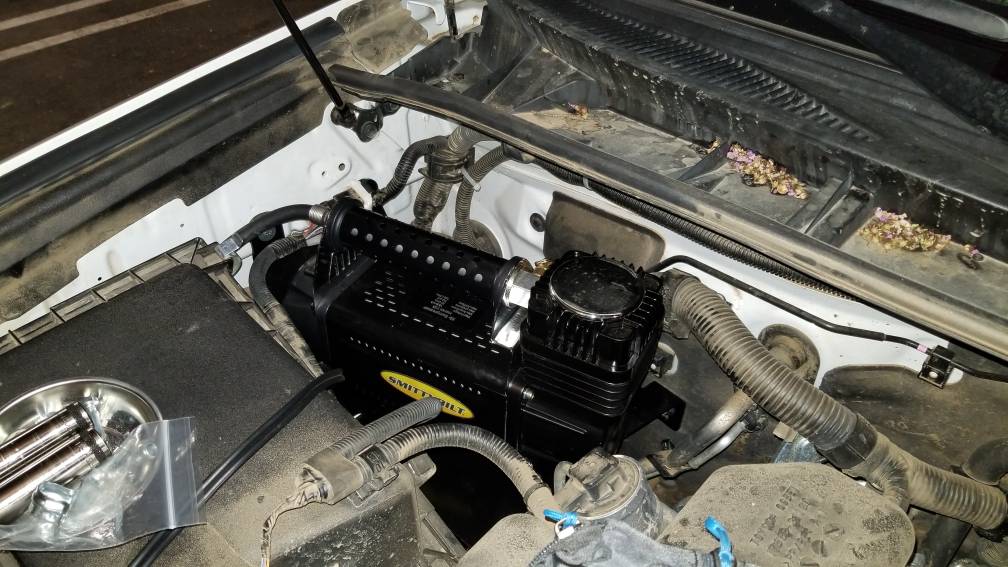

Has anyone successfully mounted a smittybilt 2781 compressor on board under your hood? Any insight would be great. If so are there any mounting brackets available? I haven’t been able to find anything on this. Thanks

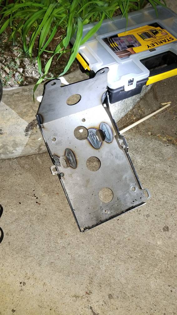

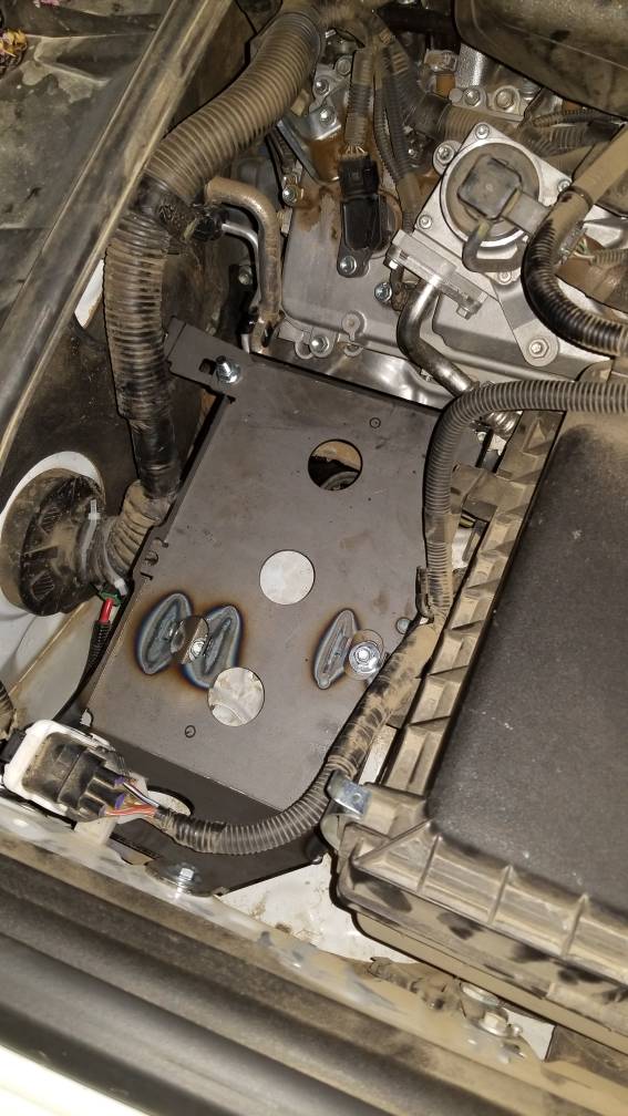

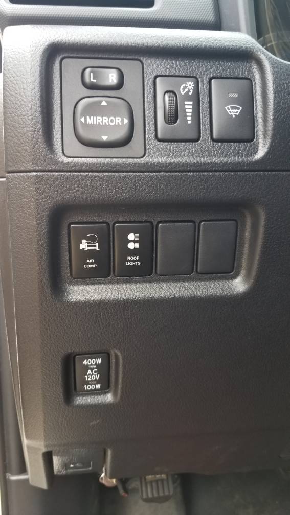

I just finished mounting my compressor tonight! I hadn't even seen this thread until now. I ordered my compressor like a week and a half ago. XD
Anyway, I used C4 Fab's battery tray and drilled some extra holes. See attached pics. It was about $125 after tax and shipping.
Hope this helps. I'm excited to finish the electrical for an in-cab switch and the plumbing. I'll post more pictures when I'm finished!
PS: I see you're in Santa Clarita, I'm in Simi Valley, so we're practically neighbors. If we're ever in close proximity maybe you can check out my setup if you still haven't done yours.
Sent from my SM-G950U1 using Tapatalk

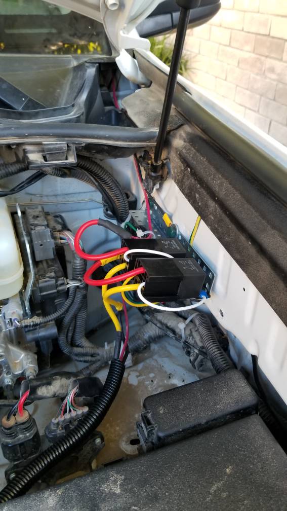

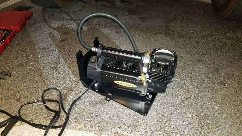

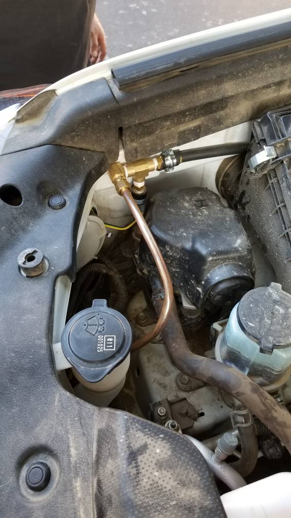

I was able to finish my install successfully!
Used a C4 Fabrication battery tray to mount the compressor in the engine bay.
All other components came from Amazon or Home Depot, wiring/plumbing parts/copper line/etc.
Buttons came from aironboard.com.

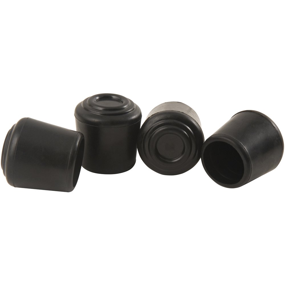

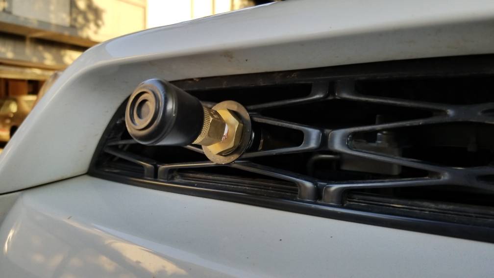

I'm using a furniture leg rubber foot to cover the quick detach and keep out dust and water.
Nicely done! Man I love having the compressor on board. Makes everything so easy. Just make sure you have the engine on when you run it. I forgot one time and blew my fuse. Actually, that reminds me: if you haven’t already, wire in a 40 amp fuse between the battery and compressor. That way if you make a dumb mistake like me you don’t have to pull out the compressor to change the on board fuse.

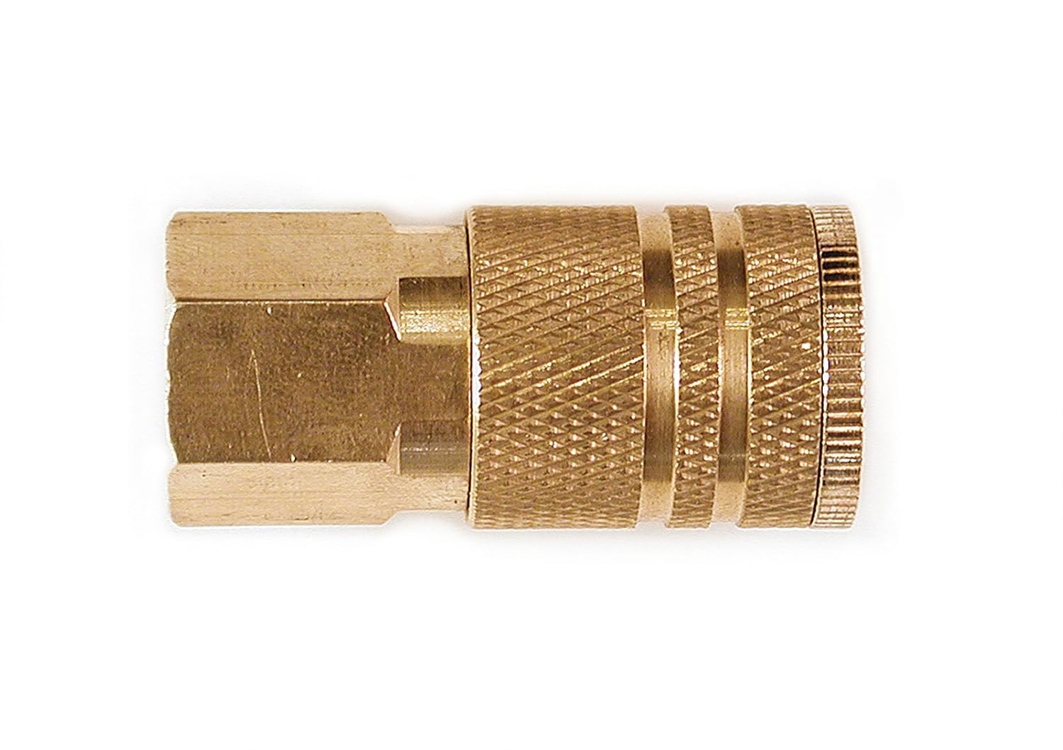

Have you considered covering the wheel well connection? I use brass connections with rubber caps designed for a walker. Usually by the walker caps at Wal-Mart.
I have a little bag of rubber bolt caps that press on over the air connection to keep mud and stuff out. I always forget to take them off before I fire up the compressor and they shoot off in to the wilderness, or if I’m lucky shoot one of my friends in the leg. The brass connection with walker cap is a good idea. I might try that out.

When I was researching solutions on mounting my 2781 I found this thread. I used LT Ambrose 26's idea of using C4 Fabs mounting tray, but did it a little differently and wrote up a guide on how to do it since it was not clear in his post. So far it has been working very well.
I typed up a full guide on how to do this yourself.
That is a monster !.... :wow: Maybe I was thingin' the smittybuilt 2780 would fit and not the 2781'...
Can anyone provided actual dimensions a (see sheet below)? I ask that as the net' listed 16.1", however image Dontkicktrees' posted shows it in an area that's has only 15" total clearance and it has a little room to spare even.
