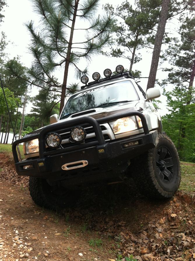

Hello everyone, it has been forever since I have been on the forms and I am now going to become more active. I have done a little research on a snorkel for my 2000 sr5 sport. I wanted t get everyone's opinion on what all of you think is the best one. so if you would please post links along with comments that you have. I will be installing the snorkel myself, thanks!

that ebay snorkel looks like the one John (jmt 2404) had on his runner. the place he got his no longer sells that snorkel so i cant help there. but his was a little different design than the ARB/Safari Snorkel
