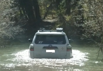

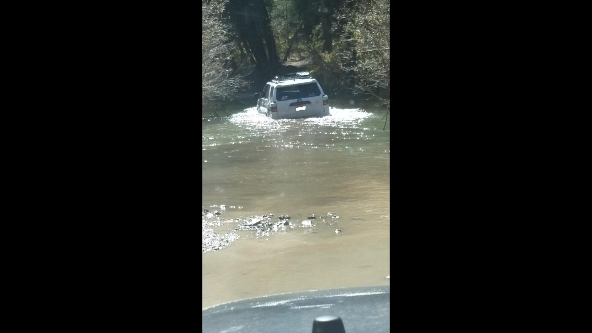

Actually I lied, I re-measured and it was 27 inches deep. So that was enough to jack up my starter. I believe a 4runner is supposed to be waterproof up to 36 inches. Apparently that doesn't include the starter as others have had the same problem. Maybe the wake added a few inches.
4Runner does not have a published spec; the FJ Cruiser does and it is 26" with stock tires/suspension.
